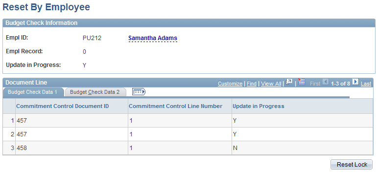

Reset by Employee Page
Use the Reset by Employee page (HP_RESET_LOCK_JOB) to review locks placed by real-time budget checking for job data changes, and reset the locks if necessary.
Navigation:
Set Up HCM, and then Product Related, and then Commitment Accounting, and then Reset Encumbrance Locks , and then Reset by Employee, and then Reset by Employee
This example illustrates the fields and controls on the Reset By Employee page: Budget Check Data 1 tab.
This example illustrates the fields and controls on the Reset By Employee page: Budget Check Data 2 tab.

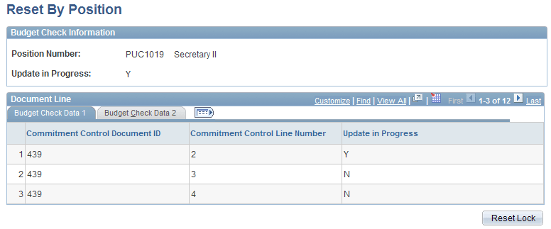

Reset by Position Page
Use the Reset by Position page (HP_RESET_LOCK_POS) to review locks placed by real-time budget checking for position data changes, and reset the locks if necessary.
Navigation:
Set Up HCM, and then Product Related, and then Commitment Accounting, and then Reset Encumbrance Locks , and then Reset by Position, and then Reset by Position
This example illustrates the fields and controls on the Reset By Position page: Budget Check Data 1 tab.
This example illustrates the fields and controls on the Reset By Position page: Budget Check Data 2 tab.

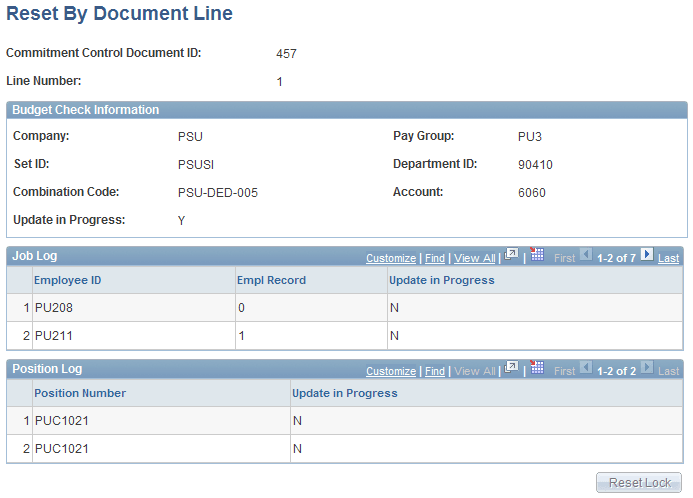

Reset By Document Line Page
Use the Reset By Document Line page (HP_RESET_LOCK_DOC) to review locks placed by real-time budget checking and reset the locks if necessary.
Navigation:
Set Up HCM, and then Product Related, and then Commitment Accounting, and then Reset Encumbrance Locks , and then Reset by Document Line, and then Reset by Document Line
This example illustrates the fields and controls on the Reset By Document Line page.

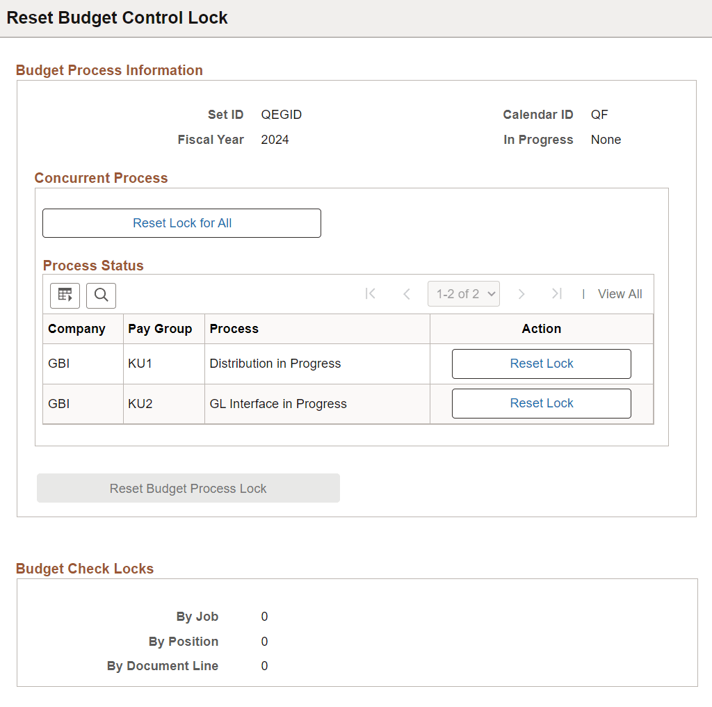

Reset Budget Control Lock Page
Use the Reset Budget Control Lock page (HP_RESET_LOCK_BCH) to review locks placed by running budget or liquidation processes, and reset the locks if necessary.
Navigation:
Set Up HCM, and then Product Related, and then Commitment Accounting, and then Reset Encumbrance Locks , and then Reset Budget Control Lock, and then Reset Budget Control Lock
This example illustrates the fields and controls on the Reset Budget Control Lock page.
Field or Control Description
In Progress
Displays, if applicable, the budget process that is currently running, for example, Actuals Distribution, Encumbrance Calculation, Fiscal Year End Encumbrance Cleanup, and so on.
If no process is currently running, or the lock of the current process is reset (by selecting the Reset Budget Process Lock button), None is displayed.
Select to remove the lock of the running process that is displayed on the In Progress field, and update that field value to None.
This button becomes active when a running process appears in the In Progress field.
Concurrent Process
The Concurrent Process section displays budget concurrent processes (with corresponding company and pay group) that are currently running in the system, if the Enable Concurrent Process option is enabled on the PeopleSoft Payroll for North America: Payroll for NA Installation Page.
If the Enable Concurrent Process option is cleared, or if the option is selected but there are no concurrent processes running at the time, the No Concurrent process running message is displayed.
Reset Lock for All
Select to reset the locks of all company and pay group entries in the Process Status section and update the Process field values to None.
Process
Displays the budget process that is currently running for the associated company and pay group, if available. Values include:
Distribution in Progress
GL Interface in Progress
None
Reset Lock
Select to remove the lock of the corresponding process and update the Process field value to None.
Budget Check Locks
This section displays the number of locks that are currently placed by real-time budget checking, grouped by job, by position, and by document line.
