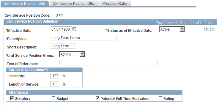

Civil Service Position Def. Page
Use the Civil Service Position Def. (civil service position definition) page (FPMLEGALSTA_PNL1) to add or change a civil service position.
Navigation:
Set Up HCM, and then Product Related, and then Workforce Administration, and then Workforce Data FPS, and then Civil Service Positions, and then Civil Service Position Def.
This example illustrates the fields and controls on the Civil Service Position Def. page. You can find definitions for the fields and controls later on this page.
Field or Control Description
Civil Service Position Group
Select the civil service position group that corresponds to the official civil service position.
Text of Reference
Enter the text that is associated with the position.
Career Advancement %
Seniority and Length of Service
Enter the percentages that are used to calculate seniority and length of service.
Attendance
Statutory, Budget, Potential Full-Time Equivalent, and Rating
Select the check boxes that apply to the civil service position. Indicate whether the position is considered budget headcount, statutory headcount, or potential full-time equivalent, or if the position should be considered in attendance time calculations for rating.

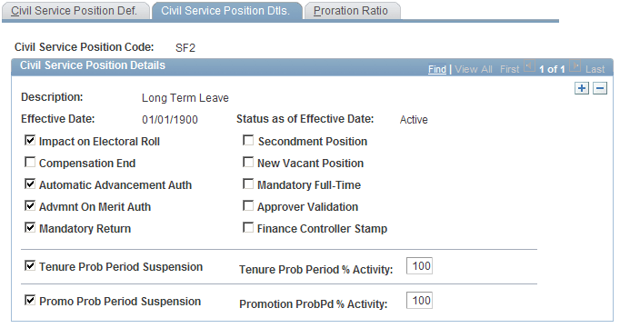

Civil Service Position Dtls. Page
Use the Civil Service Position Dtls. (civil service position details) page (FPMLEGALSTA_PNL2) to enter civil service position details.
Navigation:
Set Up HCM, and then Product Related, and then Workforce Administration, and then Workforce Data FPS, and then Civil Service Positions, and then Civil Service Position Dtls.
This example illustrates the fields and controls on the Civil Service Position Dtls. page. You can find definitions for the fields and controls later on this page.
Impact on Electoral Roll
Select if the position does not authorize participation in elections. Informational only.
Compensation End
Select if the position suspends employee compensation. Informational only.
Automatic Advancement Auth (automatic advancement authorization)
Select if the position authorizes automatic advancement.
If the employee's position does not authorize automatic advancement, the advancement date is postponed until the end of the position. The Manage French Public Sector business process calculates the seniority that the employee can carry over after advancement.
Advmnt on Merit Auth (advancement on merit authorization)
Select if the position authorizes advancement on merit.
Mandatory Return
Select if the first action taken after terminating the position is regarded as a return action.
Secondment Position
Select if the civil service position leads to a secondment position.
New Vacant Position
Select if the position is vacant. You can vacate a position in the Assignment data. If this check box is selected, it means that an employee with this civil service position does not occupy his position (POSITION_NBR).
Note: Civil service position is different from position (POSITION_NBR).
Mandatory Full-Time
Select to indicate that this civil service position is not authorized for a part-time employee.
Approver Validation
For leave-type or termination-type positions, select if the civil service position change needs validation. The system uses this functionality only for CAE (commitment accounting entity) control.
See Understanding Budgetary Headcount.
Finance Controller Stamp
For leave-type or termination-type positions, select if the position change needs a stamp. This field is for informational purposes only and is valid only when CAE control is active.
Tenure Prob Period Suspension (tenure probation period suspension) and Tenure Prob Period % Activity (tenure probation period percent activity)
Select to suspend the tenure probation period. When you suspend the tenure probation period, the tenure date is postponed taking into account the time the employee spent in this civil service position. Only 0 and 100% values for probation period percent activity are considered.
Promo Prob Period Suspension (promotion probation period suspension) and Promotion ProbPd % Activity (promotion probation period percent activity)
Select to suspend the promotion probation period. Only 0 and 100% values for probation period percent activity are considered.
