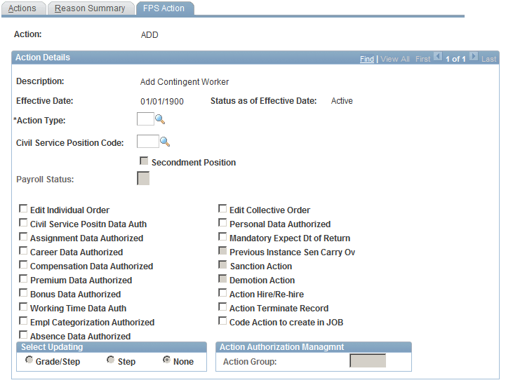

FPS Action Page
Use the FPS Action page (FPMACTION_PNL2) to specify the FPS components that can use an action.
Navigation:
Set Up HCM, and then Product Related, and then Workforce Administration, and then Actions, and then FPS Action
This example illustrates the fields and controls on the FPS Action page. You can find definitions for the fields and controls later on this page.
FPS Action page
Field or Control Description
Description, Effective Date, Status as of Effective Date
Displays the values defined on the Action page.
Action Type
Select the action type for the action. Action types group related actions.
Civil Service Position Code
Select a code if the action implies a civil service position change.
Secondment Position
Indicates whether the civil service position is a secondment position, based on the information entered on the Civil Service Position Dtls. page for the code.
Payroll Status
Select the payroll status (EMPL_STATUS) of the employee depending on the employee's civil service position. Available statuses are:
  • Active.
  • Deceased.
  • Leave of Absence.
  • Leave With Pay.
  • Retired With Pay.
  • Retired.
  • Suspended.
  • Terminated.
  • Terminated With Pay.
  • Terminated Pension Pay Out.
  • Short Work Break.
  • Retired – Pension Administration.
Note: The Payroll Status field becomes available when a Civil Service Position Code is entered.
Note: The payroll status value is included in the job data update during the merge process.
See Understanding the Merge Process.
Edit Individual Order and Edit Collective Order
Select to edit reports for the action. Up to five reports per status and action can be defined on the Documents/Employee Status page.
See Documents/Employee Status Page.
Civil Service Positn Data Auth (civil service position data authorization), Assignment Data Authorized, Career Data Authorized, Compensation Data Authorized, Premium Data Authorized, Bonus Data Authorized, Working Time Data Auth. (working time data authorized), EE Categorization Authorized (employee categorization authorized), Absence Data Authorized, and Personal Data Authorized
Select each type of employee data that is affected by the action. By selecting and deselecting these check boxes, you restrict the action codes that are available in each FPS component.
Mandatory Expect Dt of Return (mandatory expected date of return)
Select if an expected return date is required. This is used for some interruption actions.
Previous Instance Sen Carry Ov (previous instance seniority management carryover)
Select to have the action carry over Previous Instance Seniority on a same step. Available only if you select Career Data Authorized.
Sanction Action, Demotion Action, Action Hire/Rehire, and Action Terminate Record
Select if this type of action is available for the selected action displayed at the top of the page.
Sanction Action and Demotion Action are available only if you select Career Data Authorized. If you select Sanction Action or Demotion Action, the action becomes available in the Freeze Advancement/Demotion FPS component (Workforce Administration, and then Job Information)
If you select Action Hire/Rehire , the action becomes available in the hiring components (Workforce Administration, and then Personal Information, and then Organizational Relationships, and then Initialize Status FPS and Workforce Administration, and then Job Information, and then French Public Sector Jobs, and then Employee Record FPS).
Code Action to Create in JOB
This check box is not implemented for the current process and you must modify the system to make use of it.
If implemented, this check box enables you to limit the job action data in French Public Sector that is merged into the JOB table during the merge process. Select Code Action to Create in JOB to create a new data row in the JOB table during the merge process for the action displayed at the top of the page.
Note: When implemented, the Code Action to Create in JOB option enables you to record events (actions) in the FPS components that are ignored by the merge process (these actions/events would not appear in Job Data).
Note: The merge process is described elsewhere in this PeopleBook.
Grade/Step, Step, and None
Select the option that indicates what the action enables you to modify. Available only if you select Career Data Authorized.
Action Group
Enter the action group to which you want to assign the action. Use these action groups to grant data permission security according to user role. This field is available only if you have selected Action Authorization Management in the FPS Installation component.
Note: Action groups are created on the Action Groups page.
See FPS Installation Parameters 1 Page.

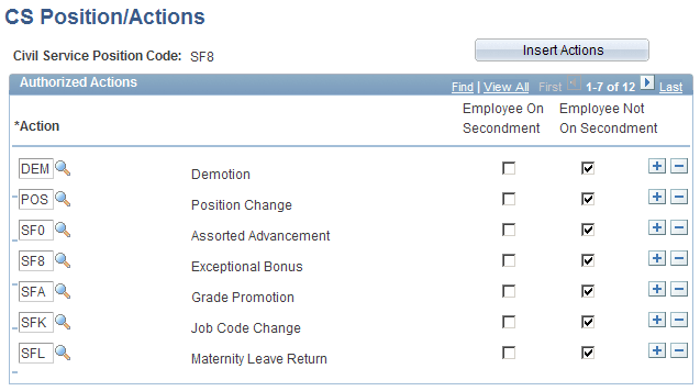

CS Position/Actions Page
Access the CS Position/Actions page (Set Up HCM, and then Product Related, and then Workforce Administration, and then Workforce Data FPS, and then CS Position/Actions, and then CS Position/Actions).
This example illustrates the fields and controls on the CS Position/Actions page. You can find definitions for the fields and controls later on this page.
An action is authorized only if the impacted employee has a specific civil service position.
To associate actions with civil service positions:
  1. Enter a Civil Service position code.
  2. Click Insert Actions to list all existing actions.
  3. Add or delete actions using the Add and Delete buttons.
  4. Indicate whether the action is available to employees on secondment using the Employee on Secondment check box.
    Some actions can be performed only in the employee's home organization.
