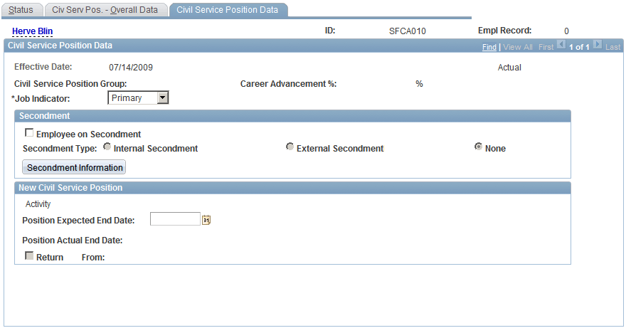

Use the Civil Service Position Data page (FPAEELEGAL_PNL2H) to enter civil service position data.
Navigation:
Workforce Administration, and then Personal Information, and then Organizational Relationships, and then Initialize Status FPS, and then Civil Service Position Data
This example illustrates the fields and controls on the Civil Service Position Data page. You can find definitions for the fields and controls later on this page.
To enter civil service position data:
  1. Select the job indicator.
    This determines if the record is Primary or Secondary.
  2. In the Secondment group box, indicate if the employee is on secondment.
    Only External Secondment is available for employee record number (Empl Rcd#) 0.
  3. Click Secondment Information to enter detailed secondment information.
  4. If you know it, enter the expected end date of the position.
    The end date is not mandatory for the hiring action. It can be mandatory for break type actions, such as leaves. To make this field mandatory for an action code, select the Mandatory Expect Dt of Return check box on the FPS Action page.
The system displays the New Civil Service Position data that is associated with the Hire action.
