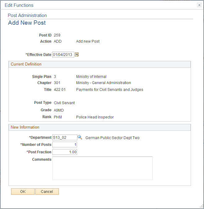

Post Administration - Add New Post Page
GPS_POSTADDFUNC
Add new posts to post plan rows.

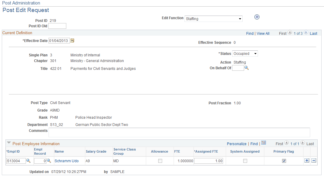

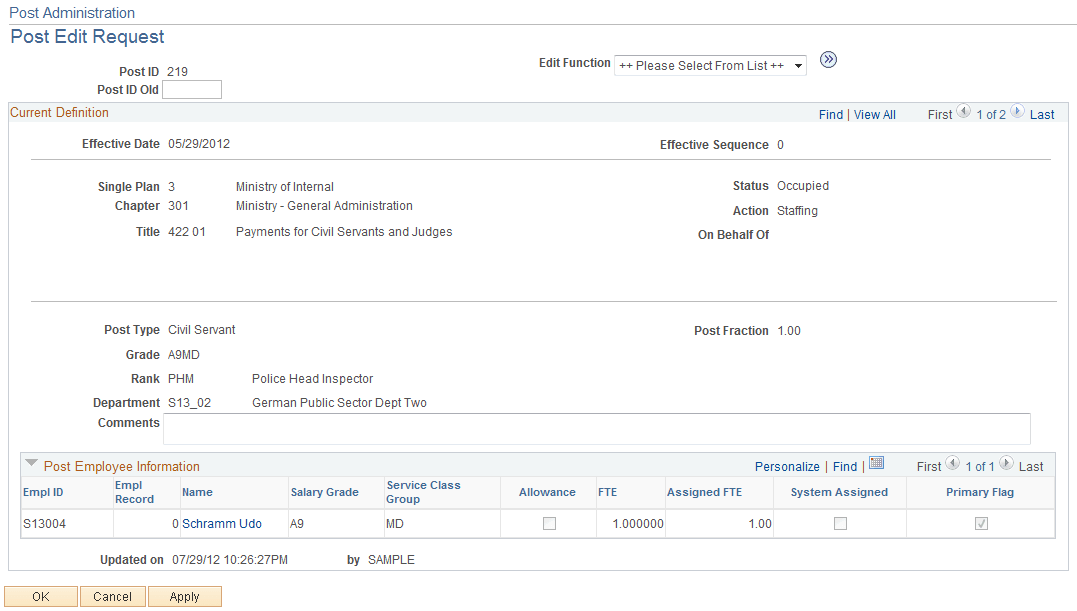

Post Administration - Post Edit Request Page
GPS_POSTEDIT_REQ
Select actions to perform on posts.
Post Administration - Post Edit Request Page (Staffing Posts Manually)
GPS_POSTEDIT_REQ
Staff posts manually.

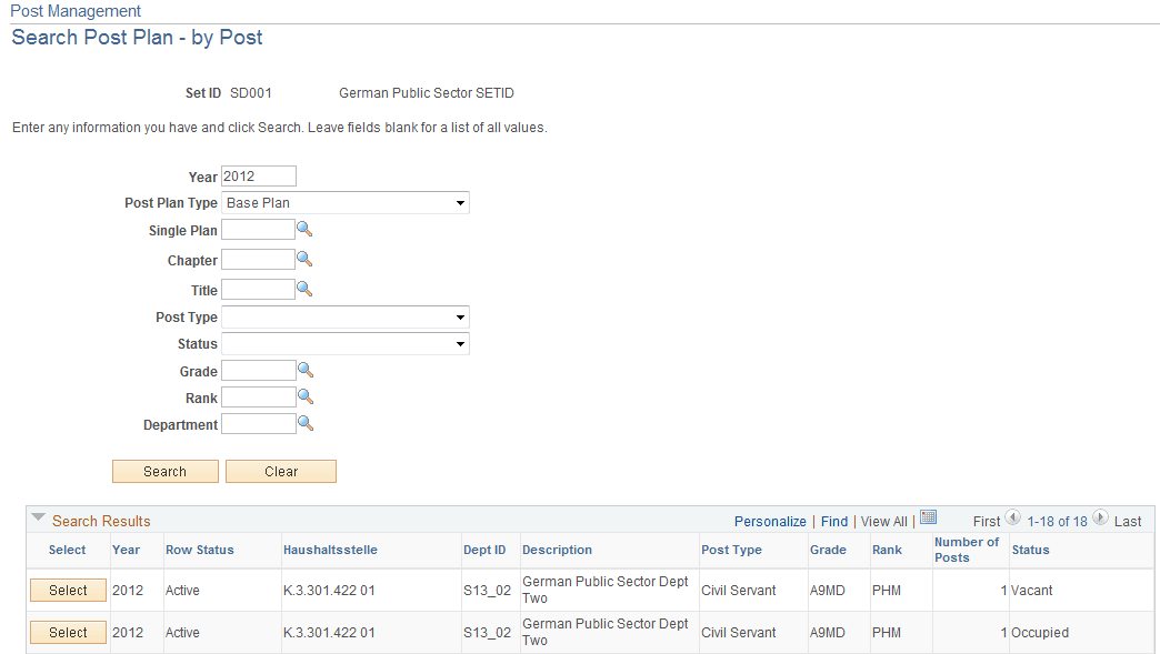

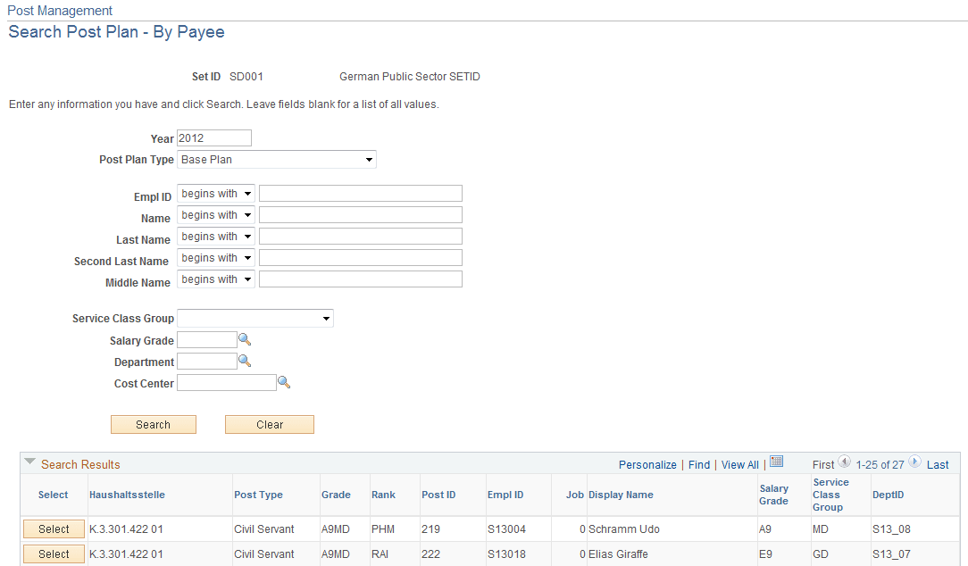

Post Management - Search Post Plan - by Post Page or Post Management - Search Post Plan - By Payee Page
Use the Post Management - Search Post Plan - by Post page or Post Management - Search Post Plan - By Payee page (GPS_VT_SEARCH) to enter search information to find post plan by post, or by payee with assignment in an active post plan.
Navigation:
  • Workforce Administration, and then Post Management DEU, and then Administer Plan - By Payee
  • Workforce Administration, and then Post Management DEU, and then Administer Plan - By Post
This example illustrates the fields and controls on the Post Management - Search Post Plan - By Payee page.
This example illustrates the fields and controls on the Post Management - Search Post Plan - by Post page.
The system supports the search of post plans (active, closed, or in cleanup phase) by post or by payee and payee assignments. Search fields are slightly different.

Edit Function
Select an edit function to perform in the post administration phase and click the run button adjacent to the field to transfer to the appropriate page.
Edit functions that are post plan row-specific are available for selection on this main page. Values are:
Add new Post
Create New Post Plan Row
Note: For edit functions that are specific to posts, or possibly their current associations with post plan rows, they are available for selection on the Post Administration - Post Edit Request page. More discussions of these edit functions are available in this documentation.

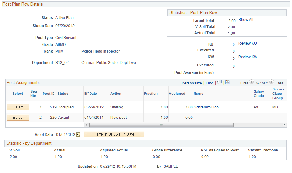

Statistics - Post Plan Row
This section displays statistical information for the entire post plan row. If the current post plan row has only one department, the result is the same as the one by department. If the post plan row is associated with multiple departments, results will be different between the two sections.
Field or Control Description
Target Total
Displays the planned number of posts coming from the post plan. This number does not include posts that are added or removed in the administration phase.
V-Soll Total or V-Soll
Displays the calculated number of posts currently available in administration.
Actual Total or Actual
Displays the number of posts that have payee assignment (regardless of the fraction assigned). If a post has more than one payee assigned to it, it is still counted just as 1.
Adjusted Actual Total or Adjusted Actual
Sum of all post fractions that have payee assignment. For example, if there are 2 posts and the assigned FTE values are 0.5 and 1 respectively, the adjusted actual total is 1.5.
Grade Difference Total or Grade Difference
Number of posts (times fraction) with assignment of payee who doesn’t have a matching grade as the post.
PSE assigned to Post Total or PSE assigned to Post
Number of posts (times fraction) with assignment of payee who is in a different post type. This refers to the situation where a payee is a public sector employee and is assigned to a civil servant post.
Vacant Fractions Total or Vacant Fractions
Sum of all post fractions that are not occupied.
This number excludes permanently blocked or otherwise terminated posts.
KU and KW
Display the numbers of KUs and KWs that are active, as well as those that were processed past or on the cutoff date.
KU Executed and KW Executed
Display the counts all KUs and KWs that are processed past or on the cutoff date.
The KU Executed (KW Executed) number is a subset of the KU (KW) number.
Post Assignments
This section displays all posts that are associated with the current post plan row and the basic information of each post, for example, post ID, post status, effective date, the last action performed on the post, and post fraction. If the post is assigned to a payee, basic information and assignment details for the payee are also available, for example, grade, service class group, payee’s FTE, and FTE assigned to the post. For more job-related information about the payee, click the name link to access the Job Summary page.
Has Future Date
Displays as selected if the post has a future effective date. The information is not available here but can be viewed by clicking the Select button.
Statistic – by Department
This section displays statistical information by department. If the post plan row has only one department, values shown here are identical to the values displayed in the Statistic – Post Plan Row section.
If there are multiple departments associated to the post plan row, the numbers are split by department accordingly.
Refresh Grid As Of Date
Click to refresh the Post Assignments section as of the date specified.

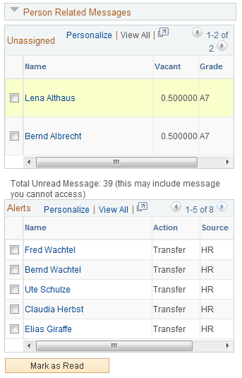

Person Related Messages
This section acts as a message center where information pertaining to the plan’s current phase is presented. For example, if the plan is in the cleanup phase, the message center displays plan details that administrators need to react upon as part of the cleanup. Similarly, when the plan is in its administration phase, it displays information that assists administrators in doing their tasks, such as a list of unassigned payees to be considered for staffing posts based on the organizational instance (cost center) post type, grade and rank, as well as alerts.
Unassigned
This section lists payees who have unassigned FTEs that can be used to staff partially occupied or vacant posts of the current post plan row. The list of payees that administrator personnel can see is based on the permission given to the administrator. The system provides two ways for administrators to staff posts:
  1. Process the Staffing function and manually select payees and associated FTEs to be assigned to post on the Post Administration - Post Edit Request page.
  2. Select payees for a post they want to staff in this section, and then click the Select button of that post in the Post Assignment section.
Both methods can be used to staff posts that are in any of these statuses: New, Reserved, Vacant, and Occupied (with vacant fractions). For posts that are in temporarily or permanently blocked status, only unstaffing is possible (staffing is not allowed) and it should be performed using the first option. When the second option is used, the system automatically populates the payee information to the Post Administration - Post Edit Request page, where Staffing is automatically selected as the action and the status is changed to Occupied.
If the total number of unassigned payees is greater than 100, the system displays a message, which suggests that the administrator runs the automatic post assignment process instead of staffing posts manually.

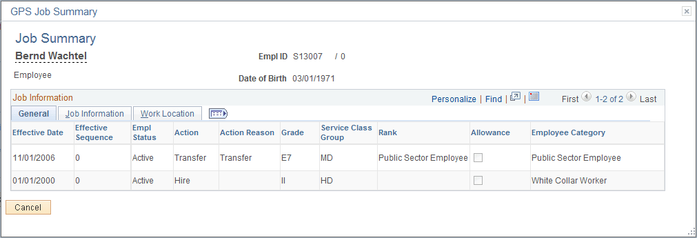

Name
Click the link to view the payee’s job summary on the Job Summary page.
Vacant
Displays the payee’s vacant FTE based on the date that is specified in the As of Date field on the page.
The as of date can be, but is not necessarily the current date. If a payee is assigned to fill a post in the future, entering the current date as the as of date and refreshing the post assignment information based on the as of date, the payee (with the future assignment) is still listed in this section. However, if the effective date of the future assignment is specified as the as of date, the payee will no longer be listed in this section when the post assignment information is refreshed.
Alerts
This section lists the HR job data changes for payees that administrators may find useful when doing their tasks. Some HR operations have an impact on post management, and knowing what these are helps administrators react to them in a timely manner.
For payees whom the administrator has no permission to access, the system displays a message that shows the number of messages that the administrator cannot view due to permission restriction.
Access the Post Management – Manage HR and Payroll Messages page o view HR and Payroll messages in details.
Name
Clicking the name link in either the Unassigned or Alerts section takes administrators to the Job Summary page where payee’s job details are displayed.
Source
Displays either Payroll or HR as the source of the message.
Mark as Read
Click to remove messages that are selected from the Alerts section.

There are three types of messages that are specific to the cleanup phase:
Outgoing
Displays all proposed changes (actions, number of posts and fraction of posts impacted) for the current post plan row. When the administrator chooses a proposed action from here and an appropriate number of posts (on which the action is performed) from the Post Assignments section, clicking the Execute button automatically processes the selected action on the selected posts.
If, instead of selecting a proposed change from the Outgoing section, the administrator processes the exact same proposed change using the regular method, which is selecting a post and processing the action on the Post Administration - Post Edit Request page, the system recalculates the number of impacted posts for each post successfully decremented, incremented, reclassified, relocated, and cut.
Results of the actions that are processed here are the same as if they were performed on the Post Administration - Post Edit Request page. In other words, for the Cut action, the post is terminated. For the Increment or Decrement action, the post is moved to another post plan row. For reclassification, the system updates the post’s last level of budget center, post type, grade and rank. And for relocation, the post’s budget center and department are changed. Prior to processing these actions, the system checks if the posts selected have payee assignments. If yes, staffing will be canceled as part of the process.
Any proposed change row will be removed from this section when its number of impacted posts reaches zero.
Pending Incoming
Displays additions that maybe coming to this instance (post plan row) based on suggested changes that are made in other post plan rows. This section provides the administrator an estimate on the number of posts that may be added to the current post plan row after the plan was processed.
Changes after Cut-Off Date
Displays all the post leaving changes from cut-off date to the end of last year (for 2-year plans, the changes include leave changes for the past two years). The administrator needs this information to decide whether or not to adjust the amount of suggested actions.
See Also Post Management – Manage HR and Payroll Messages Page

On the Post Management - Administrate Plan page, only one post plan row is displayed at any given time. Use the navigation tree on the right side of the page to navigate among post plan rows, which are grouped by department and then post type.
Use the Post Administration - Add New Post page (GPS_POSTADDFUNC) to add new posts to post plan rows.
Navigation:
Select Add new Post in the Edit Function field on the Post Management – Administrate Plan page.
This example illustrates the fields and controls on the Post Administration - Add New Post page.
Use this page to add new posts to the current post plan row. Because the post is added during the administration phase, administrators can only add posts in types that are applicable to the administration phase.
Enter department, number of posts, post fraction and comment (optional) to create the new post.
Newly added posts appear in the Reserved status in the Post Assignments section of the Post Management – Administrate Plan page.
Calculations for Adding Posts
When a new post is added, the system recalculates these values (increase by the number of post times post fraction entered in new post), which are shown in the Statistic – by Department section:
  • V-Soll
  • Vacant
Use the Post Administration - Post Edit Request page (GPS_POSTEDIT_REQ) to select actions to perform on posts.
Navigation:
Click the Select button of the post that needs updates in the Post Administration - Administrate Plan page.
This example illustrates the fields and controls on the Post Administration - Post Edit Request page.
Edit Function
Select an action to perform on the post.
The list of available actions is determined by the current post status.
Current Definition
This section displays information of the associated post plan and post plan row for reference.
Post Employee Information
The section displays, information of payees that are assigned to the post, if available.
Use the Post Administration - Post Edit Request page (GPS_POSTEDIT_REQ) to staff posts manually.
Navigation:
Select Staffing in the Edit Function field on the Post Administration - Post Edit Request page to assign payees to a post.
This example illustrates the fields and controls on the Post Administration – Post Edit Request page (edit function: Staffing).
Post Administration - Post Edit Request page (edit function: Staffing)
This function is available for posts that are in these statuses:
  • New
  • Reserved
  • Vacant
  • Occupied
  • Final Blocked (available only when post is not entirely vacant) – only unstaffing (the removal of existing staffing) is available
  • Temporarily Blocked – only unstaffing is available
  • If the effective date is after the planned end date, staffing (both add and remove) is allowed; if the effective date is before the planned end date, only unstaffing can be performed.
When the Staffing function is processed, these fields and section become available for edits:
Status
Select a new status for the post if needed, for example, administrators can reserve posts or make them vacant (by removing all payees from the post) using the Staffing function.
Note: This field is not editable to posts that are in temporarily or permanently blocked status.
When a payee is assigned to a post, the post status is changed from New or Vacant to Occupied. In the case of a Reserved post, its status remains the same after a payee is assigned to it.
If a post plan row has a KU or KW associated to it, and one of its posts is saved with a Vacant status, the system displays a message stating that saving a vacant post can trigger the processing of KU or KW. Administrators can choose to let the processing begin or abort the save operation.
On Behalf Of
Select an approver if applicable.
Enter one or more payees to fill the corresponding post and the FTE assigned to it.
In addition to assigning people to posts, administrators can use the Staffing function to modify the employee information of an occupied or partially occupied post (for example, update employee or the assigned FTE, or remove employee assignment), reserve a post or cancel assignment of a permanently blocked post.
The Staffing function supports the cancellation of all occupied fractions in posts that are being blocked temporarily or permanently. When a blocked post is unstaffed entirely, no staffing is allowed during the time the post is blocked. To do so, select a post that is permanently or temporarily blocked and has a payee assigned to it (staffing is not available to blocked posts that do not have current payee assignment). Run the Staffing function and remove the assignment.
Like other edit functions, staffing actions can be reset as long as no other actions had taken place.
Generally, when the administrator selects to reset an action, the system reverts the change by deleting the last effective dated row that was inserted to the database (by any edit function). For edit functions (for example, Increment, Decrement, Relocate, Reclassify) that insert two rows (one for the source and one for the target), the last two effective dated or effective sequence rows are deleted.
Empl ID (employee ID)
Enter the employee ID of the payee to be assigned to the corresponding post.
The system refines the list of available payees based on a set of rules. A payee is available for selection if he or she satisfies all these conditions:
  • Accessible by the administrator (security permission).
  • Is active and current (with an effective date that is earlier than the effective date of the post)
  • Is associated with the same cost center as the post.
  • Payee’s HR grade, service class group, and allowance setting must match an entry defined for the current setID (setID of post) in the Post Management – Post Grade Table page.
  • Payee’s person grade is equal to or lower than the post grade AND the payee’s person type is equal to the post person type. Or, payee with mapping grade (for example, the post type is civil servant and person type is employee, the mapping employee grade, which is defined in the Post Grade Mapping Table page, is displayed)
  • Has a non-zero vacant FTE.
Payees do not have to have matching grade, civil service rank, service class group, and department as the post in order to be eligible for assignment.
The same filter criteria are used when the system populates the Unassigned section in the message center, with an additional requirement on service class group. Payees who meet all the requirements listed in the bulleted list, have a matching service class group as the post plan row, and have a grade that is equal to or greater than the post plan row’s grade will be listed in the Unassigned section.
Empl Record (employee record)
If the employee is associated with multiple jobs, select the employee record number to specify which one to use.
Assigned FTE
Displays the payee’s FTE fraction to be assigned to this post.
For example, a post has a post fraction of 1. When a payee with a vacant FTE of 0.75 is assigned to this post, the system shows 0.75 as the payee’s assigned FTE. If the administrator adds another payee to the post and this payee’s vacant FTE is 0.5, the system performs a calculation and shows 0.25 (1- 0.75), which is the additional FTE that is needed to staff the post entirely. The second payee still has a vacant FTE of 0.25 that can be used to fill another post. Payees with their remaining vacant fractions will be shown in the list of unassigned payees on the Message Center.
System Assigned
Displays as selected if the payee is assigned to the post through the automatic post assignment AE process.
Primary Flag
Select if this is the payee’s primary post. The system selects it automatically if this is the first post of the selected payee. The field value is used in the Workforce Statistics report to identify the post plan to which a payee’s primary assignment belongs. It can be manually updated by administrators.
A warning message is displayed to ask that the field value be updated if:
  • The post is the assigned payee’s first and only assignment and the primary flag is changed to not being selected.
  • The post is not the assigned payee’s first assignment, the primary flag is selected. The effective dates of this post and the first post are not the same.
  • If the effective dates of this post and the first post are the same, the system displays an error message. For post management, it is assumed that a payee can only have one primary post in any given effective date.

Post Administration – Reserve Page
Use the Post Administration – Reserve page (GPS_POSTEDIT_SEC) to reserve posts.
Navigation:
Select Reserve in the Edit Function field on the Post Administration - Post Edit Request page.
This example illustrates the fields and controls on the Post Administration – Reserve page.
The function is available to posts that are in Vacant status or posts that contain vacant fractions. When a post is in Reserved status, the only available edit functions are Reserve, Staffing and Reset.
During the cleanup phase, posts that are reserved and have payee assignments are copied over to the target year with the Occupied status by the Prepare Cleanup AE program.
If the administrator selects the Reserve function on a post that is currently being reserved, the Cancel Reservation field is displayed as selected on the Cancel Reservation page that appears and clicking the OK button on the page lifts the reserve condition off the post.

Job Summary Page
Use the Job Summary page (GPS_JOB_SUMMARY) to view payee’s job summary.
Navigation:
Click the name link in the message center on the Post Management - Administrate Plan or Post Management - Cleanup page.
This example illustrates the fields and controls on the Job Summary page.
Job Summary page
Use this page to review payee’s job information, which helps administrators make informed decisions when they assign posts to payees.
