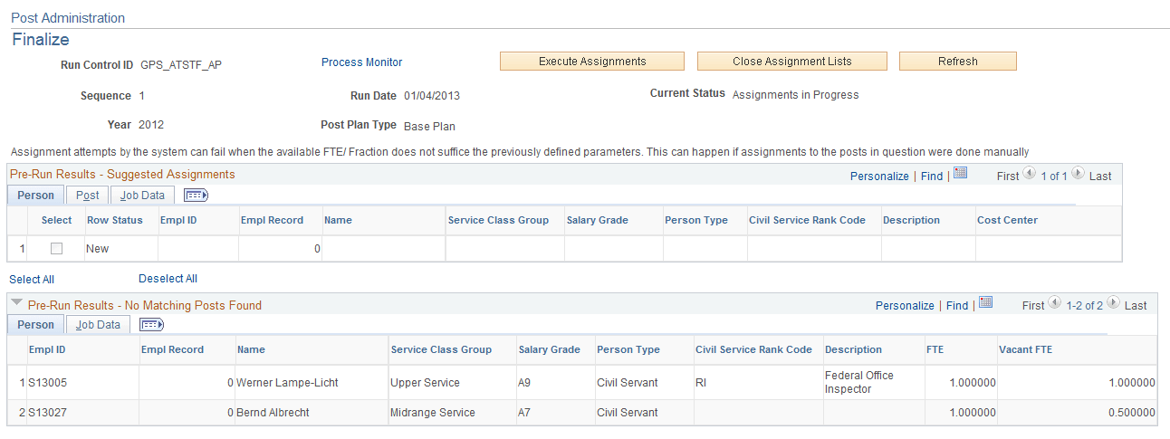

Post Administration - Finalize Page
GPS_ATSTF_RSLT
Finalize the post assignment suggested by the custom process.

The post staff process (GPS_ATSTF) assigns posts to unassigned payees. It takes posts that are in these statuses: New, Vacant, Occupied (Partial Occupied), and Reserved (if configured) and matches them with payees who are unassigned to posts.
The post staffing process can be run in two modes: mass and custom.
  • The mass process is a simple process that attempts to assign posts to all unassigned payees in the system.
  • The custom process allows administrators to select a group of unassigned payees for whom post assignment is performed. Administrators enter a list of search criteria for unassigned payees, and, from the search result that returns, selects one or more payees for whom automatic post assignment will be performed. Administrators can specify staffing options to be used in the post staff process, for example, assign payees posts with the highest possible grade, specify the number of assigned posts allowed for each payee, include reserved posts to be assigned to payees, and allow public sector employees to staff civil service posts. The custom process includes two AE processes – one to return the search result of unassigned payees for post assignment and the other to copy user applied result to database tables.
When a match between a post and a payee is identified, the process performs the assignment automatically. For the mass process, a post-payee match is found if:
  • Post’s cost center = Payee’s cost center
  • Post’s Department ID = Payee’s Department ID
  • Post’s Grade, Service Class Group, Rank = Payee’s HR Grade, Service Class Group, Rank
  • Post has no payee assignment and it is in either New or Vacant status (the mass process does not process reserved posts), and payee has no post assignment
  • Vacant post fraction matches payee’s vacant FTE
As for the custom process, the match rules are slightly different, specifically:
  • Post grade and payee grade don’t have to be the same. A post can be filled by a payee of the same or lower grade. Also, mapping grade can be accepted if public sector employees can be assigned to civil servant posts.
  • Payee’s FTE can be shared by multiple posts, and a post can be assigned to multiple payees based on post fraction and payees’ FTEs. For example, if the system has one vacant post (post fraction = 1) and two payees (vacant FTE = 0.5 each), the custom process assigns these payees to the post if other matching rules are satisfied. Similarly, if the system has two posts (vacant fraction = 0.5 each) and one payee (vacant FTE = 1) available, the custom process assigns these posts to the payee (the maximum number of post assignments for each payee is configurable).
  • Payees and posts that are partially assigned or occupied can potentially get new assignments as a result of running the custom process.

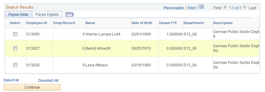

Post Administration – Search Unassigned Payees Page
Use the Post Administration – Search Unassigned Payees page (GPS_ATSTF_SEARCH) to select a group of unassigned payees to be included in the custom post assignment process.
Navigation:
Click Perform Custom Process and click the Continue button on the Post Administration - Run Automated Post Assignments page.
This example illustrates the fields and controls on the Post Administration – Search Unassigned Payees page (1 of 2).
This example illustrates the fields and controls on the Post Administration – Search Unassigned Payees page (2 of 2).
This page applies to the custom post assignment process only.
Use this page to select a group of payees to be included in the post assignment process. Enter information in the search fields to look for potential payees for the process.
The system returns payees who meet these criteria:
  • With effective date that is earlier than or equal to the system date.
  • With a non-zero vacant FTE value.
  • With matching values entered in the search fields.

  • Whose post grade (HR grade), service class group and allowance setting are specified in the Post Grade Table page for the set ID listed on the page.
From the search result that returns, select the individuals to be included to the post assignment process.
Use the Post Administration - Finalize page (GPS_ATSTF_RSLT) to finalize post assignments that are generated by the custom process.
Navigation:
Workforce Administration, and then Post Management DEU, and then Automation and Processes, and then Work or Close Assignment Lists
This example illustrates the fields and controls on the Post Administration - Finalize page.
This task applies to the custom post assignment process only.
Use this page to select a custom process instance (assignment in progress or closed) and finalize the post assignments that are suggested by the process.
Field or Control Description
Execute Assignments
Click to trigger the GPS_ATSTF_AP AE process, which finalizes the post assignments selected on this page and inserts the corresponding staffing data to actual database tables.
Click to close this assignment list for update and change its status to Closed.
If there are suggestions and none of them are selected, it means that the administrator rejects the suggestion. When the button is clicked, the page becomes read-only and cannot be undone. The results shown on page will be updated in the database.
Pre-run Results - Suggested Assignments
The section lists the payees with matching posts that were identified during the custom process run. Administrators can review each row, select the ones that can be finalized and click the Execute Assignments button.
For each row that is selected to accept the suggested post assignment, its row status gets updated when its information is processed by the AE process.
Pre-run Results – No Matching Posts Found
This section lists the payees that were included in the custom process but no matching posts were found for them.
