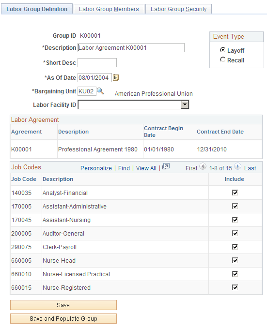

Labor Group Definition Page
Use the Labor Group Definition page (HR_LBR_GRP_DEFN) to use the group definition page to define the parameters of the labor management group.
Navigation:
Set Up HCM, and then Product Related, and then Workforce Administration, and then Labor Administration, and then Layoffs and Recalls, and then Labor Group Definition, and then Labor Group Definition
This example illustrates the Labor Group Definition page.
Field or Control Description
Event Type
Select the type of event in which this group will be used:
  • Select Layoff to include only workers with an HR status of Active in your group definition.
  • Select Recall to include workers with an HR status of either Active or Inactive. This enables you to include workers who have been laid off (HR status of Active) or terminated (HR status of Inactive) in your recall group.
As of Date
Only bargaining units, labor agreements, labor facilities, and job codes active as of this date are available on this page.
Bargaining Unit
Select the bargaining unit that you are using to define this group. The system will display the labor agreement, and its contract dates, associated with this unit in the Labor Agreement grid.
Note: You must select a bargaining unit associated with a labor agreement since the layoff, recall, and reinstatement processes use the information you set up on the labor agreement.
See Setting Up Bargaining Units.
Labor Facility ID
Select the ID of the labor facility you are using to define this group. Leave this field blank to include people in all the facilities.
The system will populate the options with the labor facilities assigned to the labor agreements associated with the selected bargaining unit.
See Setting Up Labor Agreement Control Tables.
Job Code and Include
The system displays the job codes associated with the labor agreements. Select the Include check box next to those job codes you want to include in this group definition.
See Job Codes Page.
Save
Click to save the group definition without populating the Labor Group Members page.
Save and Populate Gruop
Click to save the group definition and populate the group members page with the people assigned to the labor agreements, labor facilities, and job codes selected on this page.
See Defining Labor Agreements.

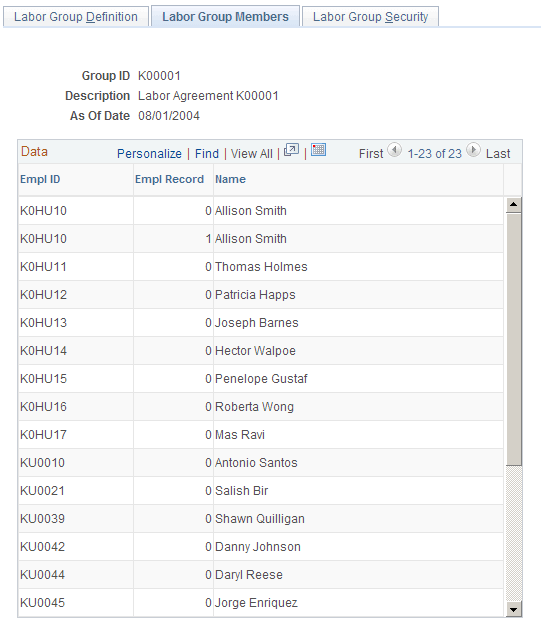

Labor Group Members Page
Use the Labor Group Members page (HR_LBR_GRP_MEMBERS) to review group members.
Navigation:
Set Up HCM, and then Product Related, and then Workforce Administration, and then Labor Administration, and then Layoffs and Recalls, and then Labor Group Definition, and then Labor Group Members
This example illustrates the Labor Group Members page.
The Labor Group Members page lists the people who meet the criteria you defined on the Labor Group Definition page.
