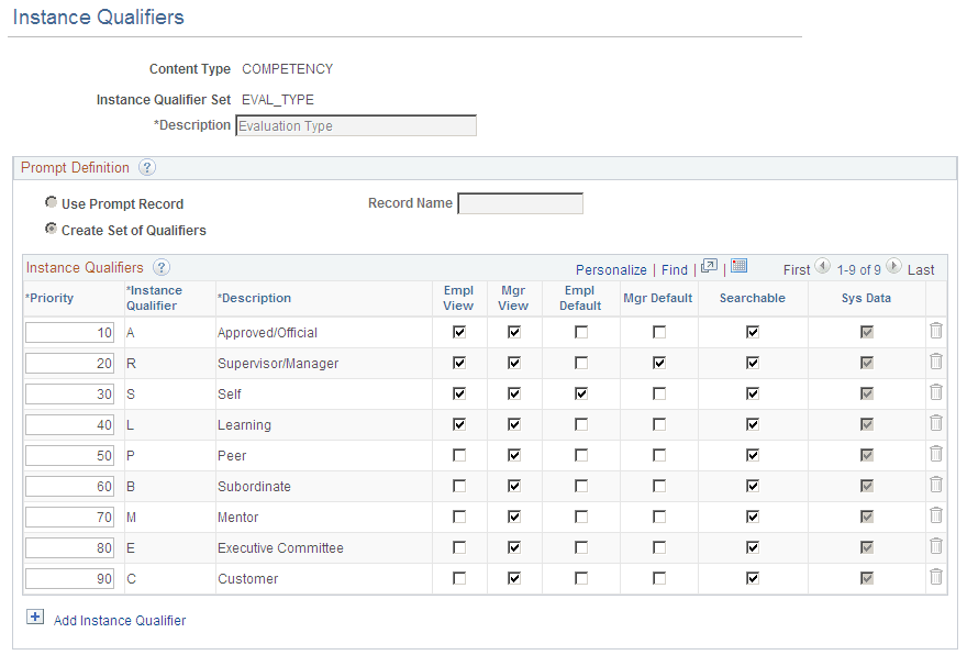

This example illustrates the fields and controls on the Instance Qualifiers page. You can find definitions for the fields and controls later on this page.
Field or Control Description
Use Prompt Record
Select to use a record in the database as the instance qualifiers. For example, you might use the PERSON_NAME record as the instance qualifier. The system makes the Record Name field available and hides the Instance Qualifiers grid area.
When you define a content section in a profile type, instance qualifiers that use a prompt record can be associated with the Instance Qualifier 2 field only. You can't specify instance qualifiers that use a prompt record in the Instance Qualifier 1 field.
Record Name
Select the record that contains the instance qualifiers. This field is available only if you select Use Prompt Record.
Create Set of Qualifiers
Select to create a new set of instance qualifiers in the Instance Qualifiers grid area. When you select this radio button, the Record Name field becomes unavailable and displays the Instance Qualifiers grid area.
Instance qualifiers of this type can be associated with the Instance Qualifier 1 field on the Content Section page; they can't be specified in the Instance Qualifier 2 field.
Instance Qualifiers
Priority
Enter a number that indicates the priority of the instance qualifier. The priority increases as the number decreases, so that the instance qualifier with the lowest number is considered the highest priority. The Schedule Search Index process that builds the search indexes for the Search and Compare Profiles feature also uses this field. The process uses the priority value to determine which profile item row is included in the index. The process includes the row that has the instance qualifier with the highest priority (lowest number).
See Building the Search Indexes.
Instance Qualifier
Enter the instance qualifier code and enter a description in the Description field.
Empl View (employee view)
Select this check box to enable employees to view rows in a profile that are assigned the selected instance qualifier.
Mgr View (manager view)
Select this check box to enable managers to view rows in a profile that are assigned the selected instance qualifier.
Empl Default (employee default)
Select this check box to specify the instance qualifier that is automatically used in the employee self-service transactions. If you select a check box in this column, when employees add or update rows in self-service, the system inserts the selected instance qualifier and employees cannot change the instance qualifier.
Mgr Default (manager default)
Select this check box to specify the instance qualifier that is automatically used in the manager self-service transactions. If you select a check box in this column, when managers add or update rows in self-service, the system inserts the selected instance qualifier and managers cannot change the instance qualifier.
Searchable
Select this check box if you want profile items with the selected instance qualifier to be included in the search indexes. The Schedule Search Index process uses this field to determine which profile item rows are included in the search indexes that are used by the Search and Compare Profiles feature.
If the Searchable check box is not selected, any profile item rows that are assigned the selected instance qualifier are always excluded from the search index.
