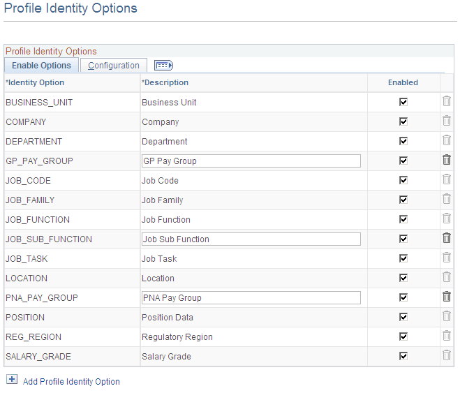

Enable Options Tab
Field or Control Description
Enabled
Select this check box to allow profile types to be linked to the entity specified in the Identity Option field.
If this check box is deselected, you cannot set up a profile type with this entity. For example, if you deselect the check box for the Job_Sub_Function option, you cannot define a profile type using the Job_Sub_Function profile identity option.

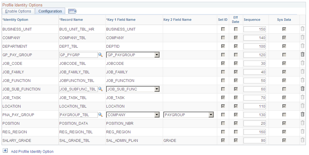

Configuration Tab
Access the Configuration tab on the Profile Identity Options page.
This example illustrates the fields and controls on the Profile Identity Options page: Configuration tab. You can find definitions for the fields and controls later on this page.
Sequence
Enter the number that determines the order in which non-person profiles related to a person's job are listed. The system uses the sequence value as follows:
  • On the Person Profile page, when you select View Related Job Profiles in the Profile Actions field, the system uses the sequence values to define the order in which the related profiles are listed. Profiles with the lowest sequence number are displayed first.
  • In eDevelopment, when employees select My Job Profiles, the system uses the sequence values to define the order in which the related profiles are listed. Profiles with the lowest sequence number are displayed first.
  • In ePerformance, when you are creating a document for an employee, the system retrieves all matching job profiles for an employee and then copies content from the profile with the highest priority (lowest sequence value).
See Common Elements Used to Define Profile Identity and Association Options.
