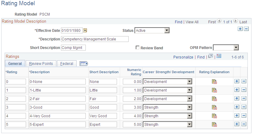

This example illustrates the fields and controls on the Rating Model page: General tab. You can find definitions for the fields and controls later on this page.
Rating Model Description
Field or Control Description
Review Band
Select this check box if you want to define this rating model as a Review Band Rating model.
Note: To use the JPN Grade Advance Candidate List and the JPN Salary Increase processes, the performance reviews in ePerformance must use a Review Band Rating model for overall review ratings.
See PeopleSoft Human Resources Manage Base Compensation and Budgeting: Understanding Updating Salaries for Japan.
OPM Pattern (Office of Personnel Management pattern)
(USF) Select the pattern that applies to this rating model. This field appears for U.S. Federal users only.
General Tab
Define all possible rating levels that can be used to evaluate an employee when this rating model is used. At least two rating levels are required. You can add as many rows as necessary.
Rating
Enter an alphabetic or numeric code for the rating. This is sometimes referred to as the qualitative rating.
Numeric Rating
This field is used by ePerformance only. Enter a numeric value for the rating, if applicable. The value you enter serves two purposes:
  • For sections of a performance document that use the average calculation method, the system uses this value to calculate the section's average or weighted average. It also uses this value to calculate the average rating for each item in the section (when sub-items exist).
  • If you select the Show Numeric Ratings/Points check box on the Rules/Roles page (EP_TMPL_DEFN3) of the Template Definition component, the value you enter here displays next to the rating on the performance document. This feature is useful when ratings are alphabetic.
Career Strength/Development
The system uses this value when defining competencies in the Plan Careers business processes using the Manage Profiles pages. Select:
Developmnt (development) if the rating indicates an area that needs more skill development, education, or training.
Strength if the rating indicates an area of strength.
See PeopleSoft Human Resources Plan Careers and Successions: Career Strength/Develop Areas Page.
Rating Explanation icon
Click to display the Review Rating Explanation Page.
