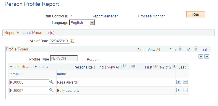

Person Profile Report Page
Use the Person Profile Report page (JPM_PPROF_RPT) to run the Person Profile report (JPM_JPPP_RPT) to generate a PDF file for each person listed in the run parameters.
Each report shows all items in the person's profile that are effective as of the date specified in run parameters. The Report Manager lists each report file separately with the employee ID in brackets in the report description.
Navigation:
Workforce Development, and then Profile Management, and then Reports, and then Person Profile Report, and then Person Profile Report
This example illustrates the fields and controls on the Person Profile Report page. You can find definitions for the fields and controls later on this page.
Field or Control Description
As of Date
The report lists the person's profile items that are effective as of the date you select. If you enter the current date, the report is identical to the current printable profile generated from the Person Profile page.
Profile Type
Select the profile types associated with profiles you want to print, adding a row for each profile type. The system displays person profile types only.
Note: After you select a profile type, you cannot change it.
EmplID
For each profile type, select the person IDs for the profiles that you want to print. You must select at least one person.

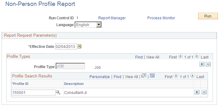

Non-Person Profile Report Page
Use the Non-Person Profile Report page (JPM_NPPROF_RPT) to run the Non-Person Profile report (JPM_JPNP_RPT) to generate a PDF file for each profile listed in the run parameters.
Each report shows all items in the profile that are effective as of the date specified in run parameters. The Report Manager lists each report file separately with the profile ID in brackets in the report description.
Navigation:
Workforce Development, and then Profile Management, and then Reports, and then Non-Person Profile Report, and then Non-Person Profile Report
This example illustrates the fields and controls on the Non-Person Profile Report page. You can find definitions for the fields and controls later on this page.
Effective Date
The report lists the profile items that are effective as of the date you select. If you enter the current date, the report is identical to the current printable profile generated from the Non-person Profile page.
Profile Type
Select the profile types associated with the profiles that you want to print, adding a row for each profile type. The system displays non-person profile types only.
Profile ID
For each profile type, select the profiles that you want to print.
