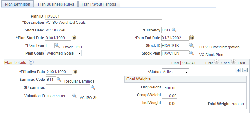

Plan Definition Page
Use the Plan Definition page (VC_PLAN_TBL) to define a variable compensation plan, plan dates, earnings code, plan type, and specifics related to the plan type.

This example illustrates the fields and controls on the Plan Definition page.
Field or Control Description
Currency
Select the currency in which you want the system to calculate, display, and report allocations. For rollup purposes, you must select one currency for the plan. Payout is in the appropriate currency for the worker.
For stock-type plans, the default value is the currency code for the stock ID on the Stock Exchange table. The currency of the VC plan must match the currency of the stock plan.
Plan Start Date
Enter the date on which you want the plan to begin. After you save the plan definition, you cannot change this date.
For stock-type plans, this date cannot be earlier than the approval date of the stock plan.
Plan End Date
Enter the date on which you want the plan to end. After you save the plan definition, change the plan end date to a later date only if you want to extend the plan.
For stock-type plans, this date cannot be later than the expiration date of the stock plan.
Plan Type
Select from the available options: Discretionary Bonus, Goal Sharing, Non-Monetary, Other, Profit Sharing, Stock ISO, Stock NQ, Stock NSAR, Stock RSA, and Stock ISAR.
Fields Related to Plan Type
When you select a specific plan type, the system displays these additional fields:
Plan Type Visible Fields
Discretionary Bonus
Plan Goals
Goal Sharing
Plan Goals
Non-Monetary
Valuation ID, Plan Goals
Other
Plan Goals
Stock (ISO, NQ, NSAR, RSA, and ISAR)
Plan Goals, Stock ID, Stock Plan, Valuation ID.
Plan Goals
Select the type of goal administration to use with the plan. Values are:
  • Goals Matrix: If you select this value, the Matrix Columns field appears in the Plan Details group box.
  • Weighted Goals: If you select this value, additional fields appear below in which you define weighting percentages for goal levels.
Stock ID
Enter the ID that applies to this plan. The system prompts you with values from the Stock table. This field does not appear if you do not use Stock Administration.
Stock Plan
Enter the ID that applies to this VC plan. This field does not appear if you do not use Stock Administration.
Plan Details
The plan definitions in this section of the page might change during the life of the plan. Insert a row and enter new data to modify a plan.
Earnings Code
Payroll reporting code. Applies to awards paid out through PeopleSoft Payroll for North America.
GP Earnings (global payroll earnings)
Payroll reporting code. Applies to awards paid out through Global Payroll.
Valuation ID
Select an ID from the available options, which the system prompts you with from the VC Valuation table. This field appears only if the plan type is Non-Monetary or one of the Stock types.
The ID that you select must be defined with the same currency code as the currency code that you select for this plan ID.
This field represents only the valuation ID. The system determines the monetary value associated with the valuation ID that is used to calculate the award value using the maximum effective-dated row on the VC Valuation table that is equal to or less than the payout period end date.
Matrix Columns
This field appears if you select Goals Matrix in the Plan Goals field. Select the number of columns that you will set up in your goals matrix: Three, Five, or Seven.
Goal Weights
In this group box, indicate the relative weighting of goals at each of the three goal levels: organization, group, and individual. The default weight is 0 percent at each level. Change the percent only for the levels of goals used by the plan. The sum of all levels must equal 100 percent.
Org Weight (organization weight)
Enter the relative percentage of organizational goals compared to other goals used in administering the plan.
Group Weight
Enter the relative percentage of group goals compared to other goals used in administering the plan.
Indicate a weight for group goals only if the plan's Group Member Rule is Empl VC Rec with Groups or Define Tree Group, as specified on the Plan Business Rules page.
Ind Weight (individual weight)
Enter the relative percentage of individual goals compared to other goals used in administering the plan.
Total Weight
The system computes the totals of the percentages as you enter them at each level and displays the sum in the Total Weight field. Adjust the weights until the sum of all levels equals 100 percent.

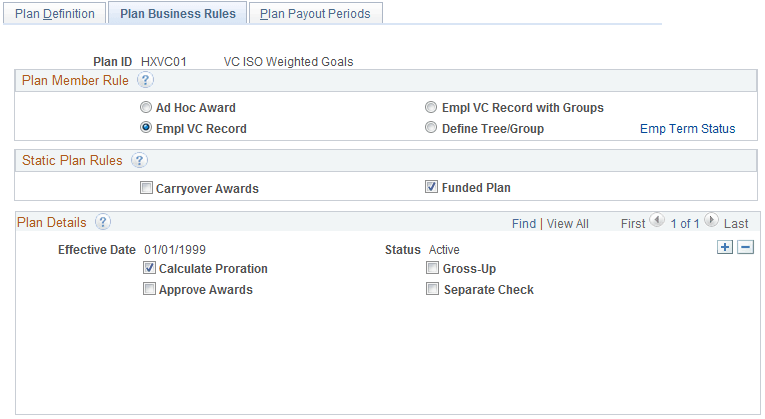

Plan Business Rules Page
Use the Plan Business Rules page (VC_PLAN_BUS_RULE) to specify the method of administering plan membership and select optional business rules for the plan.

This example illustrates the fields and controls on the Plan Business Rules page.
Plan Member Rule
Select the rule to use to administer membership under this VC plan: Ad Hoc Award, Empl VC Record (employee variable compensation record), Empl VC Record with Groups (employee variable compensation record with groups), and Define Tree/Group.
See Understanding Plan Member Rules.
Emp Term Status (employee termination status)
Click to access the VC Termination Status page, where you select the termination status codes that exclude workers from payment under the plan.
This link appears if you select Empl VC Record.
Static Plan Rules
These rules remain in effect for the life of the VC plan. You cannot change these rules by inserting a new row.
Carryover Awards
Select if you want to carry over balances at the worker level for unallocated awards. Selecting this check box enables the Carryover Balance, Accum Carryover (accumulated carryover), and Carryover Amount fields on the Allocate Awards page. The system maintains the carryover balance for the life of the plan.
Carryover is not an acceptable option for non-monetary and stock-type plans.
This field is unavailable if you've selected the Ad Hoc Award option as the Plan Member Rule.
Funded Plan
Select if you allocate a funding amount to the VC plan or are defining a stock-type plan.
Plan Details
The plan definitions that you select in this group box might change during the life of the plan. To modify a plan, insert a row and enter new data.
Calculate Proration
Select if you want to prorate eligibility under the plan. This check box is unavailable for entry if you selected the Ad Hoc Award option as the Plan Member Rule.
Approve Awards
Select if you want to approve awards by either of these methods:
  • Run the Approve Awards or Approve Awards by Group process to approve or disapprove awards at the plan or group level.
  • Designate an approver who can manually approve awards individually under the plan on the Allocate Awards page.
Approver
This field appears if you select Approve Awards for a plan that has Ad Hoc Award or Empl VC Record as the Plan Member Rule. Enter the ID of the person authorized to approve awards for the entire plan. The system displays the worker's name next to the employee ID that you enter.
If you administer the plan using groups, the approver is established through VC group tree security, so the Approver field remains hidden.
Gross-Up
Select if you want payroll to apply gross-up rules to award payouts under this plan.
Separate Check
Select if you want payroll to issue the awards on a check separate from the worker's normal paycheck.
If you are processing awards through PeopleSoft Payroll for North America and you selected Gross-Up on this page, you must select Separate Check.
Plan Tree
This group box appears on the page only if the selected plan member rule is Empl VC Record with Groups or Define tree/Group.
Tree Name
Select the name of the VC Tree that you want to associate with this VC plan.
Group ID
The ID of the highest group on the tree that you select in Tree Name.
