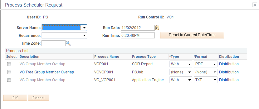

Select the tree whose membership you want to report on.
Click Run and then select the process from the process list.
This example illustrates the fields and controls on the Tree member overlap process scheduler request.
You can select the VC Tree Group Member Overlap (PSJob) process to run both the AE (Application Engine) and the Structured Query (SQR) Report. Or you can run the AE process first, followed by the SQR report.
