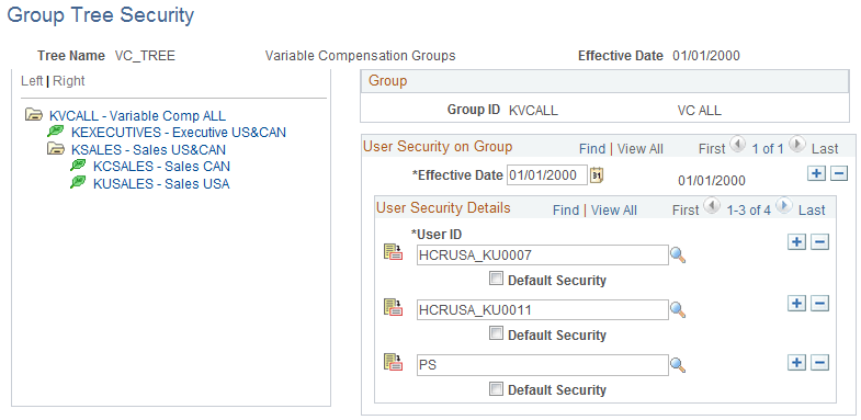

Group Tree Security Page
Use the Group Tree Security page (VC_TREE_SEC_TABLE) to set up a security relationship between a group on a Variable Compensation tree, a user, and the Variable Compensation components.
Access to a group provides access to variable compensation components for all its child groups as well.
Navigation:
Set Up HCM, and then Product Related, and then Compensation, and then Variable Compensation, and then Group Tree Security, and then Group Tree Security
This example illustrates the fields and controls on the Group Tree Security page.
Field or Control Description
Tree Name
The name of the tree that you entered on the search page, along with its description.
Effective Date
The default is the date that you entered in the Effective Date field of the search page. Change the date to access the same tree as of a different effective date.
Using the Tree Control View
The Tree Control view on the left side of the page displays the tree as it is defined in PeopleSoft Tree Manager. Each node represents a group. The node description is the group ID.
In the Tree Control view, select a node for which you want to define security access. The group ID and description of the group appear on the right side of the page.
User Security on Group
Effective Date
Enter the effective date of the user's security access. You can add rows of data with different effective dates. Enter the page in Correct History mode to delete a row.
User ID
You see a data row for the ID of each user who has security access to the selected group ID for the specified effective date. Add a user by adding a data row and selecting a user ID from the available values.
Set up your group tree security so that you give access to both the manager and the approver of a group.
You cannot delete users whose access to this group is inherited from a parent group (the Default Security check box is selected). The system performs this check within the tree and between trees when the parent group is reused in another tree. If you try to delete a data row for inherited access, the system issues a message that specifies the user ID along with the tree name and group ID of the parent group.

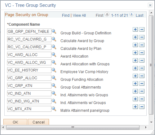

VC - Tree Group Security Page
Use the VC (variable compensation) - Tree Group Security page (VC_TREE_SECU_SEC) to specify the components for which the selected user has security access.
Navigation:
Click the Component Security icon to the left of the user ID on the Group Tree Security page.
This example illustrates the fields and controls on the VC - Tree Group Security page.
Component Name
By default, a new user has access to all Variable Compensation components. On the VC - Tree Group Security page, delete the data rows for any components that you don't want the user to access. The system applies your component selections to the selected group ID, user ID, and effective date. Your selections also apply to any child groups of the selected group ID.
