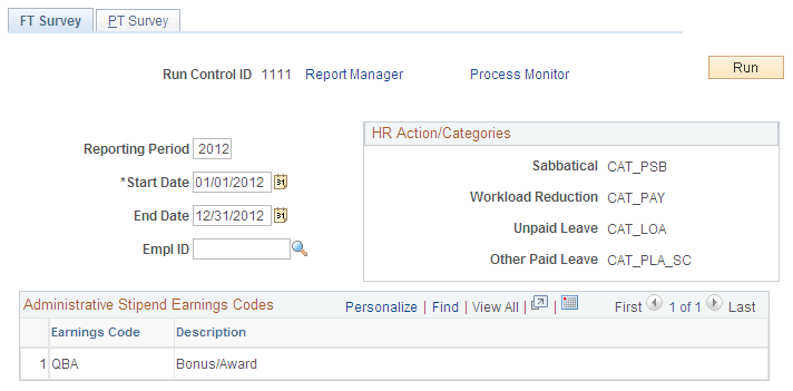

FT Survey Page
Use the FT Survey (full-time survey) page (RUNCTL_HPH901CN) to load FT survey data for each FT employee who qualifies.
Before using this page, complete the Member Data Table for all FT teaching members in the survey.
Navigation:
Workforce Development, and then Faculty Events, and then Load Teaching Data CAN, and then Load Teaching Survey Data, and then FT Survey
This example illustrates the fields and controls on the FT Survey page.
FT Survey page
HR/Action Categories
Field or Control Description
Sabbatical, Workload Reduction, Unpaid Leave and Other Paid Leave
Displays the HR Action/Categories from the Reporting Period Stats CAN page.
Earnings Code
Displays the earnings code used to pay annual stipends, or other honoraria for administrative duties.
