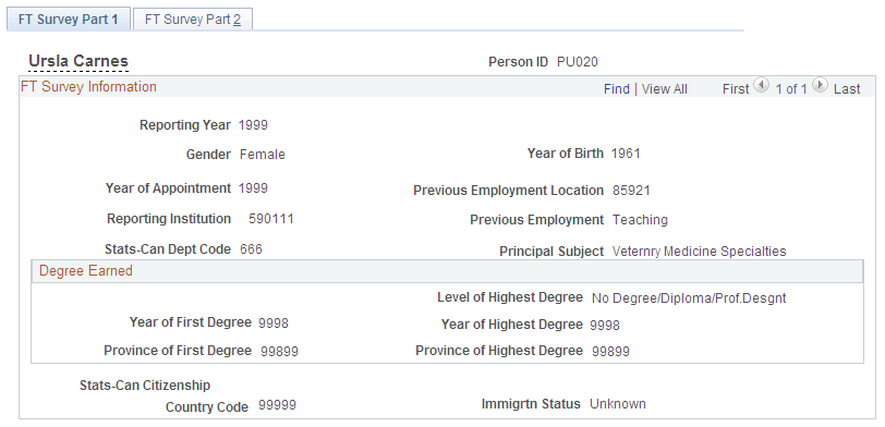

FT Survey Part 1 Page
Use the FT Survey Part 1 (full-time survey part 1) page (HP_FT_SURVEY_PNL1) to view survey results for each FT employee.
Before using this page, set up the Load Teaching Survey Data - FT Survey page.
Navigation:
Workforce Development, and then Faculty Events, and then Qualify Academic Teaching CAN, and then Full-Time Surveys, and then FT Survey Part 1
This example illustrates the fields on the FT Survey Part 1 page.
You can also use Profile Management to capture degree information for employees.
See the PeopleSoft Human Resources Manage Profiles product documentation.
FT Survey Information
Field or Control Description
Year of Appointment
Displays the first year the employee appeared in the survey report. If the employee was not reported for a year or more, this field displays the first year the employee resumed reporting.
Previous Employment Location
Displays the employee's previous employment location from the Full-Time Member page.
Reporting Institution
Displays the Statistics Canada reporting institution from the Company Table.
Previous Employment
Displays the employee's previous employment from the Full-Time Member page.
Stats-Can Dept Code (Statistics Canada department code)
Displays the Statistics Canada code associated with the department of the primary reported job from the Department Table.
Degree Earned
Year of First Degree
Displays the year the employee received his or her first degree from the Professional Training page.
Province of First Degree
Displays the province in which the employee received his or her first degree from the Professional Training page.
Province of Highest Degree
Displays the province in which the employee received his or her highest degree from the Professional Training page.
Stats-Can Citizenship Country Code(Statistics Canada citizenship country code)
Displays the Statistics Canada citizenship country code associated with the employee's country of citizenship from the Citizenship/Passport page.
Maintain country codes in the Country Table.
Immigrtn Status (immigration status)
Displays the employee's immigration status from the Membership Data page.

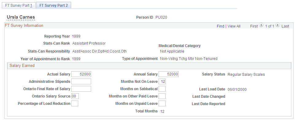

FT Survey Part 2 Page
Use the FT Survey Part 2 (full-time survey part 2) page (HP_FT_SURVEY_PNL2) to view survey results for each FT employee.
You can also modify some survey information, but it is better to modify the fields at the source of the data and recreate the surveys.
Navigation:
Workforce Development, and then Faculty Events, and then Qualify Academic Teaching CAN, and then Full-Time Surveys, and then FT Survey Part 2
This example illustrates the fields on the FT Survey Part 2 page.
Stats-Can Rank
Displays the Statistics Canada rank from the Academic Rank field in the Job Code table.
Stats-Can Responsibility
Displays the Statistics Canada responsibility from the duties in the Statistics Canada Academic Teaching Employment table.
Year of Appointment to Rank
Displays the first year the employee achieved the reported rank. If the employee was not reported for a year or more, this field displays the first year the employee resumed reporting.
Type of Appointment
Displays the type of appointment, based on information in the Visiting Faculty field on the Full-Time Member page and the Tenure Status field in the Tenure Data page.
Salary Earned
Actual Salary
Displays the actual salary, based on compensation and Job Earnings Distribution information from the reporting year.
The actual salary amount includes contracts, leaves, reduced workloads, and salaries for multiple jobs identified by the Collapse as FT check box in the Statistics Canada Academic Teaching Employment table. The salary does not include administrative stipends or salary increases effective after October 1 of the reporting year.
The system uses decimal months to calculate actual salary, which may result in skewed figures. You can modify this field.
Annual Salary
Displays the actual salary. If the employee has not had a reduced workload and has been working for the entire 12 months of the reporting year, the Annual Salary is the same as the actual salary. The salary does not include administrative stipends or salary increases effective after October 1 of the reporting year.
Salary Status
Displays the salary status from the Full-Time Member page.
Administrative Stipends
Displays the amount paid for stipends and honoraria for administrative duties for the reporting year, based on job earnings distribution records.
The system uses decimal months to calculate administrative stipends, which may result in skewed figures. You can modify this field.
Ontario Final Rate of Salary
Displays the final rate of salary for Ontario-based institutions, based on the annual salary and administrative stipends.
Ontario Salary Source
Displays the salary source for Ontario-based institutions, based on the job earnings distribution amounts distributed to non-operational funding accounts, excluding administrative stipend amounts.
Percentage of Load Reduction
Displays the percentage by which an employee's workload has been reduced, based on the Std Hrs (standard hours) in the Job Data and the Job Code components.
The system calculates this value as follows:
The job data standard hours divided by the job code standard hours multiplied by the number of reduced workload decimal months divided by the number of decimal months in the appointment.
q_7fa4_hhfe7f93
Months Not On Leave, Months On Sabbatical, Months On Other Paid Leave, and Months On Unpaid Leave
