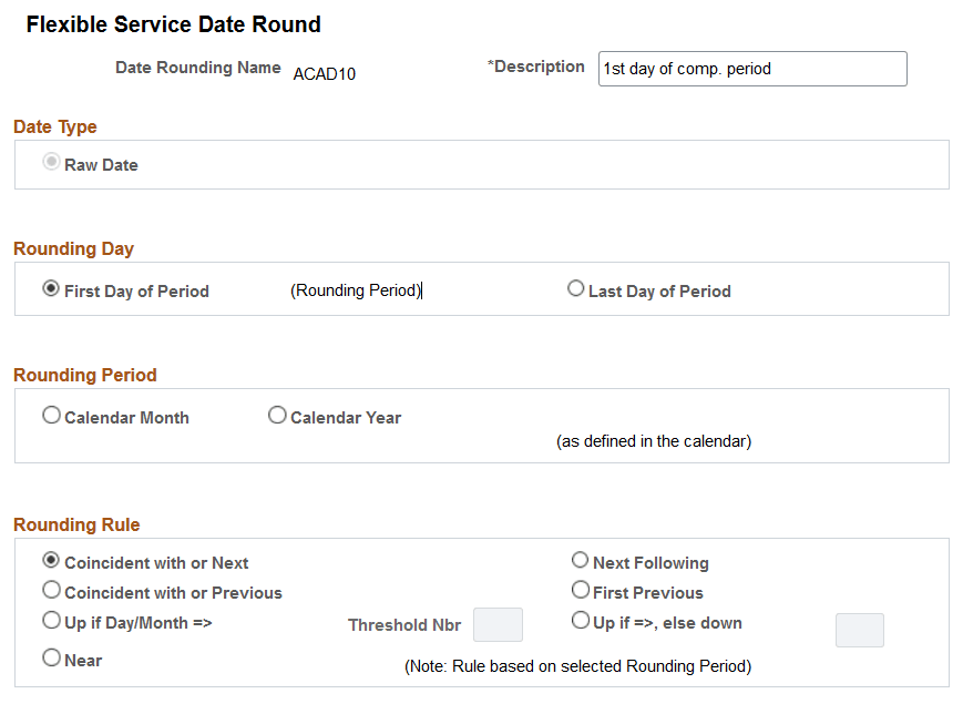

Flexible Service Date Round Page
Use the Flexible Service Date Round page (EG_DATE_ROUND) to set up date rounding rules.
Navigation:
Set Up HCM, and then Product Related, and then Workforce Administration, and then Flexible Service EG, and then Service Rules, and then Flexible Service Date Round, and then Flexible Service Date Round
This example illustrates the fields and controls on the Flexible Service Date Round page.
Date Type
Raw Date is the default for calculating tenure and flexible service.
Rounding Day
Select whether to round to the first day of the period or the last day of the period.
When you round to the last day of the period, you don't have to specify your rounding rule. The date is always rounded to the last day of the current period. For example, if you round to the last day of the calendar month, August 3, 2001 becomes August 31, 2001.
However, if you round to the first day of a period, you can round to the next, the coincident (with) or next, the previous, the coincident (with) or previous, or the near (nearest) rounding day.
Rounding Period
Select Calendar Month or Calendar Year. For example, when managing job history records in tenure service and flexible service calculation, select Calendar Month.
Rounding Rule
Make your rounding dependent upon a threshold number of days in the month or a threshold number of months in the year by selecting Up if Day/Month => (up if day or month is equal to or greater than) or Up if Day/Month => Else Down. Both options round up after a threshold number of days (if the rounding period is months) or months (if the rounding period is year). However, the first option doesn't round dates that are below the threshold, whereas the second option rounds down.
These tables illustrate how each of these options works. In all cases, assume that you are rounding to the first of the month.

Select a rounding rule from the following options:
Coincident or Next
Next
Coincident or Previous
Previous
Up if Day/Month =>
Near
If you selected Last Day of Period in the Rounding Day group box, the Rounding Rule group box is unavailable for entry.
