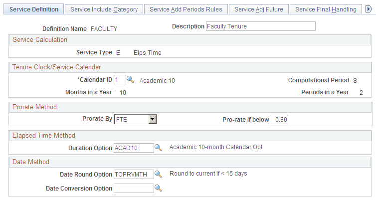

Service Definition Page
EG_SVC_DEFINITION
Associate a calendar, a proration method, and a date method (for rounding) with the service definition name.

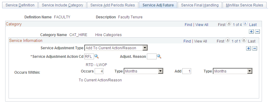

Service Adj Future Page
EG_SVC_ADJ
Define human resource status history adjustments that depend on future changes in status.

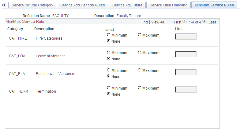

Min/Max Service Rules Page
EG_SVC_MIN_MAX_SVC
Define adjustments that limit the number of hours or service units that can be accrued within a specific period of time.

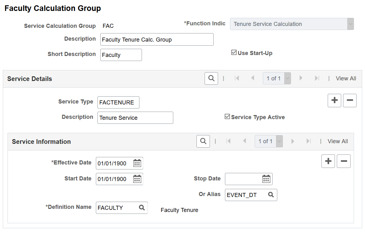

Faculty Calculation Group Page
EG_CALC_GRP_DFN1
Define service calculation groups to group employees who have the same calculation rules applied to their service accrual process.

Service types belong to a calculation group. The calculation group can be associated with one or more service types. The calculation group enables you to group employees who have the same calculation rules applied to their service accrual process.

  9. Define service calculation groups.

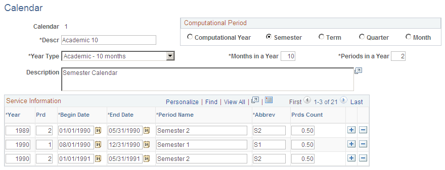

Calendar Page
Use the Calendar page (EG_FLXSVC_CALNDR) to establish service calendars for accruing service years.
Navigation:
  • Set Up HCM, and then Product Related, and then Workforce Development, and then Faculty Events, and then Calendar, and then Calendar
  • Workforce Development, and then Faculty Events, and then Define Faculty Events Data, and then Calendar, and then Calendar
This example illustrates the fields and controls on the Calendar page.
Calendar page
Set the number of months and periods in a service year, as well as the start and end dates for each period in the year.
The period start and end dates are crucial to the service accrual process. These are the dates against which service is accrued for your employees. For example, an organization might have the following definitions:
  • An academic year of 10 months (August 1 to May 31).
    The year has 2 periods; each period spans 5 months. Service is accrued based on each 5-month period.
  • A fiscal year of 12 months (July 1 to June 30).
    The year has 1 period spanning the full 12 months. A fiscal year calendar might be used to accrue service credits for seniority.
When you create a new calendar, enter information into all of the fields in the calendar grid and add a row for each period in each year against which you want the calendar to enable service to accrue.
The background processes that track flexible service and tenure service don't accrue service credits for dates that are not represented on the calendar. Therefore, you must ensure that the calendar being used by a particular service type spans the date range for the accrual process.
Computational Period
Field or Control Description
Year, Semester, Term, Quarter, or Month
Select a time frame to accrue flexible service or tenure.
Year Type
Select a year type on which to base calculations. Then specify the number of months and periods in a year for this year type, for example, an academic year of 10 months divided into 4 periods (quarters).
Your system is delivered with year types Acad-10 and Fiscal-12. You can make additional entries on the translate table.
Months in a Year
Enter the number of months in the calendar year that you are defining.
Periods in a Year
Enter the number of periods in the calendar year.
Year
Enter the calendar year that is covered by the defined calendar. For example, if the academic year 2006 comprises two semesters, one starting in September 2005 and the other in January 2006, enter 2006 in this column for both semester rows.
Prd. (period)
Enter the period for the defined calendar year. Enter the calendar period numbers in sequence; for example, 1 through 4, if you selected Acad-10 divided into 4 periods.
Begin Date and End Date
Enter the period's start and end dates.
Period Name
Enter the period name.
Abbrev (abbreviation)
Enter an abbreviated name for the period.
Prds Count (periods count)
Using a decimal value of up to two decimal places, enter how much the period counts toward the entire year (for example, for four periods, each period can count as 0.25 of the total year). Use this value to calculate how much credit an employee receives for working the period.
Important:
When you enter start and end dates on the employee's Service History page and on the Tenure Calculation or Flexible Service Calculation run control pages, make sure that the dates on the pages match the dates in the Begin Date and End Date fields; otherwise the process won't run. You might have to define calendars solely for the purpose of accommodating employees whose start dates don't correspond to an existing calendar period begin date and end date.

This example illustrates the fields and controls on the Service Definition page.
Service rules become part of the definition name that you assign to a service type. The system processes service types based on the service rules that are defined in the definition name. Grouping service rules under a definition name provides flexibility when you are determining calculation rules for different types of service accrual processing.
Definition Name
Displays the name that you selected. Enter a new definition name for this set of service rules in the Add-Service Rules search page.
Service Calculation
Service Type
Displays the method used to calculate accrued service. By default, the system uses Elps Time (elapsed time). This method measures the time duration between two dates, taking into account the HR action and category event changes on the employee's job history.
See Service Include Category Page.
Tenure Clock/Service Calendar
Calendar ID
Enter the calendar ID to use for this definition name. Calendars are maintained on the Calendar page. For example, you might link the definition name, FACULTY, to a service calendar that is based on the academic year using the computational period of a semester (10 months in a year and 2 periods in a year).
See Calendar Page.
Months in a Year
Displays the number of months per year for the selected calendar, as defined on the Calendar page and based on the Calendar ID field.
See Calendar Page.
Displays the period of time during which the service calculation is based. This is based on the Calendar ID field, for example, S (semester). This field is populated by the selected calendar, which is maintained on the Calendar page.
See Calendar Page.
Periods in a Year
Displays the number of periods per year for the selected calendar and is based on the Calendar ID field.
Prorate Method
Prorate By
Select a prorate method of None or FTE (full-time equivalency), depending on the type of service being tracked.
Pro-rate if below
Enter the percentage of FTE (for example, 80) below which you want the system to prorate accrued service. The system calculates any FTE value that is equal to or greater than this value as 1.0, for the purpose of proration. This field isn't visible if you selected None in the Prorate By field. The system calculates all FTE values as 1.0.
Elapsed Time Method
Duration Option
Enter a duration from the list of options. You can set up different ways to calculate elapsed time using the Duration Option pages.
See Setting Up Service Parameters.
Date Method
Date Round Option
Enter a date rounding method to be used in calculating service dates. You set date rounding options on the Date Round Option page.
See Flexible Service Date Round Page.
Date Conversion Option
Enter a date conversion method, such as ACAD, from the list of options. Date conversion methods are established and maintained on the Date Conversion Option page. This field applies only to the flexible service tracking. It doesn't apply to tenure tracking.

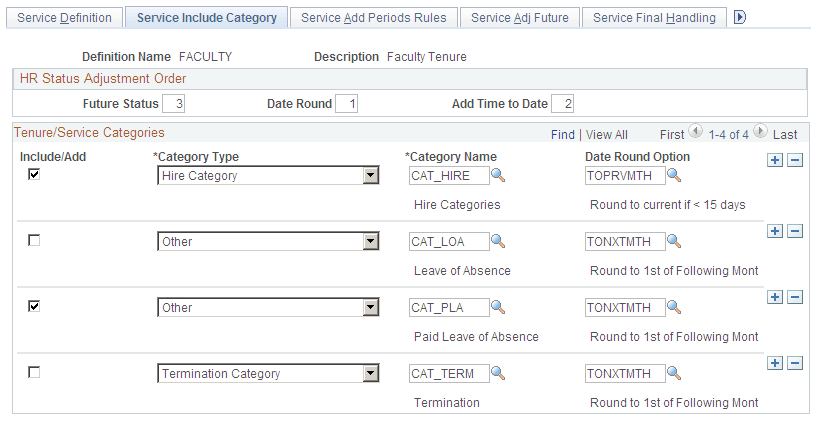

Use the Service Include Category page (EG_SVC_STATUS) to define the HR service categories in the service accrual process in the selected definition name. Use this page to specify the date-rounding options for each HR category that is included on this page.
Navigation:
  • Set Up HCM, and then Product Related, and then Workforce Development, and then Faculty Events, and then Service Rules, and then Service Include Category
  • Workforce Administration, and then Flexible Service EG, and then Define Flexible Service Rules, and then Service Include Category
  • Workforce Development, and then Faculty Events, and then Define Faculty Events Data, and then Service Rules, and then Service Include Category
This example illustrates the fields and controls on the Service Include Category page.
Employees accrue service credits based on the action and reason codes in their job history. The HR' actions and categories are defined on the HR Action/Category page and comprise one or more job action and reason codes. The action and reason codes defined in the HR category determine whether an employee accrues credits for each job action and reason.
See Group HR Action/Category Page.
HR Status Adjustment Order (human resources status adjustment order)
You can make multiple adjustments to status, and each change has the same date. Therefore, you must tell the background calculation process in what sequence to apply these adjustments. Using this group box, indicate the order (from 1 to 3) in which the adjustments are to be made.
Future Status
Refers to the status entered on the Service Adj Future page.
See Service Adj Future Page.
Date Round
Refers to the date round options set on this page.
Add Time to Date
Refers to the adjustment entered on the Service Add Periods Rules page.
See Service Add Periods Rules Page.
Tenure/Service Categories
Include/Add
Select to have the service category in the Category Name field count toward service accrual. For example, select this check box if you want a leave of absence to count toward service accrual.
Category Type
Select a category type such as Hire Category, Other, or Termination Category.
Category Name
Enter a HR category name, such as CAT_LOA (category leave of absence). An HR category comprises one or more job action and reason codes. You establish HR categories and their component HR' action and category groups on the HR Action/Category page.
For example, if you select the category CAT_HIRE (category hire), which you set up to include the action codes HIRE (hire) and REH (rehire), select the Include/Add check box to make both of these job action codes eligible for accrual within the definition name.
Date Round Option
Enter the option that is to be used for each HR category. For example, you might round all hire and rehire dates to the first of the month. Thus, credit is accrued based on the first of the month, regardless of the date in the month that the employee was hired. These options are maintained on the Flexible Service Date Round Page.

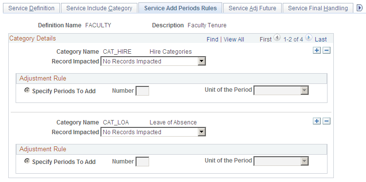

Use the Service Add Periods Rules page (EG_SVC_ADD_PERIODS) to define the adjustments where the effective date of a status change moves forward. Use this page to select the employee records that are affected by the parameters that you set throughout the Service Rules component.
Navigation:
  • Set Up HCM, and then Product Related, and then Workforce Development, and then Faculty Events, and then Service Rules, and then Service Add Periods Rules
  • Workforce Development, and then Faculty Events, and then Define Faculty Events Data, and then Service Rules, and then Service Add Periods Rules
This example illustrates the fields and controls on the Service Add Periods Rules page.
Sometimes you may want to delay the effective date of an action and reason event. For example, if an employee can continue to accrue service for the first month of a leave, you adjust the effective date of any leave action by adding a month. Do this by adding a time period to the action and reason effective date.
Category Name
The category name refers to the HR service category, such as CAT_HIRE (category hire) that is specified on the Service Include Category page. To set up adjustment rules for more than one category name, add new rows. If you entered more than one category name, select the insert row button to add information for each category.
Record Impacted
Select the instances in which a new status should receive an adjustment. When you add time to an action and reason effective date, you are giving additional service (or breaks) by delaying the impact of the change. For example, you grant a 30-day leave of absence adjustment for only the first leave and do not adjust any subsequent leaves.
Adjustment Rule
In this group box, specify how the system applies the time adjustment that you specify. When you add time to an action and reason effective date, you delay the impact of the change. You may not want to do this for each occurrence of the action. For example, you can grant the 30-day leave of absence adjustment only for the first leave and not adjust any subsequent leaves.
Periods to Add
Select to add time to an effective date.
Note: This option might be unavailable for entry, depending on your selection in the Record Impacted field.
Number
Enter the number of periods to add to the accrued service.
Unit of the Period
Select the unit for the periods that you are adding. For instance, if you select Days in this field and enter 2 in the Number field, the system adds two days to the effective date of the selected category.
Use the Service Adj Future (service adjust future) page (EG_SVC_ADJ) to define human resource status history adjustments that depend on future changes in status.
Navigation:
  • Set Up HCM, and then Product Related, and then Workforce Development, and then Faculty Events, and then Service Rules, and then Service Adj Future
  • Workforce Administration, and then Flexible Service EG, and then Define Flexible Service Rules, and then Service Adj Future
  • Workforce Development, and then Faculty Events, and then Define Faculty Events Data, and then Service Rules, and then Service Adj Future
This example illustrates the fields and controls on the Service Adj Future page.
How you treat service for a particular HR status might depend on the employee's subsequent status. For example, employees on leave might accrue service only if they return to work later. On this page, you can adjust the current event based on a future event or adjust a future event based on a second future event.
Adding Time to the Effective Date of a Status Change
By adding a time period, you can delay an effective date based on other events that occur later within defined periods of time.
For example, you can adjust the effective date of a leave of absence by one month (that is, to grant one month of extra service) only if the employee returns within four months. To do this, select Add in the Service Adjustment Type field and RFL (return from leave) in the Service Adjustment Action Cd (service adjustment action code) field. In the Occurs Within fields, enter 4 in the AdjWin Num field and select Months in the Type field; enter 1 in theAdd field and select Months in the Type field.
Ignoring the Current Status Change
By selecting Ignore Cur (ignore current action and reason) in the Service Adjustment Type field, you can ignore the original human resource status change based on other events that occur later within defined periods of time.
When you select this adjustment, select the event in the Service Adjustment Action Cd field. In the Occurs Within fields, indicate how far into the future to look for this event.
For example, you can ignore a leave of absence if the employee returns within one month. To do this, select Ignore Cur in the Service Adjustment Type field and RFL in the Service Adjustment Action Cd field. In the Occurs Within fields, select 1 and Months.
This adjustment has the following effect:
Hire 01/01/2006 Hire 01/01/2006
Leave
05/01/2006
None
None
Return
05/15/2006
Return
05/15/2006
Notice that this employee's 15-day leave is ignored. Because it was less than one month, the system doesn't consider it a break in service.
Using the inside scroll bar, you can enter as many service adjustments, as necessary, for each category.
Service Information
Select from the list of values. Options are:
  • Add
  • Ignore Cur (ignore current)
  • Ignore Fut (ignore future)
  • Insert
Some of the fields that appear below this field vary, depending on the value that you select here.
Enter the type of service adjustment action, such as HIRE (hire).
Adjust. Reason (adjustment reason)
Enter the reason for the adjustment, such as LTDP (long term disability with pay).
Occurs Within
The system displays this when you select Add, Ignore Cur, or Ignore Fut in the Service Adjustment Type field.
Does Not Occur Within
The system displays this when you select Insert in the Service Adjustment Type field.
AdjWin Num (adjustment window number)
Enter a number to use in conjunction with the Type field.
Type
Select Days, Months, User Code, Weeks, or Years.
Add
Enter a time period to add to the service adjustment. This field appears when you select Add in the Service Adjustment Type field.
Ignore Future
Select the type of service adjustment action that is to be ignored in the future. This field appears when you select Ignore Fut in the Service Adjustment Type field.
Adj Act 2 (adjustment action 2)
Select a service adjustment action that is define in the HR category. This field appears when you select Insert or Ignore Fut in the Service Adjustment Type field.
Reason
Select the reason code that is defined in the HR category. This field appears when you select Insert or Ignore Fut in the Service Adjustment Type field.
Insert
Select the type of service adjustment action that is to be inserted. This field appears when you select Insert in the Service Adjustment Type field.
Use the Min/Max Service Rules (minimum and maximum service rules) page (EG_SVC_MIN_MAX_SVC) to define adjustments that limit the number of hours or service units that can be accrued within a specific period of time.
Navigation:
  • Set Up HCM, and then Product Related, and then Workforce Development, and then Faculty Events, and then Service Rules, and then Min/Max Service Rules
  • Workforce Administration, and then Flexible Service EG, and then Define Flexible Service Rules, and then Min/Max Service Rules
  • Workforce Development, and then Faculty Events, and then Define Faculty Events Data, and then Service Rules, and then Min/Max Service Rules
This example illustrates the fields and controls on the Min/Max Service Rules page.
These rules apply to an HR action and category that is based on a calendar period.
If there are additional categories, use the scroll arrow to display more categories and rules. To add a new row, select the Insert Row button on the Service Include Category page.
Category
Displays the service category, such as CAT_HIRE (category hire), which is defined on the Service Include Category page.
Description
Displays service category descriptions (such as Hire Categories), which are maintained on the Service Include Category page.
Limit
Select Minimum or Maximum to specify a minimum or maximum service limit for each category that is listed. Select None for no limit.
Service
Enter the minimum or maximum amount of service for the selected category. This field is required if you selected Minimum or Maximum as a limit.
Use the Faculty Calculation Group page (EG_CALC_GRP_DFN1) to define service calculation groups to group employees who have the same calculation rules applied to their service accrual process.
Navigation:
  • Set Up HCM, and then Product Related, and then Workforce Development, and then Faculty Events, and then Faculty Calculation Group, and then Faculty Calculation Group
  • Workforce Development, and then Faculty Events, and then Define Faculty Events Data, and then Calculation Group, and then Calculation Group
This example illustrates the fields and controls on the Faculty Calculation Group page.
The layouts of the Faculty Calculation Group page and Calculation Group page are identical.
The calculation group provides a way to group employees who have the same calculation rules applied to their service accrual process. You can associate the calculation group with one or more service types.
By indicating that start-up credits apply to the calculation group, you tell the service accrual process to include the start-up credits that you entered on the employee's Service History page.
See PeopleSoft Human Resources Track Flexible Service: Flexible Service History Page.
Service credit accrues against each service type. The service types are linked to a definition name that stipulates which service or calculation rules are applied during the service accrual process. Each service type has its own set of service or calculation rules based on how you set them up. The definition name provides a connection between the service rules (calendar, human resource categories, and date rounding options) and the service type.
The calculation group also identifies which employee types are eligible to accrue service credits in each service type. For example, a service type might have eligibility criteria stating that only full-time employees are qualified to accrue service credits. Another service type might include full-time and part-time employees. You define the employee eligibility criteria for each service type in a calculation group.
For an organization with multiple unions and bargaining units, where service calculation rules are governed by different regulations and collective agreements, you might define a calculation group based on union or bargaining units. The employees' flexible service dates would be managed by the union or bargaining unit (by setting up separate calculation groups).
The calculation groups that you define are associated with the employees in your organization who are eligible to accrue flexible service. The calculation group becomes part of the employee's employment record.
Service Calculation Group
Displays the name that you entered for this calculation group in the Add (if you are creating a new calculation group) or search page. A calculation group name can be up to six characters.
Function Indic. (function indicator)
Select the function, or process, for which this calculation group will be used. Values are Flex Srvc (flexible service) and Tenure.
Use Start-Up
Select this check box to include start-up credits to the employee's accrued service. Start-up credit is maintained on the Service Detail page for the employee. Leaving the check box deselected will exclude prior service credits in the calculations.
Service Type
Enter the service type to assign to this calculation group. To assign additional service types, press F7 or select the Insert Row button to add rows.
Service Type Active
Select to activate a service type for the current calculation group.
If you deselect the check box for a service type, that service type isn't included in the service accrual process.
Start Date
Enter a valid calendar date as the start date for this calculation group. The start date determines when the change is added to the system. Use a valid calendar date, not an alias, as the start date.
Stop Date
Enter a stop date in this field or select an alias in the Alias field. You must do one or the other.
Or Alias
If you did not enter a stop date in the Stop Date field, enter an alias in this field.
Or Alias is a critical field. Enter the alias, EVENT_DT (event date), which links to the job history in the calculation process. The EVENT_DT alias is maintained on the Flexible Service DB Alias page. In the case of a service calculation, the through date is used as the event date.
Definition Name
Once you enter a service type for this calculation group, you must indicate the service rules definition name that the service type will use. This is where your calendar links. The definition name (maintained on the Service Rules component) dictates the calendar that is used. The definition name provides the following information to the system:
  • Which calendar to use.
  • Which date rounding and proration methods to use.
  • What service categories (action and category code groupings) are eligible for inclusion in the service calculation process.
