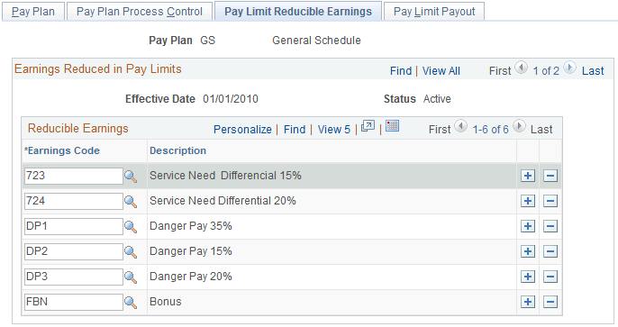

Pay Limit Reducible Earnings Page
GVT_EARN_RE_USF
(USF) Define earnings that can be reduced when pay limits/caps are reached. If earnings are not defined here, earnings over the limits will not be reduced.
(USF) Use the Pay Limit Reducible Earnings (GVT_EARN_RE_USF) page to specify earnings codes of all earnings that are eligible for reduction if employee’s earning exceed pay cap/limit amounts.
Navigation:
Set Up HCM, and then Product Related, and then Payroll for North America, and then Compensation and Earnings, and then Pay Plan Table USF, and then Pay Limit Reducible Earnings
This example illustrates the fields and controls on the Pay Limit Reducible Earnings page.
All earnings that should be reduced must be defined on the Pay Limit Reducible Earnings page. If not defined here, the earnings will be paid even if they are over the limits.
Do not define regular pay on the Pay Limit Reducible Earnings page. Regular pay is not reducible per the regulations.
