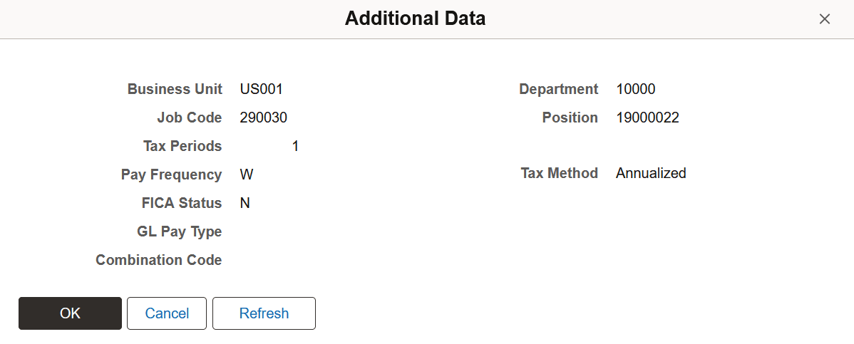

Additional Data Page
PAY_SHEET_ADD_S1
Alter default information, such as department and taxes.

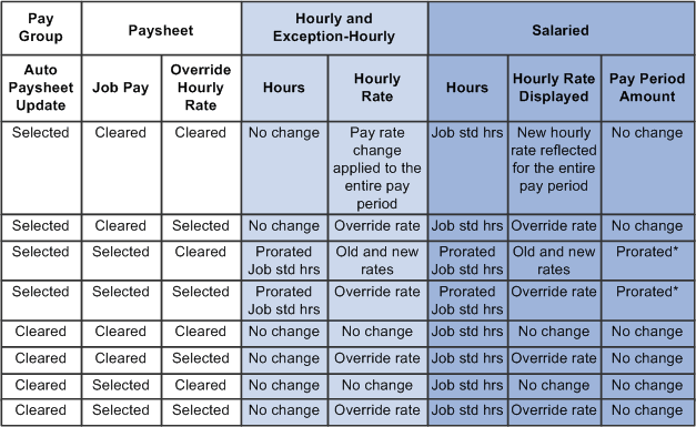

Pay Calculation Results
For the example scenario, this table describes the results of the Pay Calculation process for the various combinations of pay group and paysheet settings for each employee type:
This diagram shows a table that describes the results of the Pay Calculation process for the various combinations of pay group and paysheet settings for each employee type. .
Example pay calculation results for pay rate change for various combinations of pay group and paysheet settings for each employee type
* The system calculates prorated salary for salaried employees and prorated hours for hourly employees based on the proration rule set up on the Pay Group table. If the pay rate change is effective at the beginning of the pay period, proration is 100%.
The results shown in the table would apply to any preliminary calculation or final calculation performed after entering the job increase or paysheet update.

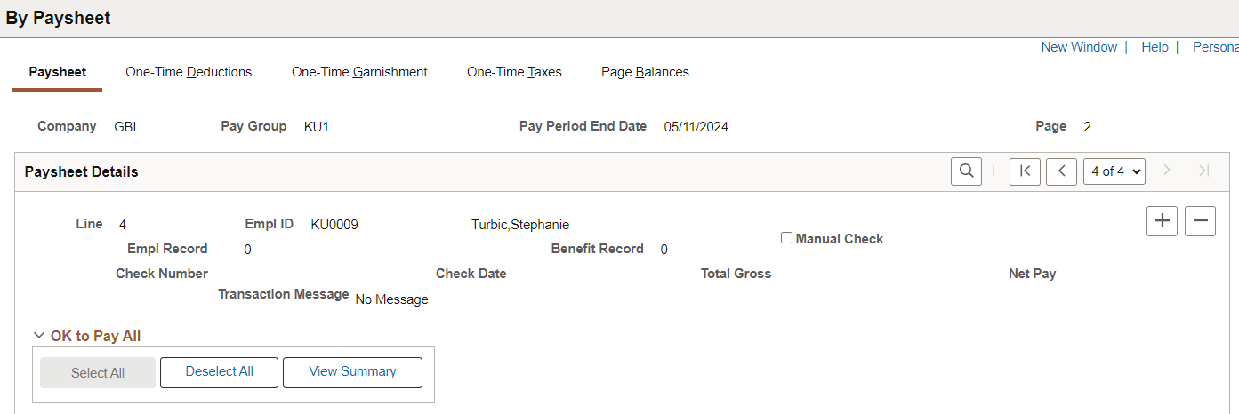

By Paysheet - Paysheet Page
Use the By Paysheet - Paysheet page (PAY_SHEET_ADD_S) to view and update the paysheet to affect the Pay Calculation process.
Navigation:
  • Payroll for North America, and then Payroll Processing USA, and then Update Paysheets, and then By Paysheet, and then Paysheet
  • Payroll for North America, and then Payroll Processing CAN, and then Update Paysheets, and then By Paysheet, and then Paysheet
  • Payroll for North America, and then Payroll Processing USF, and then Update Paysheets, and then By Paysheets, and then Paysheet
This example illustrates the fields and controls on the By Paysheet - Paysheet page (1 of 2).
This example illustrates the fields and controls on the By Paysheet - Paysheet page (2 of 2).
Normally, you run the Create Paysheet process before accessing this page, but it is not required. You can create one paysheet using pages in the By Paysheets component.
If one of the paylines on the paysheet is a reversal payline, you cannot add or delete paylines on the page.
Paysheet Details
Payline details are displayed in this area.
Field or Control Description
Manual Check
Select this check box to identify that the paysheet was prepared outside of the payroll system. If you select this check box, the Check Number, Check Date, Total Gross, and Net Pay fields become available for entry.
OK to Pay All
Select All
Select for the OK to Pay check box to be selected for all additional line numbers.
The button becomes read-only if all OK to Pay check boxes are already selected.
Note: The Select All button is not displayed, if the Display Deselect All Only option is selected on the Payroll for NA Installation Page.
Deselect All
Select for the OK to Pay check box to be cleared for all additional line numbers.
The button becomes read-only if all OK to Pay check boxes are already cleared.

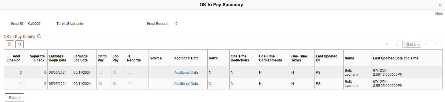

View Summary or OK to Pay Summary
Select to view the summary information of additional line numbers on the OK to Pay Summary Page.
The View Summary button is displayed, if both the Enable OK to Pay All and Enable OK to Pay Summary options are selected on the Payroll for NA Installation Page.
Alternatively, the OK to Pay Summary link is displayed, if only the Enable OK to Pay Summary option is selected.
The OK for Pay All feature works differently on paylines with retro earnings based on the Include Retro Earnings setup option. For more information, see Understanding OK to Pay All.

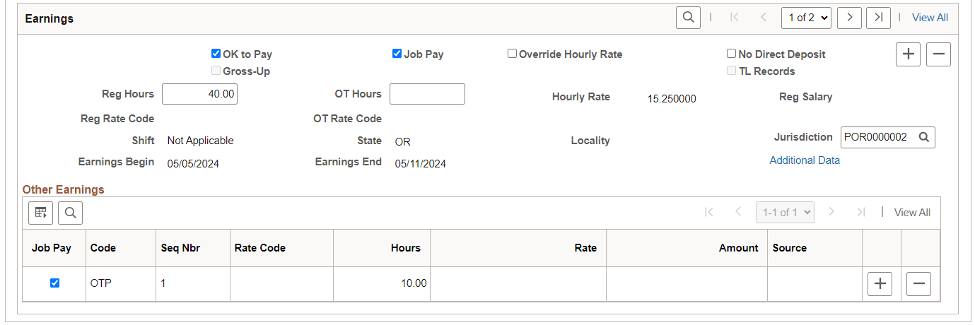

Earnings
OK to Pay
You must select this check box to calculate pay for this record. If you deselect the check box, the system bypasses the record and does not perform a calculation. Then, the Pay Confirmation process deletes this record. If you have an employee who is not receiving pay, select this check box to calculate deductions only.
The default depends on how you set up employee types for pay groups on the Pay Group Table - Process Control page.
Job Pay
If you select this option, the Pay Calculation process automatically compares paysheet data to the Job record if the Automatic Paysheet Update check box is selected on the Pay Group table and the Override Hourly Rate check box is deselected on the paysheet.
See Understanding Options for Job Pay Changes and Hourly Rate Overrides.
If you deselect this check box, it disappears from the page and the Reg Hours (regular hours for hourly employees), Reg Rate Code (regular rate code), OT Rate Code (overtime rate code), Hourly Rate, Reg Salary (regular salary), Earnings Begin, Earnings End, Shift, State, and Locality fields become available for entry, as do the fields on the Additional Data page.
The check box disappears from the page because the system assumes that you deselected it to enter data other than that specified in the Job record (to do a one-time override of the Job record). The system assumes that you don't want the next Pay Calculation process to replace your manual entries with the default Job Data.
Note: If the Automatic Paysheet Update check box is selected on the Pay Group table, the system calculates hourly and exception hourly employees using the corresponding rate from Job data for the hours, regardless of whether Job Pay is selected on the paysheet.
Select this check box to override an employee's current hourly rate for this pay.
If you select this check box, the Hourly Rate field becomes available for entry.
Note: The new rate replaces the rate from Job data, and is used in the payroll calculations for this particular paysheet for hourly and exception-hourly employees. Do no select the Override Hourly Rate option for salaried employees. If you select it for salaried employees, the paycheck displays the override rate, but the pay calculation uses the compensation rate in Job data.
Select a rate code to override the regular rate from the Job for overtime hours. To specify an overtime hours rate code, deselect the Job Pay check box and select Override Hourly Rate.
Hourly Rate and Reg Salary (regular salary)
The default comes from Job Data.
Shift
Select the appropriate shift associated with the earnings: N/A (not applicable), 1, 2, 3, Compressed, or Rotating. The default comes from Job Data.
(USA) State
Select the work state associated with the earnings. The default comes from Job Data.
(USA) Locality
The system enters the work locality from the employee's tax distribution unless the employee lives and works in the same Indiana locality, in which case the system leaves the Locality field blank.
(USA) Jurisdiction
Enter the jurisdiction of the employee’s work location that has its own minimum wage setup. The system uses this information to identify the correct rate to use for payroll calculation where there are multiple minimum wage rates within the state.
The system prepopulates the default jurisdiction (if found) based on the jurisdiction minimum wage setup for the employee, locality, location and state. If the payline is created manually, it populates the default jurisdiction automatically after the state and locality are entered.
Note: If the employee works in different locations within the same pay period, and each location is associated to a different jurisdiction, the administrator needs to add additional payline(s) in the Earnings section and indicate the additional jurisdiction(s) that corresponds to the employee's work location in the pay period.
This field appears if the Minimum Wage Jurisdiction option is selected for the associated pay group on the Pay Group Table - Paysheets Page.
See Understanding Minimum Wages for Jurisdictions.
(CAN) Province
Select the work province associated with the earnings. The default comes from Job Data.
(CAN) El Period Correction (Employment Insurance period correction)
Select this check box to allocate the insurable earnings and hours for the pay corrections to the prior pay periods for which they are paid (not the pay periods in which they are paid).
Note: When you load prior period time from Time and Labor, you must distinguish between pay adjustments and pay corrections. Select this option only for pay corrections.
Earnings Begin and Earnings End
The default dates come from the pay calendar (Job Data for prorated pay). Select pay calendar begin and end dates for this payline, or split dates if a change took place mid-period. You can also enter a prior or future period, and the system automatically obtains the appropriate rate for that period.
If you add a prior period payline for an earnings (such as REG) that contributes to a special accumulator when there is an existing payline for a companion earnings based on the special accumulator (such as SHF), you must change the begin and end dates for the companion earnings payline (SHF) to cover both the prior and current periods of the special accumulator earnings (REG).
Note: The system automatically creates these dates, based on the pay calendar for the current pay period. Only enter them if the paysheet is used to record a manual check or to enter time for a prior or future pay period.
Additional Data
Select to view additional information of the payline on the Additional Data Page.
Other Earnings
Information in this group box can come from the Create Paysheet process, additional pay data, or from loading transactions via the Load Paysheets process. You enter additional other earnings by adding rows.
If you want the earnings in the Other Earnings section of the paysheet to be distributed according to automatic tax distribution, you must set up and add the earnings as additional pay (either manually or through an interface) before paysheet creation. If you add the earnings directly to the payline, the system does not apply automatic tax distribution.
Earnings based on special accumulators are calculated depending on the paysheet's earnings begin and end dates. This is important to remember when you add such an earning for a prior period.
For example, Shift (SHF) is based on the special accumulator to which REG contributes. The system uses the paysheet begin and end dates entered for SHF to determine the REG amount to be used to calculate SHF. The paysheet shows two rows for REG:
  • First row: current pay period (February 15 – February 28).
  • Second row: previous pay period (February 1 – February 14).
When you add a payline and enter SHF as other earnings, the earnings begin and end dates must include both periods of REG—the current pay period as well as the previous pay period. In this example, the earnings begin date should be February 1 and the earnings end date should be February 28. With this setup, the system calculates SHF for both the current and previous pay periods.
(USF) The Other Earnings group box can contain awards and bonuses or other earnings codes designated on the Compensation page of the Personnel Action Request.
Code
Enter the earnings code for the other earnings.
Seq Nbr (sequence number)
The sequence number on the By Paysheet - Paysheet page corresponds to the additional sequence number on the Create Additional Pay page. The system does not require you to enter a sequence number, but if you don't, the system does not update the employee's current goal balance on the Create Additional Pay page when you run the Pay Confirmation process.
Rate Code
Enter the rate that you want to pay for the earnings.
If you leave the rate blank, the system uses the rate in Job data if the Automatic Paysheet Update check box is selected on the Pay Group table. If the Automatic Paysheet Update check box is not selected, the system uses the Hourly Rate on the payline.
Hours and Rate, or Amount
If the earnings is to be calculated by number of hours and hourly rate, enter that information.
If the earnings is to be paid in a lump sum amount, enter the amount. If the selected earnings is a flat amount payment type, the system displays the flat amount defined for the earnings code.
Source
Displays the source of the paysheet data: RP (rapid paysheets), AM (Absence Management), ER (Talent Acquisition Manager), EX (Expenses), IM (Sales Incentive Management), ST (Stock Administration - Options and ESPP), SP (Stock Administration - ESPP refunds), WI (Stock Administration - What-If), VC (Administer Variable Compensation), and OT (other third-party sources). If you create additional O% codes to support multiple third-party sources, those codes appear for the associated transactions.
Note: IM (Sales Incentive Management) is no longer supported.
When the source is AM, the paysheet data that comes from PeopleSoft Absence Management is not editable.
This field is blank for paysheets that were loaded with releases prior to PeopleSoft Payroll for North America 9.1.
Note: If you load transactions from multiple sources at once, the system consolidates transactions. In this situation, the source code reflects the source of the last contributing source that was processed.
Use the OK to Pay Summary page (PAY_SHEET_OK_SUM) to view summary information of paylines and additional lines.
Navigation:
  • Select the View Summary button or the OK to Pay Summary link on the By Paysheet - Paysheet page.
  • Select the View Summary button or the OK to Pay Summary link on the By Payline - Payline page.
  • Select the View Summary button or the OK to Pay Summary link on the By Payline Security - Payline or Payline Earns (Acct) Security page.
This example illustrates the fields and controls on the OK to Pay Summary page.
The OK to Pay All Details section lists the summary information of the payline's additional line numbers. For example, if the OK to Pay check box is either selected or cleared in any line, the update is indicated in this section, along with the user, date, and time of the update.
Additional Data
Last Updated By, Name, and Last Updated Date and Time
Displays the ID and name of the user who updated the OK to Pay field, and the date and time of the update. These are audit fields that are used for tracking the OK To Pay field only. Other fields in the OK to Pay Details section are informational only and are not tracked by the audit fields.
Use the Additional Data page (PAY_SHEET_ADD_S1) to view additional information of the payline, such as department and taxes.
Navigation:
  • Select the Additional Data link on the By Paysheet - Paysheet or By Payline - Payline page.
  • Select the Additional Data link on the OK to Pay Summary page.
This example illustrates the fields and controls on the Additional Data page.
The fields on this page are editable only if you deselected the Job Pay check box on the By Paysheet - Paysheet page. Changes to any information on this page might require that you insert an additional payline if the changes do not apply to the entire period covered by the begin and end dates on the payline.
Unless otherwise noted, default values for these fields come from the Job Data.
Important:
The Additional Data page is read-only when accessed from the OK to Pay Summary page.
Tax Periods and Pay Frequency
The default number of tax periods is 1. The default frequency comes from the pay group. Do not change it unless the payline contains only other earnings (no regular pay).
Note: The Tax Periods field and the Pay Frequency field work together on paysheets to determine how to tax earnings. The tax period refers to how many pay periods this earnings payment covers, and the frequency refers to how often the employee is paid during the year. Normally, use the paysheet defaults for the taxing period and frequency. However, you might change the way you tax earnings in some cases, such as when earnings cover a period of time longer than a standard pay period.
The Tax Periods field can be used in conjunction with the annualized tax method when you want to pay an employee for more than one regular pay period on the same check. For example, a weekly-paid employee is going on vacation for three weeks, and you want to pay the employee his current regular pay plus three weeks of vacation pay in advance. By setting the Tax Periods field to 4, you're indicating that this check represents pay for four regular payroll periods, and withholding taxes will be calculated correctly as if the employee had received four separate regular weekly wage payments.
(CAN) The Tax Periods field is also used in conjunction with the cumulative wages method for calculating withholding tax. When using the cumulative wages tax method, enter in the Tax Periods field the number of payroll periods that have already occurred in the calendar year, including the current payroll period.
Note: (CAN) For Canadian customers, the Pay Frequency field is display-only, and you cannot override it. This maintains the integrity of the application of Canada Pension Plan (CPP) exemptions. The default comes from Job Data.
Tax Method
Select the tax method. The default comes from the paysheet.
Note: This field works together with the Tax Periods field to determine how to tax earnings.
Note: For all tax methods other than Specified on Paysheet, the system uses the tax method specified for the earnings code on the Earnings table, regardless of the selection in this field. You can override the tax method only when it is set up as Specified on Paysheet.
FICA Status (Federal Insurance Contributions Act status)
Select E (exempt from OASDI and Medicare), H (exempt from employer FICA, J (exempt from employee FICA, K (exempt from employee and employer FICA, M (Medicare only), or N (subject to OASDI and Medicare). The default comes from Job Data, but can be overridden at the payline level.
See Also PeopleSoft Human Resources Administer Workforce: Payroll Page.
(E&G) Annual Tax Periods
Indicates the number of tax periods for contract pay employees who are paid over less than one year. The system calculates this field from the dates on the Contract Pay page and uses it to annualize taxable gross for contract pay employees.
GL Pay Type (general ledger pay type) and Combination Code
Enter the type and code for the PeopleSoft General Ledger account to which the system charges salaries and wages.
