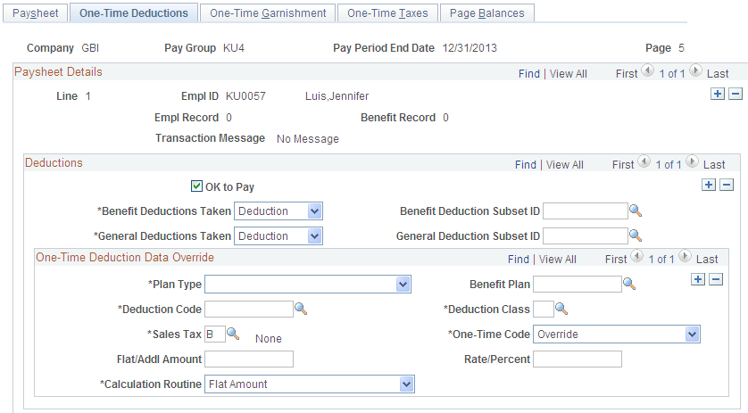

By Paysheet - One-Time Deductions Page
Use the By Paysheet - One-Time Deductions page (PAY_SHEET_ADD_D) to enter a one-time deduction to take in the current pay period only, override an existing deduction, increase an existing deduction, refund a deduction amount, or increase or decrease an arrears payback.
Navigation:
  • Payroll for North America, and then Payroll Processing USA, and then Update Paysheets, and then By Paysheet, and then One-Time Deductions
  • Payroll for North America, and then Payroll Processing CAN, and then Update Paysheets, and then By Paysheet, and then One-Time Deductions
  • Payroll for North America, and then Payroll Processing USF, and then Update Paysheets, and then By Paysheets, and then One-Time Deductions
This example illustrates the fields and controls on the By Paysheet - One-Time Deductions page.
Deductions
Field or Control Description
OK to Pay
The default comes from the paysheet.
Benefit Deductions Taken
During the Create Paysheet process, the initial value comes from the deduction override evaluation processing. When a paysheet is manually entered, the initial value comes from the pay calendar. You can override it after the paysheet is created. Values include:
  • None: Select to specify no benefit deductions.
  • Deduction: Select to have the Deduction table govern benefit deductions.
  • Subset: Select this value if you want to use a specified benefit deduction subset. If you select this value, you must specify the subset in the Benefit Deduction Subset ID field.
General Deductions Taken
  • None: Select to specify no general deductions.
  • Deduction: Select to have the Deduction table govern general deductions.
  • Subset: Select this value if you want to use a specified general deduction subset. If you select this value, you must specify the subset in the General Deduction Subset ID field.
One-Time Deduction Data Override
Important:
For deduction overrides to be computed properly, select Deduction or None for the Benefits Deduction Taken or General Deductions Taken field. The system does not consider the deduction override information in the calculation if the Subset value is selected.
Deduction Code and Deduction Class
The deduction code must match the code for the deduction type that you are adjusting. To create a one-time override for both the 401(k) before-tax and after-tax deductions, create two entries: one for a deduction classification of after-tax, the other for before-tax.
(CAN) Sales Tax
For one-time deductions that attract sales tax (provincial sales tax on insurance, provincial sales tax, provincial premium tax, Quebec sales tax on insurance, Quebec sales tax, Quebec provincial tax, goods and services tax, or harmonized sales tax), you do not need to enter the sales tax classification here. The Pay Calculation process generates the sales tax amounts. If you enter a one-time sales tax deduction only, the system processes it accordingly.
One-Time Code
Select from the following:
  • Addition: Select this value to add the calculated amount specified on this page to the regular calculation.
  • Arrears Payback: Select this value to ignore standard arrears processing and calculate arrears to be processed as specified on this page.
    The system limits the arrears payback to the amount that you specify in the Flat/Addl Amt field. For example, if an employee has an arrears balance of 1000 CAD and you specify a one-time arrears payback deduction of 400 CAD, the system takes only up to 400 CAD for that pay period.
    Note: The One-Time Arrears Payback feature is not for situations when an employee gives you a check to pay back an owed arrears amount.
  • Override: Select this value to ignore the regular calculation and replace it with the calculation specified on this page.
    To stop a deduction, use this option, set the Calculation Routine to Flat Amount, and leave the Flat/Addl Amt field blank. Apply the same technique to stop an arrears payback one time.
  • Refund: Select this value to calculate the deduction normally, according to Deduction table rules, and apply the refund amount.
    For example, if the normal deduction is 100 USD and you entered a one-time deduction refund of 75 USD, the resulting deduction amount is 25 USD. If the normal deduction is 0 USD (the employee does not currently have this deduction), the system refunds the amount that is entered here.
Calculation Routine, Flat/Addl Amt (flat or additional amount) and Rate/Percent
Define how to calculate the deduction. The available options include Calculated by Salary System, Default to Deduction Table, Flat Amount, Percentage of Federal Gross, Percent of Net Pay, Percent of Special Earnings, Percent of Total Gross, Percentage, Rate x Hours Worked, Rate x Special Hours, Rate x Total Hours, or Special Deduction Calculation.
If you select Flat Amount, enter the amount in the Flat/Addl Amt field.
If you select any of the options that use a percentage or a rate, enter the percentage or rate in the Rate/Percent field.
If you select a calculation routine that uses a rate or percent, you can enter an additional flat dollar amount to deduct.
