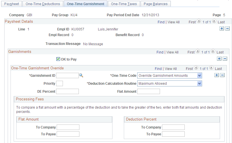

This example illustrates the fields and controls on the By Paysheet - One-Time Garnishment page.
One-Time Garnishment Override
Field or Control Description
Garnishment ID
Select the Garnishment Specification Data record to override.
Priority
Enter the priority to override from the Garnishment Spec Data pages.
Do Not Apply Exemption
This check box is visible only if a garnishment tax levy has been defined for the employee on the Garnishment Spec Data pages. Use this check box when processing additional checks so that the exemption amount, which is automatically applied to regular checks, is not also applied to the additional checks.
Selecting the check box prevents the system from applying the exemption amount to this check. When it is selected, the batch process does not calculate any exemption amount for the tax levy garnishment, and a message appears on the Garnishment Detail page to indicate that the exemption was overwritten on the payline for this check.
One-Time Code
Select from these values:
  • Override Garnishment Amounts: Select this value to ignore the regular calculation and replace it with the calculation specified on this page.
  • Refund Garnishment Amount: Select this value to refund a garnishment amount.
    Enter the amount to refund to the employee. The system does not calculate the refund amount.
  • Suspend Garnishment: Select this value to stop the garnishment deduction for the current pay period.
Note: If you override or refund this garnishment, the system uses all the calculation and processing fees fields on this page to calculate the garnishment, even if they are blank. For example, if you leave the fields in the Processing Fees fields blank, the system treats them as though you entered 0.
Deduction Calculation Routine
Select the deduction calculation routine for the one-time garnishment:
  • % DE + Amount (percent of disposable earnings plus amount): Deduction = percent of disposable earnings + flat amount.
  • % Gross + Amount (percent of gross plus amount): Deduction = percent of earnings subject to garnishment + flat amount.
  • Greater of % DE or Amount (greater of percent of disposable earnings or amount): Deduction = greater of a percent of disposable earnings OR a flat amount.
  • Greater of % Grs or Amount (greater of percent of gross or amount): Deduction = greater of a percent of earnings subject to garnishment OR a flat amount.
  • Maximum Allowed: Deduction = disposable earnings – exemptions.
  • No exempt; % of Gross (no exemptions; percent of gross): (USA) Allows no exemptions and calculates the deduction as a percent of the gross amount subject to garnishment. This value is for U.S. one-time support order garnishment overrides only. The system issues an error message if you select it for Canadian deductions.
  • No exempt; % DE + Amt (no exemptions; percent of disposable earnings plus amount): (USA) Allows no exemptions and calculates the deduction as a percent of disposable earnings + flat amount. This value is for U.S. one-time support order garnishment overrides only. The system issues an error message if you select it for Canadian deductions.
DE Percent (disposable earnings percent)
Enter the percent of disposable earnings to use in the override calculation.
Flat Amount
Enter the flat amount to use in the override calculation.
Processing Fees
Use this group box to override the normal processing fees. If the order requires you to withhold the greater of the percent of the garnishment amount or a flat amount, enter both; the system withholds the greater of the two.
