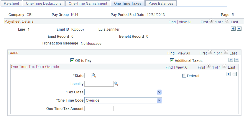

By Paysheet - One-Time Taxes Page
Use the By Paysheet - One-Time Taxes page (PAY_SHEET_ADD_O) to review one-time tax considerations for a single employee, override an existing tax, increase an existing tax, and refund a tax amount.

This example illustrates the fields and controls on the By Paysheet - One-Time Taxes page.
One-Time Taxes page
Taxes
Field or Control Description
Additional Taxes
This check box determines whether the system takes, on an individual check, the additional withholding specified on the Federal Tax Data 1 page, State Tax Data 1 page, and the Canadian Income Tax Data pages.
By default, this check box is selected. If you do not want to take the employee's regular additional taxes out of a check, deselect this check box.
