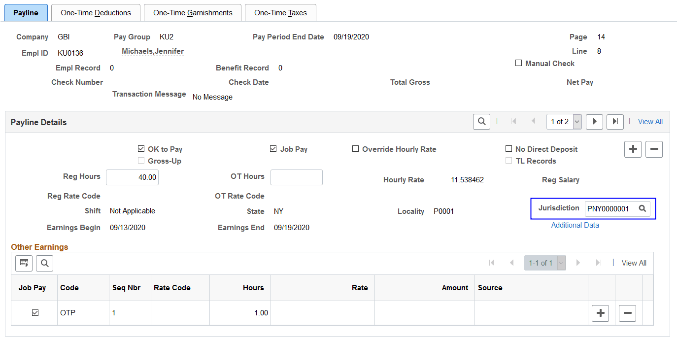

The default jurisdiction, if found, is populated on employee’s payline; the Payroll administrator can manually update the value as needed.
This example illustrates the default jurisdiction that is populated for an employee on a payline.
Default jurisdiction on employee's payline
The jurisdiction value is also available on pages where payline information is displayed, for example, Paysheet pages, Paycheck Earnings pages, Review FLSA Pay Data page, Create Online Check page, and so on.

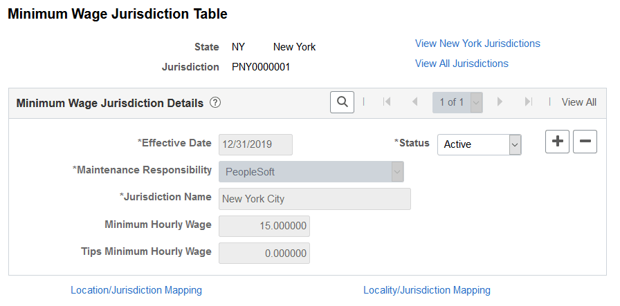

Minimum Wage Jurisdiction Table Page
Use the Minimum Wage Jurisdiction Table page (PY_JUR_MW) to define minimum wage information for jurisdictions by state.
Navigation:
Set Up HCM, and then Product Related, and then Payroll for North America, and then Federal/State Taxes, and then Min Wage Jurisdiction Table, and then Minimum Wage Jurisdiction Table
This example illustrates the fields and controls on the Minimum Wage Jurisdiction Table page.
Use this section to set up minimum wage data for state jurisdictions that observe different minimum wage rates than their state rate.
Field or Control Description
State and Jurisdiction
Displays the state and the code of the jurisdiction. State codes prefixed with $ are not available for selection.
A jurisdiction can be a city, municipality, county, region, or any local government body in a state that establishes and administers minimum wage legislation.
Note: PeopleSoft-delivered jurisdiction codes are prefixed with the letter “P”. Do not use this prefix when creating customer-maintained codes. If the same minimum wage information for a jurisdiction exists in a PeopleSoft row and a customer row for the same effective date, the system uses the customer row for minimum wage processing.

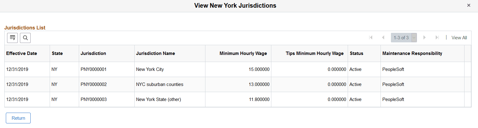

View <US State> Jurisdictions
Click to access the View <US State> Jurisdictions Page to review minimum wage information entered for jurisdictions of the specified state.
View All Jurisdictions
Click to access the View All Jurisdictions Page to review minimum wage information entered for all jurisdictions.
Maintenance Responsibility
Displays:
PeopleSoft if the row is delivered by PeopleSoft. All fields, except for the Status field, are not editable.
Customer if the row is added by a customer.
Minimum Hourly Wage
Enter the minimum wage rate for the jurisdiction. The system considers the value to be zero if the field is blank.
Tips Minimum Hourly Wage
This field value is informational only.
Location/Jurisdiction Mapping
Click to access the Location/Jurisdiction Mapping Page to map locations to minimum wage jurisdiction.
Locality/Jurisdiction Mapping
Click to access the Locality/Jurisdiction Mapping Page to map localities to minimum wage jurisdiction.
Use the View <US State> Jurisdictions page (PY_JUR_ALL_SEC) to review minimum wage information entered for jurisdictions of the specified state.
Navigation:
Click the View <US State> Jurisdictions link on the Minimum Wage Jurisdiction Table page.
This example illustrates the fields and controls on the View <US State> Jurisdictions page.
Review a list of minimum wage data for jurisdictions of the specified state (both current and future-dated rows). You can download the information to an Excel file if needed.

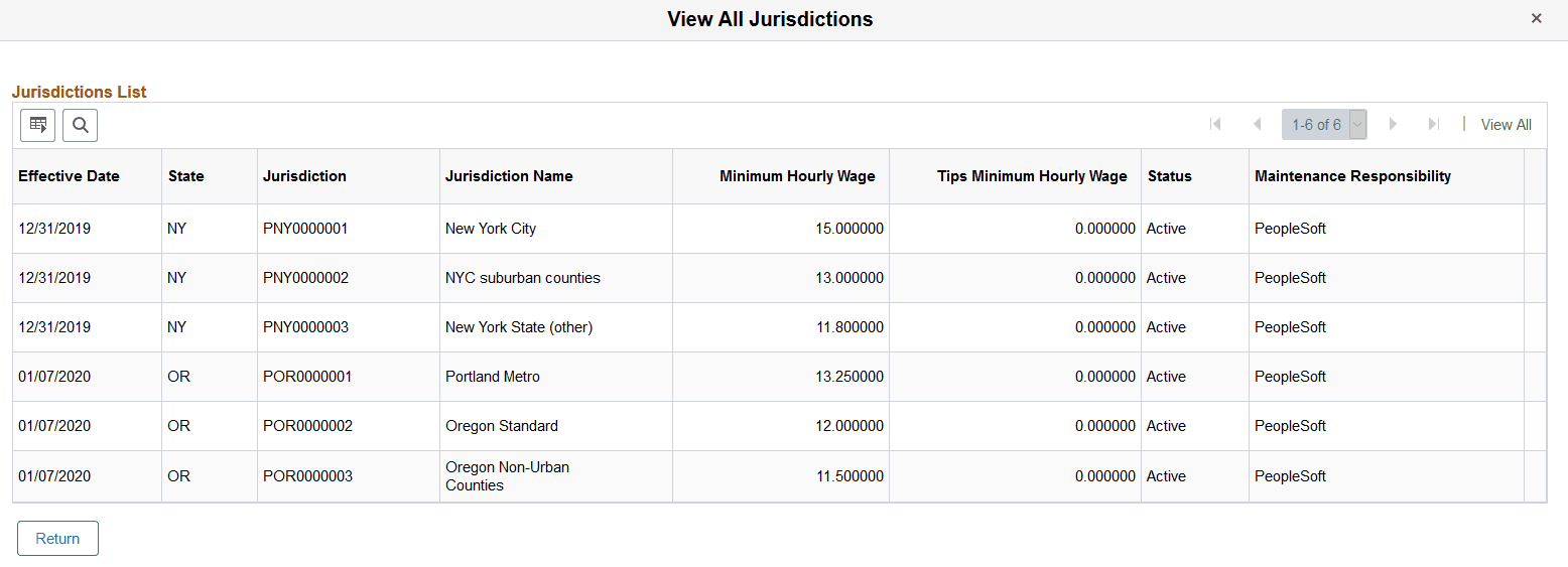

Use the View All Jurisdictions page (PY_JUR_ALL_SEC) to review minimum wage information entered for all jurisdictions.
Navigation:
Click the View All Jurisdictions link on the Minimum Wage Jurisdiction Table page.
This example illustrates the fields and controls on the View All Jurisdictions page.
Review a list of minimum wage data for all jurisdictions in the system (both current and future-dated rows). You can download the information to an Excel file if needed.

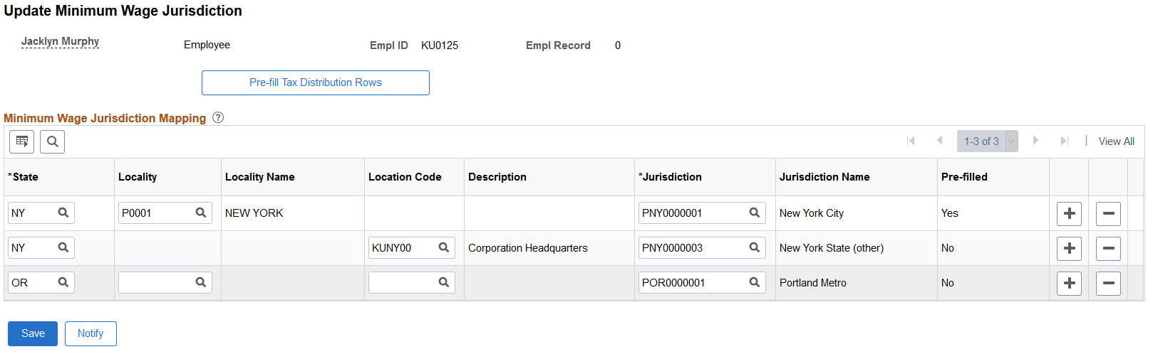

Update Minimum Wage Jurisdiction Page
Use the Update Minimum Wage Jurisdiction page (PY_JUR_MW_EMPDATA) to map employees to jurisdictions using localities, locations, and state.
Navigation:
Payroll for North America, and then Employee Pay Data USA, and then Update Min Wage Jurisdiction, and then Update Minimum Wage Jurisdiction
This example illustrates the fields and controls on the Update Minimum Wage Jurisdiction page.
Use this page to map a default jurisdiction to a state and locality combination, a state and location combination, or a state for the employee.
It is the customer’s responsibility to maintain the data on the Update Minimum Wage Jurisdiction page. The system does not update this page automatically based on Job Data Location, Tax Location or employee tax data changes.
Pre-fill Tax Distribution Rows
Click this button to prepopulate current tax distribution rows for the employee. The system removes all prefilled rows in the grid, and populates it with current rows from tax distribution again. It populates only rows for states that are set up to support minimum wage for jurisdictions. Future-dated information from the Tax Distribution table is not included.
Each added row displays the state or state and locality, which are editable. The Pre-filled field is set to Yes and it is read-only.
State
Specify the US state for the jurisdiction mapping.
Only states with minimum wage setup for jurisdictions are available for selection.
Locality or Location Code
Specify a locality or a location code for the jurisdiction mapping.
The system filters the list of available localities by the specified state, and the list of available location codes by the setID that is associated with the employee in job data.
Jurisdiction
Specify a jurisdiction for the specified state and locality, state and location, or state for the employee.
The system filters the list of available jurisdictions by the specified state.
