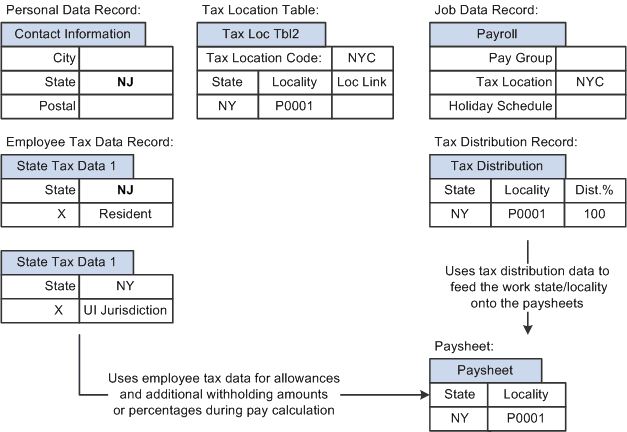

This diagram illustrates how the system enters tax data from the Personal Data Record, Tax Location Table, Job Data Record, Employee Tax Data Record, and the Tax Distribution Record automatically and how that data is used on paysheets:
Illustration of how system pulls in information from various personal and tax data records automatically and uses that information on the paysheet

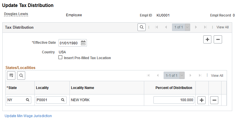

Update Tax Distribution Page
(USA, USF) Use the Update Tax Distribution page (TAX_DISTRIBUTION) to enter the employees work state or localities percentages for US employees.
This information will be used in the Create Paysheet Process and create a payline for each state/locality combination.
Navigation:
  • Payroll for North America, and then Employee Pay Data USA, and then Tax Information, and then Update Tax Distribution, and then Update Tax Distribution
  • Payroll for North America, and then Employee Pay Data USF, and then Tax Information, and then Update Tax Distribution, and then Update Tax Distribution
This example illustrates the fields and controls on the Update Tax Distribution page for the U.S.
Update Tax Distribution page (USA)
Tax Distribution
Field or Control Description
Insert Pre-filled Tax Location
Select to automatically populate this record using the tax location ID specified on the employee's Job Data record and the corresponding information on the Tax Location Table.

States/Localities
Percent of Distribution
Specify the percent of the employee's time or earnings to apply to selected state/locality in the State and Locality fields.
Note: This tax distribution is for work location taxes only and does not include resident-based taxes.
Every employee must have at least one Tax Distribution record. State/locality percentages must total 100 percent. If the employee works in one state or locality, the distribution percent should be 100 for that row. However, if an employee is hired or transferred into a tax location that represents more than one state or locality, you must distribute taxes among the different states or localities. All the percentages must total 100. You cannot save the page until the distribution percent values total 100.
Note: You can distribute taxes for salaried and exempt hourly employees only. If you select the Use Total Wages for Multi-State Employee check box on the Federal Tax Data 2 page, the system uses 100 percent of the employee's wages to determine the tax rate.
