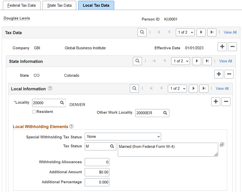

Local Tax Data Page
TAX_DATA5
(USA, USF) Enter employee tax data for each locality in which an employee lives or works.

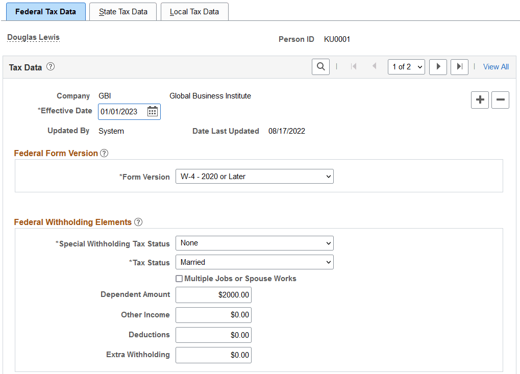

Understanding Federal Form W-4 Versions
Payroll for North America supports these Form W-4 versions:
  • W-4 - 2020 or Later: For employees who are either hired, or wish to make withholding adjustments on or after January 1, 2020.
    With Form W-4 (2020), allowances are no longer used to calculate federal income tax withholding.

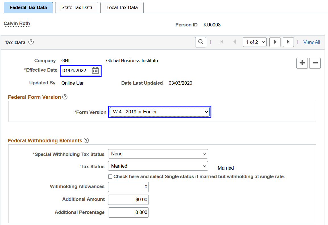

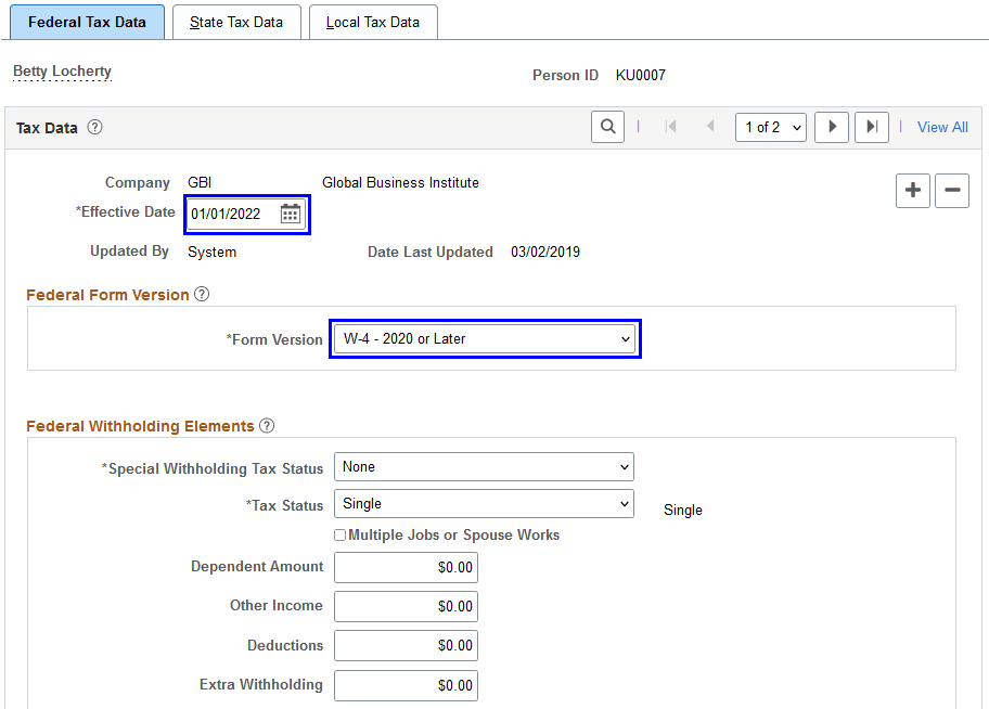

Example: Updating Federal, State and Local Tax Data Effective 01/01/2022 or Later
  1. In this example, an employee requests an update to the federal, state and local tax data, effective 01/01/2022. The employee is currently set up with federal form version W-4 - 2019 or Earlier.
    To update the tax data for this employee, insert a new row effective 01/01/2022. In this row, change the federal form version to W-4 - 2020 or Later. Complete the other fields as indicated on the Form W-4 2020. Make the changes to the state and local tax pages as needed.
    This example displays the new Form W-4 version selection when updating the federal, state and local tax data for an employee on or after January 1, 2020 (January 1, 2022 in this example) on the Federal Tax Data page.
    Updating federal and state tax data on or after January 1, 2020 (January 1, 2022 in this example) for an employee

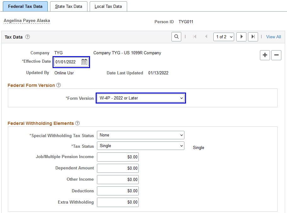

  2. In this example, a payee in a 1099-R company requests an update to the federal, state and local tax data, effective 01/01/2022. The payee is currently set up with federal form version W-4 - 2019 or Earlier.
    To update the tax data for this payee, insert a new row effective 01/01/2022. In this row, change the federal form version to the appropriate value, W-4P - 2022 or Later (or W-4R - 2022 or Later). Complete the other fields as indicated on the Form W-4P 2022 (or W-4R 2022). Make the changes to the state and local tax pages as needed.
    This example displays the new Form W-4 version selection when updating the federal, state and local tax data for a payee on or after January 1, 2022 on the Federal Tax Data page.
    Updating federal and state tax data on or after January 1, 2022 for a payee

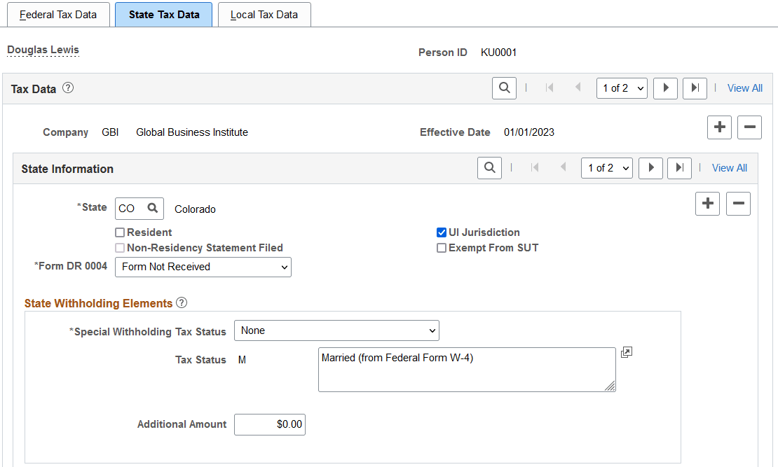

Example: Updating State Tax Data Effective 01/01/2020 or Later
In this example, an employee requests an update of the state allowances, effective 01/01/2022. The employee did not submit a Form W-4 2020, therefore; there are no changes to the Federal Tax Data page.
To update the tax data for this employee, insert a new row effective 01/01/2022. In this row, make the changes on the State Tax Data page as needed. Do not make any changes on the Federal Tax Data page.
If you change the W-4 version from W-4 - 2019 or Earlier to W-4 - 2020 or Later, the calculation of the federal taxes is changed inadvertently. The federal taxes will be calculated on the Form W-4 2020 elections, which is not valid in this scenario.
This example displays the unchanged Form W-4 version selection when updating state tax data on or after January 1, 2020 (January 1, 2022 in this example) on the Federal Tax Data page.
Updating state tax data on or after January 1, 2020 (January 1, 2022 in this example). No changes on the Federal Tax Data page.

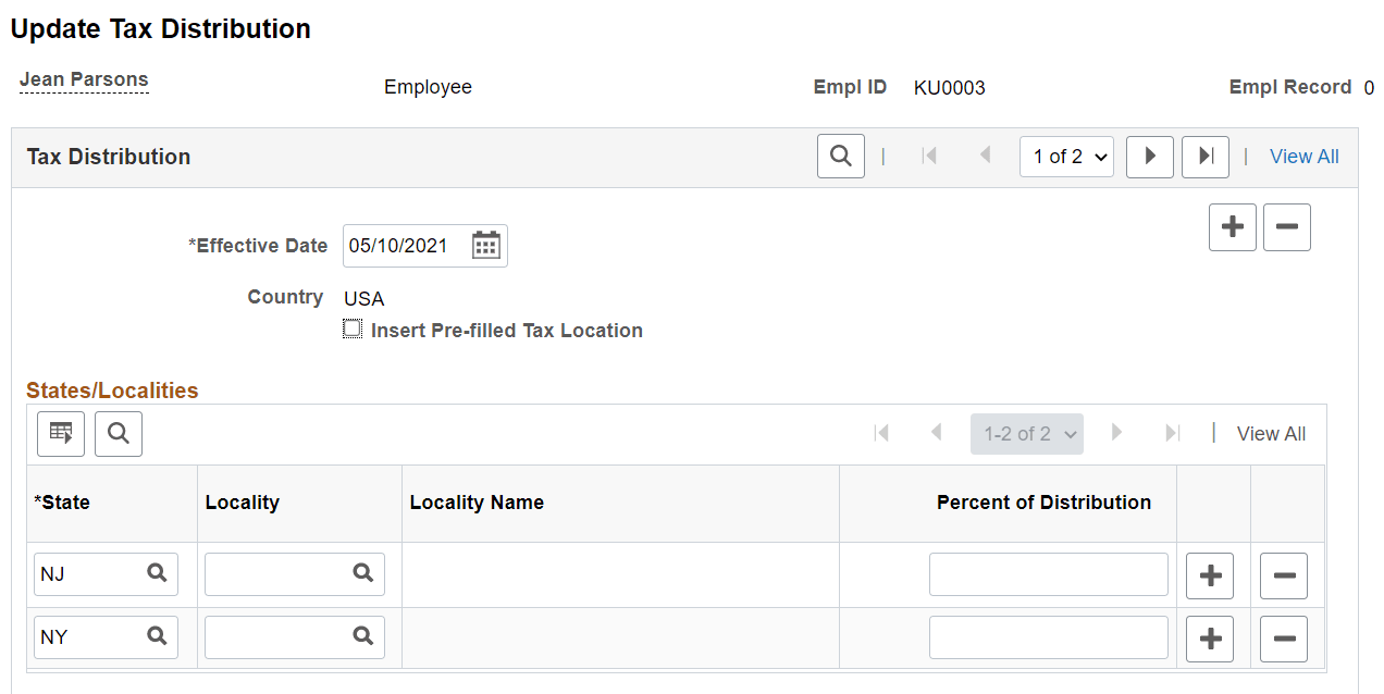

  2. Add a row for the OR state and 23850 locality on the Update Tax Distribution Page.
    When the paysheet is created, the 23850 locality is displayed on the payline for the employee.

Local Tax Data
The Other Work Locality field on the Local Tax Data table is used where one or more taxes apply to a single location. A school district within a city within a county is such an example. In this case, there would be one chain with three rows. Row one would have the school district as the locality and the city as a link; row two would have the city as the locality and the county as a link; and row three would have the county as the locality only.
The Other Work Locality field on the Local Tax Data table may also be used where one or more taxes apply to multiple locations. Several cities within a county is such an example. In this case, there could be several chains. There would be a separate row for each city with the county as the link. The county, however, would appear only once in the Locality field of a row without a link.

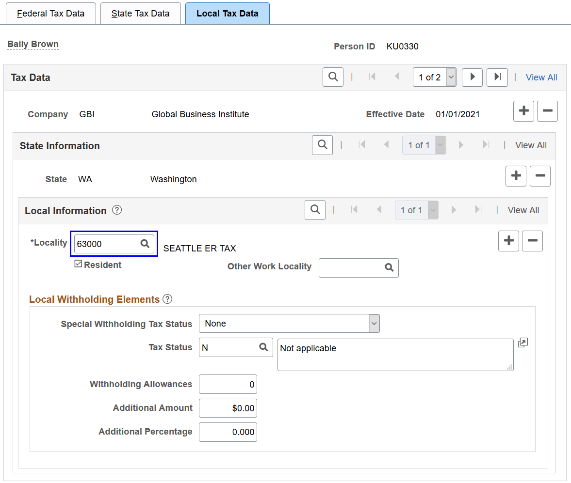

Understanding Seattle Payroll Expense Tax
The Seattle Payroll Expense Tax is a business excise tax applicable to businesses that are operating in Seattle.
The payroll expense tax is based on a business’s annual Seattle payroll expense attributable to employee annual compensation of $150,000 or more in the current year. A business must have at least $7 million in annual Seattle payroll in the prior calendar year to be subject to the tax.
Effective as of 01/01/2021, the employee's annual compensation is $150,000. This amount is stored on the State Tax Table entry for State = ZM and is subject to change in future years.
The payroll expense tax is levied on employers, not on employees.
Payroll for North America supports the Primarily Assigned Method for determining compensation paid in Seattle to employees.
Tax Calculations
The Seattle payroll expense tax will be calculated for each employee that meets these conditions:
  • The State on the employee’s State Tax Data page = WA; and

To implement the Seattle payroll expense tax, you must set up each eligible employee’s Local Tax Data record for Locality 63000 on the Local Tax Data Page.
This example illustrates the local tax data setup for an eligible employee (ID: KU0330). To set up the local tax data record, add a new row with 01/01/2021 as the effective date on the Federal Tax Data page. Navigate to the Local Tax Data page and enter 63000 in the Locality field.
Setting up employee's local tax data for locality 63000 on Local Tax Data page
WARNING:
It is the customer's responsibility to set up employees with local tax data rows if the Seattle payroll expense tax should be calculated.
If the payroll expense tax should no longer be calculated for specific employees (for example, they do not live or work in Seattle anymore), you must remove their local tax data rows for locality 63000 from Employee Local Tax Data. The payroll expense tax will be calculated if the associated local tax data row exists, even if the employee is no longer working in Seattle.
Employee Tax Distribution
Do not add Locality 63000 to the Tax Distribution record where State = WA.

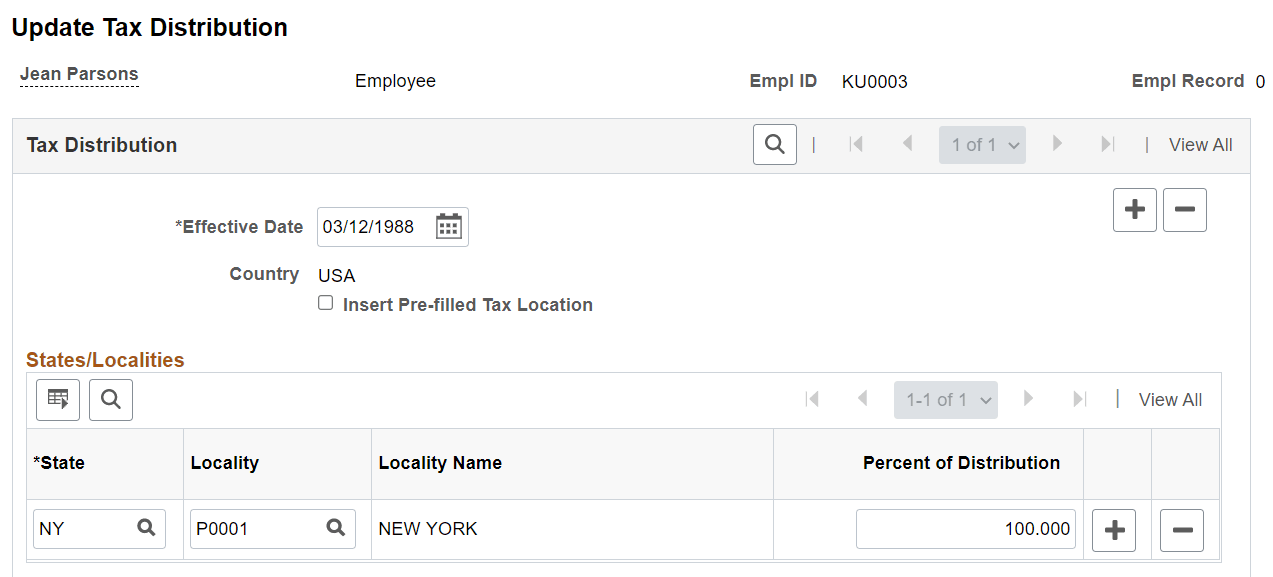

This example illustrates the Update Tax Distribution page for the employee who was working 100% in NY before the transfer to the new Tax Location.
Employee working 100% in NY state before transferring to new tax location
After the transfer, add a new effective-dated row and select the Insert Pre-Filled Tax Location check box on the Update Tax Distribution Page. NJ and NY will now be populated for the new row. Assign Percent of Distribution values and save the page.
This example illustrates the Update Tax Distribution page where both NJ and NY rows are displayed and distribution percentages need to be assigned.
Assign distribution percentages to states after transferring to new tax location
Understanding Resident Locality in Local Tax Data
Payroll for North America provides a functionality that creates employee federal, state, and provincial tax records automatically when one of these events occurs:
  • You hire an employee.
  • An employee has a job change requiring a new work tax location.
  • You add a concurrent job that requires a new work tax location for an employee.
  • You hire an employee from the Applicant Tracking System.
  • A person transfers to a new company.
When the Automatic Employee Tax Data option is selected on the Application Fundamentals: Product Specific Page, the system selects the Use State Residence for Local field on the same page automatically, which assumes that an employee is a resident of any local tax jurisdiction that happens to be located in the employee's state of residence. When this option is enabled, the system selects the Resident check box on the employee's Local Tax Data rows it creates for this functionality.
However, in the case where an employee has a job transfer in the same resident state, or has an additional job, the system clears the Resident check box in the newly added Local Tax Data rows, as described in these examples:
  1. Transfer from a tax location with no localities to a tax location with one or more localities.
    When JOB data is saved, new local tax rows are created.
    The Resident check box is not selected on the employee's Local Tax Data row for the new locals.
  2. Transfer from a tax location with one or more localities to a tax location with different localities, but in the same resident state. On the original local tax row, the Resident check box is selected.
    The Resident check box will remain selected on the original, existing local tax data rows.
  3. Transfer from a tax location with one or more localities to a tax location with different localities, but in the same resident state. On the original local tax row, the Resident check box is deselected.
    The Resident check box will remain deselected on the original, existing local tax data rows.
  4. An employee with multiple jobs is set up with a tax location with no localities in employee record 0. Add employment instance for employee record 1 in tax location with one or more localities.
  5. An employee with multiple jobs is set up with a tax location with one or more localities in employee record 0. Add employment instance for employee record 1 in tax location with one or more different localities. On the original local tax row, the Resident check box is selected.
  6. An employee with multiple jobs is set up with a tax location with one or more localities in employee record 0. Add employment instance for employee record 1 in tax location with one or more different localities. On the original local tax row, the Resident check box is deselected.

Effective Date
Note that the effective date on the Federal Tax Data page is not used to calculate federal income tax withholding. For example, an employee submitted a state W-4 that added a new row to employee tax data in 2020, but did not fill out a new Form W-4 for 2020 (no changes on the Federal Tax Data page for the same row). In this scenario, the system uses the old formula for 2019 to calculate federal income tax withholding.
If you wish to use the W-4 version for 2020 or later, enter an effective date that is on or after January 1, 2020, and select the W-4 - 2020 or Later version of Form W-4.

Federal Form Version
Select the appropriate Form W-4 version. The system determines the federal tax calculation to use to calculate the employee’s federal income tax withholding based on the version you select.
Field or Control Description
W-4 - 2020 or Later
Select when creating or inserting an employee tax data record that will include new or changed federal tax data from Federal Form W-4. The system calculates tax based on the Form W-4 2020 elections.
This option applies only to effective dates on or after 01/01/2020.
Leave this option unchanged (if it already exists) when creating or inserting an employee tax data record that will include only new or changed state tax data, local tax data, or both, for an employee who has not yet submitted Federal Form W-4 for tax year 2020 or later (or for a payee who has not submitted W-4P or W-4R for tax year 2022 or later). The system calculates tax based on the prior Form W-4, in which allowances are part of the calculation.
Note: (Applicable to effective dates 01/01/2022 or later) Do not select this form version for a payee. Select W-4P - 2022 or Later or W-4R - 2022 or Later as the appropriate form version.
Select when creating or inserting an employee tax data record that will include new or changed federal tax data from Federal Form W-4P.
This option applies only to effective dates on or after 01/01/2022 and becomes available if the payee is in a 1099-R company.

Multiple Jobs or Spouse Works
Select if the check box in line 2(c) of the employee’s Form W-4 is selected.
This field appears for form version W-4 - 2020 or Later.
This field becomes editable when the Special Withholding Tax Status field is set to None.
The system selects this field automatically when a lock-in letter is on file and the withholding rate is Higher withholding rate. Do not clear this field unless you select Standard withholding rate.

When a lock-in letter is on file, the other income amount can only be equal to or greater than the value in the Other Income field (lock-in letter).
Deductions
Enter the deduction amount in line 4(b) of the employee’s Form W-4 or payee's Form W-4P.
This field appears for form versions W-4 - 2020 or Later and W-4P - 2022 or Later.
This field becomes editable when the Special Withholding Tax Status field is set to None or Nonresident alien.
When a lock-in letter is on file, the deductions amount can only be equal to or less than the value in the Deductions field (lock-in letter).
Extra Withholding
Enter the extra withholding amount in line 4(c) of the employee’s Form W-4 or payee's Form W-4P.
This field appears if the selected form version is W-4 - 2020 or Later or W-4P - 2022 or Later.
This field becomes editable when the Special Withholding Tax Status field is not set to No taxable gross; no tax taken.
Leave the amount as $0 if the selected special withholding tax status is Maintain taxable gross. If federal income tax should not be withheld, do not enter an amount for extra withholding.
When a lock-in letter is on file, the extra withholding amount can only be equal to or greater than the value in the Additional Amount field (lock-in letter).
Payment Type
Select Distribution payments or Nonperiodic payments as the payment type.
This field appears for form version W-4R - 2022 or Later.
Percentage
Enter the number of percentage in line 2 of the payee's Form W-4R.
This field is not editable (value is 0) if the selected special withholding tax status is No taxable gross, no tax taken, regardless of payment type.
The minimum value is 10 if the selected special tax withholding tax status is Maintain taxable gross and the payment type is Nonperiodic payments.
The minimum value is 20 if the selected special tax withholding tax status is Maintain taxable gross and the payment type is Distribution payments.
The payee cannot request to have no tax withheld on distribution payments.
These fields appear when the W-4 - 2019 or Earlier option is selected.
Check here and select Single status if married but withholding at single rate
Select the appropriate tax status for federal withholding taxes as indicated on the employee's completed Form W-4.
If the employee has selected "Married, but withhold at higher Single rate" on Form W-4, you must select Single as the tax status and this check box. This setting results in the employee being reported with tax status W.
Note: If you select this check box, the tax status automatically becomes Single when you save.
Withholding Allowances
Enter the number of allowances that the employee claims for federal withholding tax purposes. This number should match the number on the employee's Form W-4.
Additional Amount and Additional Percentage
Use these fields to indicate that additional federal withholding taxes are to be taken. You can specify both an amount and a percentage, if appropriate. When you enter an additional percentage, the additional withholding is calculated by taking a percentage of the taxable wages.
The effect of this field depends on the option that you select in the Special Withholding Tax Status field.
See Special Withholding Tax Status.

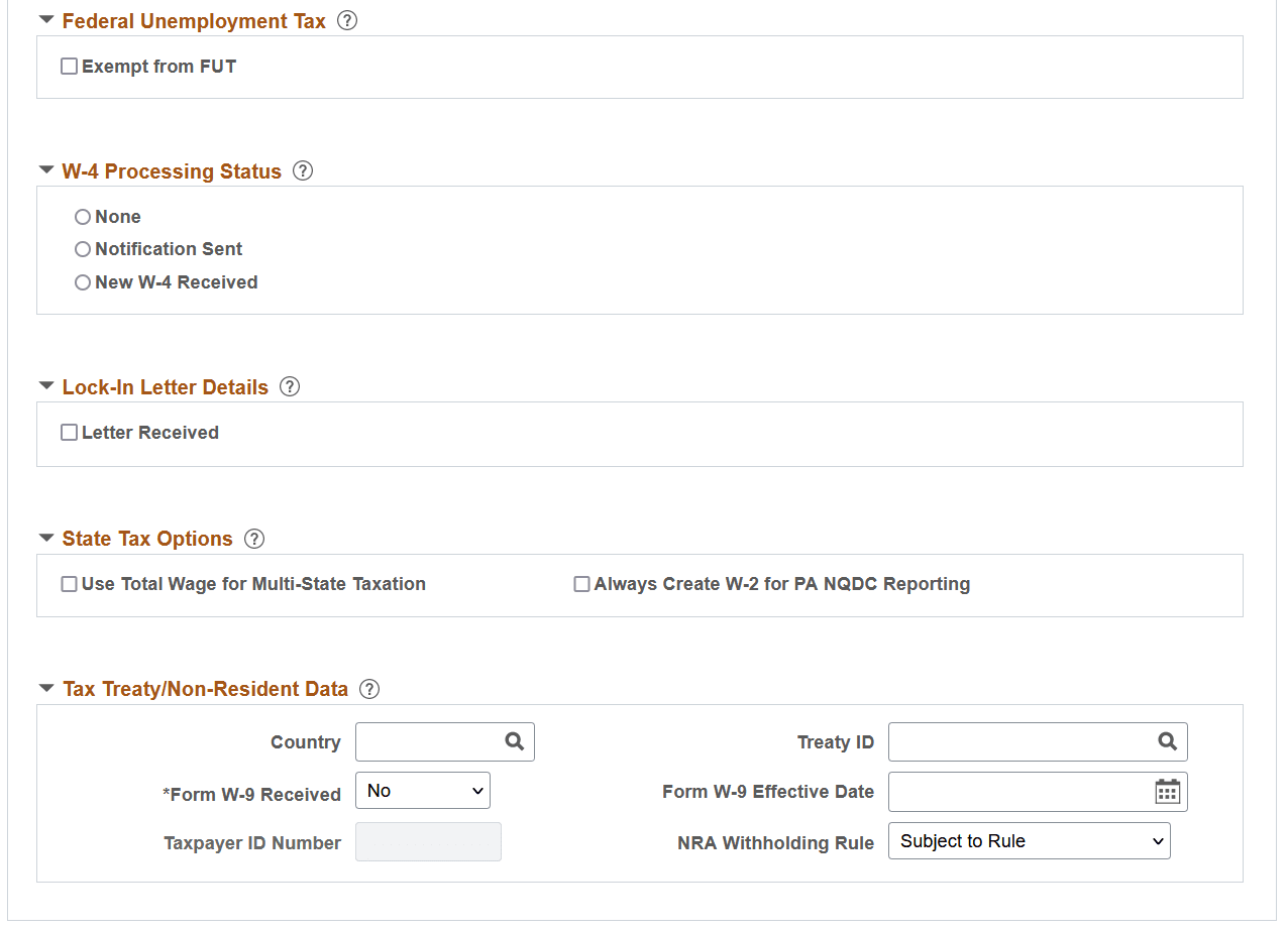

Federal Unemployment Tax
This section does not apply to the W-4P or W-4R form version.
Exempt from FUT
Select this check box if the employee is exempt from FUT (Federal Unemployment tax). The default value comes from the FICA/Tax Details (Federal Insurance Contributions Act/tax details) page. You can override the default from the Company table for an employee.
W-4 Processing Status
The system resets this indicator automatically when the employee's status is updated through the Determine W-4 Exempt Renewal Application Engine Process (PY_W4_EE) or the Reset W-4 Exempt List process (TAX103). You can also update this status manually.
See (USA) Processing Forms W-4.
None
Select this option if W-4 processing does not apply to the employee. This is the default value, which TAX103 resets automatically for those who fail to resubmit the W-4.
Notification Sent
Indicates that the employee has been notified to submit a new Form W-4. This option is set by PY_W4_EE or manually.
New W-4 Received
Indicates that a new Form W-4 has been received. This option is set manually or through the W-4 Withholding Certificate self-service transaction in PeopleSoft ePay.
Lock-In Letter Details
Letter Received
Select this check box if a letter has been received from the Internal Revenue Service (IRS) specifying the allowances an employee is allowed to take.
When selected, the system generates a message, stating that the Lock-in Letter Received status will be set to Y for the current row and all other federal data rows with a higher effective date than the current row.
When the W-4 - 2020 or Later option is selected, the system generates another message, indicating that federal withholding elements will be changed to the values specified in the Lock-in Letter Details section.

State Tax Options
This section does not apply to W-4P or W-4R form versions.
Use Total Wage for Multi-State Taxation
Select this check box to use taxable wages from all work states in the calculation of state taxes.
For states, such as Arizona, that base their calculation on a percentage of federal withholding tax (FWT):
  • Select this check box to apply allocation or distribution percentage to the tax calculated.
  • Select this check box to base the state withholding tax (SWT) on the allocated portion of FWT.
  • Deselect this check box to not apply allocation or distribution percentage to the tax calculated.
    Deselect this check box to base the SWT on the entire amount of FWT.
For states, such as Alabama, Iowa, Missouri, and Oregon, that include a credit for FWT in their SWT calculation:
  • Select this check box to use the allocated portion of the FWT as the credit in the SWT calculation.
  • Deselect this check box to use the entire amount of FWT as the credit in the SWT calculation.
Always Create W-2 for PA NQDC Reporting (always create W-2 for Pennsylvania nonqualified deferred compensation reporting)
Select this check box if the employee has Pennsylvania W-2 reportable nonqualified deferred compensation amounts but does not have any Pennsylvania state taxable wages or state tax withheld for the tax year being reported.
Selecting this check box ensures that the system reports the Pennsylvania nonqualified deferred compensation on the employee's W-2 even though the employee doesn't have any reportable Pennsylvania earnings.
See Year End Processing: U.S., Puerto Rico, and the U.S. Territories Guide.
Tax Treaty/Non-Resident Data
Use these fields to enter information for nonresident alien employees. All nonresident alien employees (including those not governed by tax treaties) must be identified as nonresident alien employees on the Federal Tax Data record to invoke the nonresident alien withholding tax calculation.
Country
Select a country from the list, or select one of the generic entries that are prefixed with $ that you may have established on the NR Alien Tax Treaty table (nonresident alien tax treaty table).
Note: You must set up countries that do not have treaties with the U.S. on the NR Alien Tax Treaty table.
See (E&G) Setting Up 1042 Processing for Non-resident Aliens.
Treaty ID
Select the appropriate treaty ID. If the employee is from a country with which the U.S. does not have a treaty, select NO TREATY.
Form W-9 Received and Form W-9 Effective Date
If the NRA employee is a resident for tax purposes and files a W-9, select Yes and enter the appropriate date in the Form W-9 Effective Date field.
Employees who file a Form W-9 that takes effect before the end of the current pay period are processed as if they did not have a treaty; their earnings are taxed as W-2 earnings instead of 1042 earnings.
Select No if the employee is from a country with which the U.S. does not have a treaty.
Taxpayer ID Number
Enter the taxpayer ID number of the employee. If you enter a value here, the system uses this value instead of the social security number when producing the 1042 forms/magnetic media.
NRA Withholding Rule
Select from these options:
  • Subject to Rule: This is the default value for nonresident alien employees.
  • Exempt from Rule: Select if the nonresident alien employee is exempt from the NRA withholding rule based on IRS specifications, such as a student or business apprentice from India.
  • Not Applicable: Select for nonresident alien employees who are taxed as U.S. citizens.

Colorado-Specific Page Element
Form DR 0004 Received
Indicate if the employee submitted Form DR 0004 to adjust withholding amounts. The system uses this information in the Colorado state withholding tax calculation. Values are:
Form Not Received: Select if the employee did not submit the form. In this case, the system uses the standard amount (determined by the employee's filing status specified in line 1(c) of Form W-4) in the withholding tax calculation. As of January 1, 2022, the amounts are $8,000.00 for Married filing Jointly or $4,000.00 otherwise; they are subject to change in the future.
Received - Line 2 Blank: Select if the employee submitted the form and didn't enter any annual withholding amount in line 2. The standard amount is used in the withholding tax calculation, the same way when the form was not submitted.
Received - Line 2 Not Blank: Select if the employee submitted the form and entered the annual withholding amount in line 2. In this case, the system uses the value that is specified in the Annual Withholding Allowance field to calculate the employee's state withholding tax.
Note that the system may reset the status to Form Not Received when there is an update to the Federal Withholding Elements section. If the employee submits a new Form W-4 without a new Form DR 0004, the system revokes any prior Form DR 0004 on file. Review and update the Colorado state tax data accordingly.
Enter the amount from line 2 of Form DR 0004. The amount is used in the state withholding tax calculation.
This field appears if the Form DR 0004 field value is Received - Line 2 Not Blank.
Connecticut-Specific Page Element
CT Only
Indicate whether the withholding adjustment amount is an Increase or Decrease amount.
The system increases or decreases the employee's CT withholding only on payments of regular wages. If regular and supplemental wages are paid concurrently, the system applies the increase or decrease to the regular earnings only, and not to the supplemental wages.
Iowa-Specific Page Element
Total Allowances
Displays a default value of $40. Once an employee has submitted a completed Form IA W-4, the $40 default value can be changed to either:
  • Whatever dollar amount the employee enters on Line 6 of Iowa Form IA W-4, or
  • $0 if the employee declines to claim the minimum $40 allowance on Line 1.
Letter Received
Select this check box if a letter has been received from the state taxing authority that specifies the allowances an employee is allowed to take.
Limit On Allowances
Enter the maximum number of allowances possible. The value that you enter in Withholding Allowances field cannot exceed the value that you enter in this field.
Local Tax Data Page
(USA, USF) Use the Local Tax Data page (TAX_DATA5) to enter employee tax data for each locality in which an employee lives or works.
Navigation:
  • Payroll for North America, and then Employee Pay Data USA, and then Tax Information, and then Update Employee Tax Data, and then Local Tax Data
  • Payroll for North America, and then Employee Pay Data USF, and then Tax Information, and then Update Employee Tax Data, and then Local Tax Data
This example illustrates the fields and controls on the Local Tax Data page.
Local Tax Data page
Local Information
Locality
Select the locality that the employee lives or works in. If the employee lives or works in multiple localities, enter a row for each different locality an employee pays taxes in. Define localities on the Company Local Tax Table page.
Resident
Select this check box if the locality selected in the Locality field is a resident locality. An employee can have more than one resident tax locality. You may need more than one resident locality entry in cases where two different taxes exist for the same locality, such as a municipality tax and a school district tax.
Note: (IN) In Indiana, the employee's county of residence is the first determining factor for tax withholding. If the county in which an employee resides on January 1 of any year imposes a tax, you must withhold that tax. The employee is liable for the tax for the entire year, even if he or she moves to a nontaxing county. If the county of residence does not impose a tax, but the county in which the principal place of work is located does, you must withhold at the appropriate nonresident rate. For employees moving from out of state into a taxing Indiana locality, withholding does not begin until the next January 1, when residence determination is made.
County of Principal Employment
(IN) This check box appears only when the state selected is Indiana and the Resident check box is deselected.
For a nonresident employee working in Indiana, county tax must be calculated and withheld for the entire year based on the Indiana County of Principal Employment as of January 1 entry that is specified on the employee’s completed Indiana Form WH-4 for the current year. For a nonresident employee, select the County of Principal Employment check box to identify this locality as the Indiana County of Principal Employment that is specified on the employee’s Form WH-4.
Note: You can select the check box for only one Indiana county in an employee’s tax data record.
Other Work Locality
Select another work locality if you have more than one work tax for a given locality. The entry in this field is used to link to another local work tax code.
See Understanding Split Local Tax Distribution for KY, AL, and OR.
Local Withholding Elements
Specify the employee's special withholding tax status. The system calculates the withholding tax based on the value you select here and other factors.
  • None: Select this option if no special tax status exists.
  • Maintain taxable gross: Select this option to override the normal tax calculation with the amount and percentage indicated in the Additional Amount and Additional Percentage fields. If those fields are clear, no local tax is withheld.
  • No taxable gross; no tax taken: With this option, the system does not track local taxable gross balance at all.
Tax Status
Enter the tax status for local withholding taxes. Depending on the locality that you selected, different field values appear.
Enter the number of allowances that the employee claims for local withholding tax purposes.
Use these fields to indicate that additional LWT taxes are to be taken. You can specify both an amount and a percentage, if appropriate. The effect of this field depends on the special tax status option that you select.
