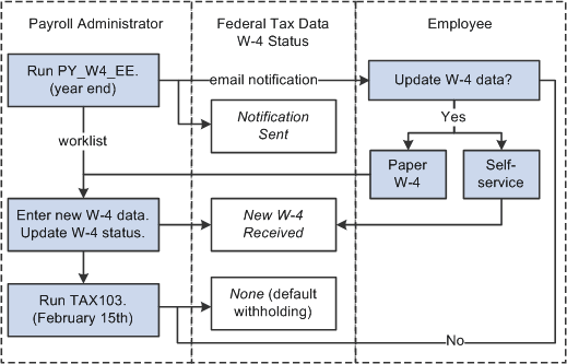

W-4 Workflow Processing Steps
This diagram illustrates how workflow processing is used by both the payroll administrator and employee to manage W-4 exemption processing:
This diagram illustrates how workflow processing is used by both the payroll administrator and employee to manage W-4 exemption processing.
Workflow processing diagram showing how the payroll administrator and employee use the system to manage W-4 exemptions
To process W-4 exemptions using workflow processing, the payroll administrator:
  1. Runs the Determine W-4 Exempt Renewal Application Engine process (PY_W4_EE) to identify and notify employees who must submit a new Form W-4.
  2. Selects the New W-4 Received W-4 Processing Status option on the employee's Federal Tax Data page and updates the other special tax withholding information after receiving the updated Form W-4.
    A workflow link on the worklist provides easy access to the Federal Tax Data page to enter the data.
    If a notified employee uses the W-4 Withholding Certificate self-service transaction in PeopleSoft ePay to update W-4 tax information, the system selects the New W-4 Received W-4 Processing Status option on the Federal Tax Data page and updates the other withholding information. The payroll administrator's worklist notification remains active so that the administrator can verify that the employee submitted a new current-year Form W-4 stating that the employee is still exempt.
  3. Runs the Report/Update W-4 Exempt Employees SQR Report process (TAX103) to reset the withholding information to default values for employees who fail to resubmit.

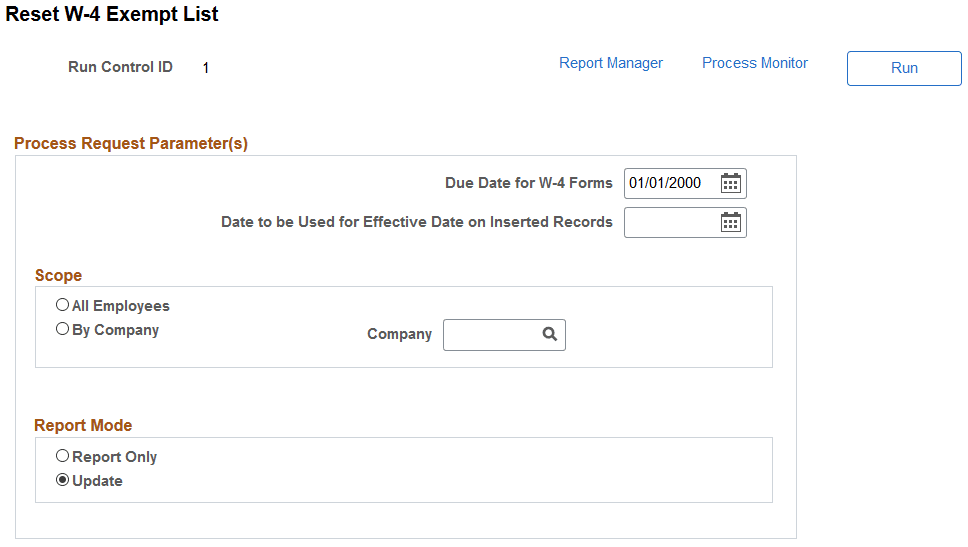

Reset W-4 Exempt List Page
(USA) Use the Reset W-4 Exempt List page (RUNCTL_TAX103) to run the Reset W-4 Exempt List report process (TAX103) in update or report only mode.
Navigation:
Payroll for North America, and then U.S. Annual Processing, and then Year-End/New Year Preparation, and then Reset W-4 Exempt List, and then Reset W-4 Exempt List
This example illustrates the fields and controls on the Reset W-4 Exempt List page.
Run the Reset W-4 Exempt List process on February 15 of each new tax year. If run in update mode, the SQR inserts a new row into employee tax data with default values for employees who do not submit a new W-4 form.
Field or Control Description
Due date for W-4 forms
Enter the due date for the W-4 forms. The IRS due date is Feb 15 of each new year. The report uses this date to check for Federal Tax Data records with an effective date on or after the date specified.
Date to be used for Effective date on inserted records
Enter the effective date to enter on new Federal Tax Data records created by the process for employees who failed to refile. Run the reset process in update mode on Feb 15 of each new year.
All Employees
Select this option to include all employees in this process.
By Company and Company
Select this option to include specific companies, and enter the company name.
Report Only
Select this option to identify employees who, although notified by the Determine W-4 Exempt Renewal process, have not filed a new W-4 by February 15 to continue their exemption from withholding. The report also identifies future-dated records.
Update
Select this option to insert a new Tax record to reset the employee's special withholding tax status to None and tax status to S (single).
