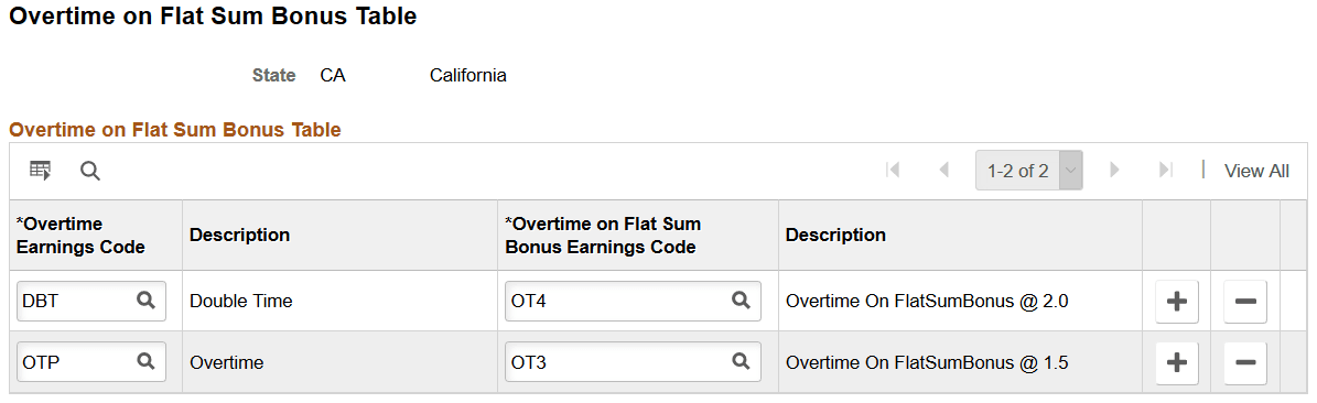

Overtime on Flat Sum Bonus Table Page
Use the Overtime on Flat Sum Bonus Table page (OT_PREMIUM_MAPPING) to map overtime earnings codes to overtime on flat sum bonus earnings codes for a specific state.
Navigation:
Set Up HCM, and then Product Related, and then Payroll for North America, and then Payroll Processing Controls, and then Overtime on Flat Sum Bonus Tbl, and then Overtime on Flat Sum Bonus Table
This example illustrates the fields and controls on the Overtime on Flat Sum Bonus Table page.
Each Overtime earnings code that requires the calculation of overtime on flat sum bonus payment must be mapped to a corresponding unique Overtime on Flat Sum Bonus earnings code on this page.
During pay calculation, the calculation of overtime due on a flat sum bonus payment generates and inserts paylines using the mapped Overtime on Flat Sum Bonus earnings code.
Currently, California is the only state for which a Flat Sum Bonus Table entry is required.
