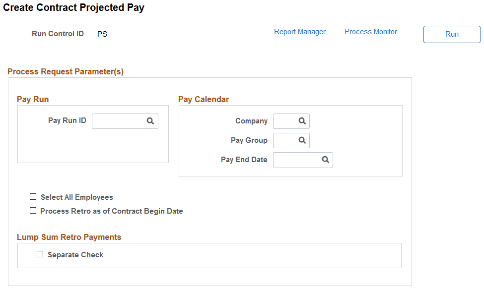

Create Contract Projected Pay Page
(E&G) Use the Create Contract Projected Pay page (RUNCTL_PAYINIT3) to process additional pay for contractual employees.
Navigation:
  • Payroll for North America, and then Payroll Processing USA, and then Create and Load Paysheets, and then Create Contract Projected Pay, and then Create Contract Projected Pay
  • Payroll for North America, and then Payroll Processing CAN, and then Create and Load Paysheets, and then Create Contract Projected Pay, and then Create Contract Projected Pay
This example illustrates the fields and controls on the Create Contract Projected Pay page.
This page executes the CNTPAY01 SQR. The Contract Projected Payment process produces an exception report. The exception report lists corrections that might be required to process contract additional pay.
You can use the Pay Run group box or the Pay Calendar group box, but not both. Entering a pay run ID identifies the pay calendars to process. Each pay calendar identifies a company, pay group, and the start and end dates of the pay period. Or, enter the company, pay group, and pay end date to identify the pay calendar to use.
Field or Control Description
Select All Employees
Select this check box to force a recalculation of the contract projected payment for all employees in the pay run.
Process Retro as of Contract Begin Date
Indicates if the pay rate change on the JOB row associated with an EffSeq is used in the calculation of pay adjustments. This checkbox is deselected by default.
When the Contract Projected Pay program is executed, and the Process Retro as of Contract Begin Date checkbox is selected, the pay adjustment will be calculated in the following scenario:
  • The Contract Renewal Process adds a new row in Job effective 01/01/20xx; and
  • There is an increase in the compensation rate effective 01/01/20xx, EffSeq 1.
When the Contract Projected Pay program is executed, and the Process Retro as of Contract Begin Date checkbox is deselected, the pay adjustment will not be calculated in the scenario above.
Lump Sum Retro Payments
Separate Check
Select this option to distribute all lump-sum retroactive payments in the pay cycle as separate checks.
Important:
Run this process before you run the Create Paysheet process. This process creates additional pay records that are referenced during a payroll run.
