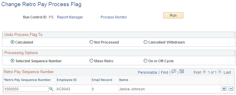

Change Retro Pay Process Flag Page
Use the Change Retro Pay Process Flag page (RUNCTL_RTROPAYUNDO) to change the process flag value in the Retro Pay Request table for retro pay requests.

This example illustrates the fields and controls on the Change Retro Pay Process Flag page.
Undo Process Flag To
Indicate the new process flag value to apply to the affected retro requests: Calculated, Not Processed, or Cancelled/Withdrawn.
Processing Options
Select one of these options to indicate how you will choose which retro requests to update.
Field or Control Description
Selected Sequence Number
Select this option if you want to select one or more specific retro requests to update. When you select this option, the Retro Pay Sequence Number grid appears so that you can enter the retro pay sequence numbers (the request IDs) for the requests that you want the system to update.
This group box is visible only when the process option is Selected Sequence Number.
Select the sequence numbers for the retro requests that you want to update. Although you enter the sequence number, you can use the field prompt to search for sequence numbers based on the EmplID, the employee name, or the current value of the retro pay process flag.
You cannot select retro requests that are already processed and closed. Retro requests in these statuses are considered closed:
Manually Loaded to Paysheet
Loaded to Paysheets
Paycheck Reversed
Confirmed Payment
Cancelled/Withdrawn
