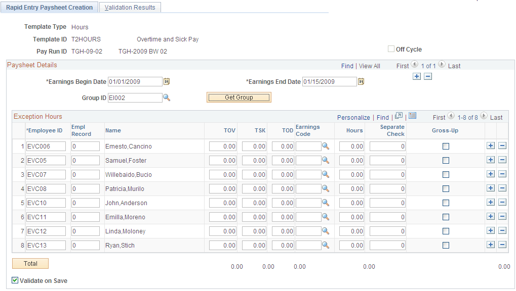

Rapid Entry Paysheet Creation Page
Use the Rapid Entry Paysheet Creation page (PYRE_AMT_ENTRY) to enter hours, amounts, or a combination of both for the earnings codes defined in a template.
Navigation:
  • Payroll for North America, and then Payroll Processing USA, and then Create and Load Paysheets, and then Create Rapid Entry Paysheets, and then Rapid Entry Paysheet Creation
  • Payroll for North America, and then Payroll Processing CAN, and then Create and Load Paysheets, and then Create Rapid Entry Paysheets, and then Rapid Entry Paysheet Creation
  • Payroll for North America, and then Payroll Processing USF, and then Create and Load Paysheets, and then Create Rapid Entry Paysheets, and then Rapid Entry Paysheet Creation
This example illustrates the fields and controls on the Rapid Entry Paysheet Creation page.
The group boxes and fields appear on the page based on the template type you enter. Use the Hours or Amounts combination template type if you want to include earnings defined as Hours Only and earnings defined as Amounts Only in the same template.
Exception Hours
Field or Control Description
Hours
Enter the number of hours for the additional earnings code.
Exception Amount
[Various columns on the right of the Name column]
Enter dollar amounts in the columns for earnings codes defined on the template.
Earnings Amount
Use this column to enter the appropriate dollar amount that is associated with the additional earnings code.
FLSA Employees Being Paid Bonuses
When bonuses paid to FLSA employees must be spread over several FLSA periods, enter the earnings begin and end dates to reflect the entire period covered by the bonus. The Pay Calculation process spreads the bonus amount over the FLSA periods encompassed by the earnings begin and end dates.
Exception Amount
Enter the appropriate hours or amounts for each earnings code.
