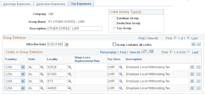

Tax Expenses Page
Use the Tax Expenses page (PYGL_ACTIVE_TAXGRP) to group taxes into expense groups.
Navigation:
Set Up HCM, and then Product Related, and then Payroll for North America, and then GL Interface, and then GL Activity Grouping, and then Tax Expenses
This example illustrates the fields and controls on the Tax Expenses page.
Tax Expenses page
Field or Control Description
Valid Activity Type(s)
Select Tax Group.
Group contains all codes
To create the required default tax group, select Group contains all codes. This group is used for any tax expenses that are not included in a specific group. When you select this check box, the other fields on the page disappear.
Codes in Group Definition
Country
The country that you select determines the fields that are available for data entry:
USA: The State, Locality, and Tax Class fields are available.
Canada: The Wage Loss Replacement Plan and Tax Class fields are available.
State and Locality
(USA) Use of the State and Locality fields depends upon the type of tax and the location. For example, FICA OASDI is a federal tax that would not require the State and Locality fields.
(CAN) Set up a separate group for each different wage loss plan for purposes of employment insurance (EI).
Tax Class
Tax Class is always a required field. The values available for selection depend upon the values selected in preceding fields.
