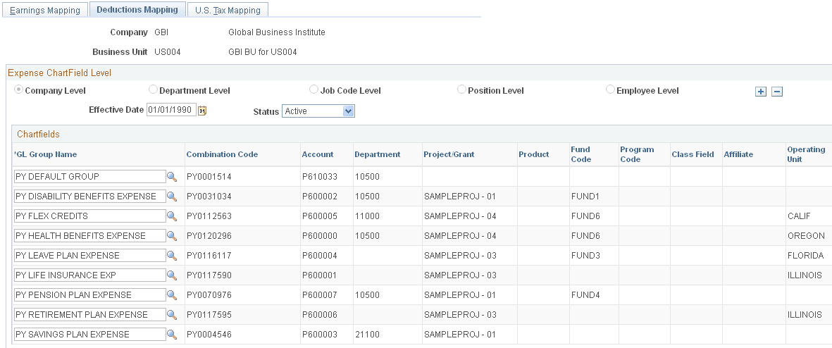

Deductions Mapping Page
Use the Deductions Mapping page (PYGL_CO_CF_MAPDED) to specify mapping level and map deduction expense groups to ChartField combinations.
Navigation:
  • Set Up HCM, and then Product Related, and then Payroll for North America, and then GL Interface, and then ChartField Expense Mapping USA, and then Deductions Mapping
  • Set Up HCM, and then Product Related, and then Payroll for North America, and then GL Interface, and then ChartField Expense Mapping CAN, and then Deductions Mapping
This example illustrates the fields and controls on the Deductions Mapping page.
The whole page is not shown here. The fields displayed on the page are determined by the ChartField configuration.

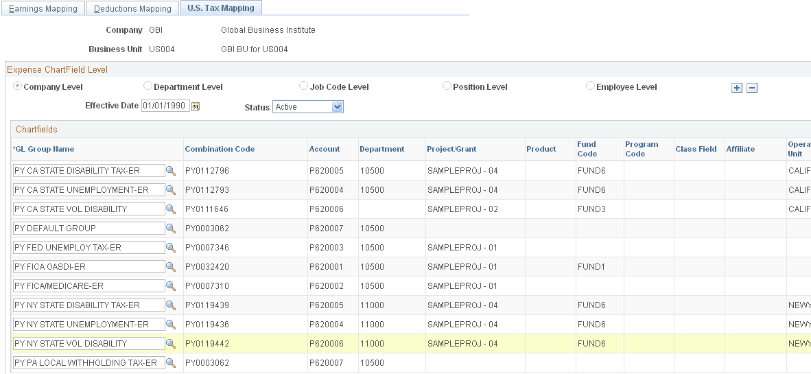

U.S. Tax Mapping page
(USA) Use the U.S. Tax Mapping page (PYGL_CO_CF_MAPTAX) to specify mapping level and map U.S. tax expense groups to ChartField combinations.
Navigation:
Set Up HCM, and then Product Related, and then Payroll for North America, and then GL Interface, and then ChartField Expense Mapping USA, and then U.S. Tax Mapping
This example illustrates the fields and controls on the U.S. Tax Mapping page.

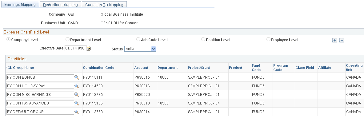

Canadian Tax Mapping Page
(CAN) Use the Canadian Tax Mapping page (PYGL_CO_CF_MAPCTX) to specify mapping level and map Canadian tax expense groups to ChartField combinations.
Navigation:
Set Up HCM, and then Product Related, and then Payroll for North America, and then GL Interface, and then ChartField Expense Mapping CAN, and then Canadian Tax Mapping
This example illustrates the fields and controls on the Canadian Tax Mapping page.
