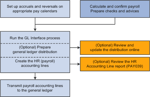

Processing Steps
This diagram illustrates the general ledger processing steps to transmit payroll accounting lines to the general ledger:
General ledger processing steps showing how to transmit payroll accounting lines to the general ledger
After the GL interface setup is complete, these are the ongoing steps for each payroll cycle:
  1. Verify that the payroll is confirmed.
  2. Run the GL Interface process.
    You can run the GL Interface Application Engine process (PAYGL01) in one step or two separate steps:
    1. (Optional) Prepare the distribution without generating the HR accounting lines, then review and update the distribution in online pages.
    2. (Required) Generate the HR accounting lines.
  3. Publish the contents of the HR Accounting Line table to PeopleSoft General Ledger.
