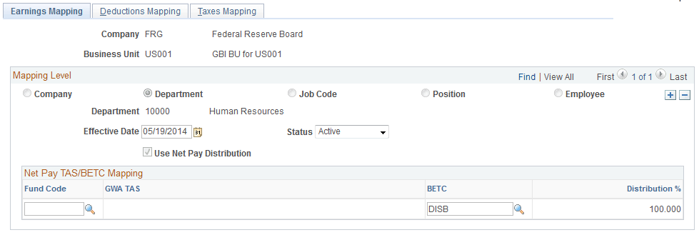

TAS BETC Mapping - Earnings Mapping Page
Use the TAS BETC Mapping - Earnings Mapping page (GVT_TAS_MAP_ERN) to map a componentized TAS by fund code and BETC for net pay earnings transactions.
Navigation:
Set Up HCM, and then Product Related, and then Payroll for North America, and then Treasury Interface USF, and then TAS BETC Mapping, and then Earnings Mapping
Consider entering as much information as you can on the search page when adding a new TAS BETC mapping. Consider entering the relevant code or ID to use for the mapping level that you select (for example, if you select the Department mapping level, enter the Department number to use; if you select the Job Code mapping level, enter the Job Code to use; and so on). Only Company and Business Unit values are required to access the TAS BETC Mapping component. If you do not select a mapping level, the system uses the default Company level. You cannot change the mapping level or associated code or ID from within the component . If you want to map to a different level (department, job code, position, or employee) you must select it on the search page, or exit the component and enter criteria to access it again.
This example illustrates the fields and controls on the TAS BETC Mapping - Earnings Mapping page.
Mapping Level
Field or Control Description
Company, Department, Job Code, Position, or Employee
The system selects the mapping level that you selected on the component search page (or selects Company if you did not select a mapping level). You cannot change the mapping level or associated code or ID from within the component. To change these, exit the page (click TAS BETC Mapping in the bread crumbs), and access the component again. This time select the desired mapping level and associated code or ID to use.
Note: Only one TAS per employee paycheck is permitted for reporting net pay regardless of earnings codes or multiple jobs.
Net Pay TAS/BETC Mapping
Fund Code
Select the fund code to use for net pay earnings mapping. Only fund codes that are associated with the componentized TAS are available.
GWA TAS (Government Wide Accounting Treasury Account Symbol)
The system displays the system-generated GWA TAS code (componentized TAS) that is associated with the fund code.
BETC (Business Event Type Code)
The system displays the default BETC for the componentized TAS. DISB (Payroll Disbursement) is the default BETC for all TAS components.
If additional BETCs are defined in your system, you can select from the list of valid values here.

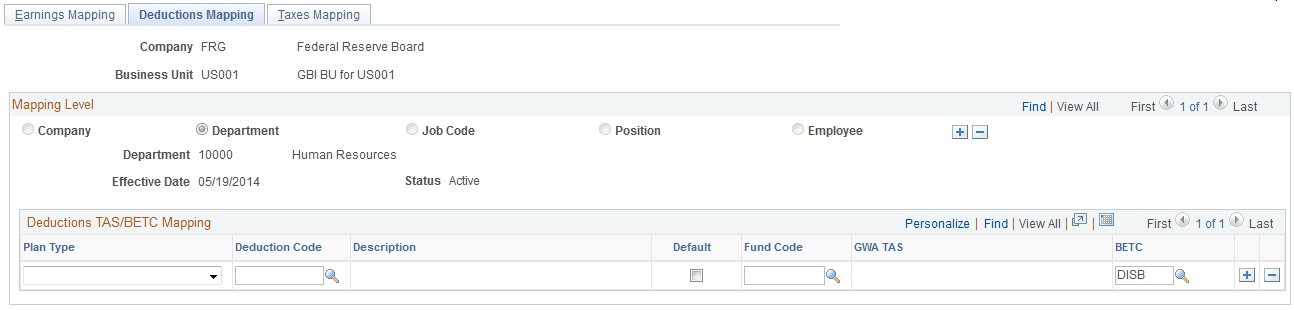

TAS BETC Mapping - Deductions Mapping Page
Use the TAS BETC Mapping - Deductions Mapping page (GVT_TAS_MAP_DED) to map a componentized TAS by fund code and BETC for deduction transactions.
Navigation:
Set Up HCM, and then Product Related, and then Payroll for North America, and then Treasury Interface USF, and then TAS BETC Mapping, and then Deductions Mapping
This example illustrates the fields and controls on the TAS BETC Mapping - Deductions Mapping page.
Deductions TAS/BETC Mapping
Plan Type and Deduction Code
Select the plan type and deduction code to use for this deduction mapping.
Note: If the Plan Type field is blank, the Deduction Code field must also be blank.
If this row is the default deduction mapping row, then both the Plan Type and Deduction Code fields can remain blank.
If this is not the default mapping row, you can enter a plan type and deduction code, enter only a plan type, or leave both fields blank.
Default
Select this check box to use the row as the default deductions mapping row.
Note: One row must be selected as the default deduction mapping row, and only one row can be selected as the default.
Fund Code
Select the fund code to use for deduction mapping.
Note: Only fund codes that are associated with the componentized TAS are available.

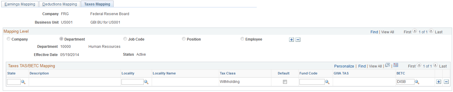

TAS BETC Mapping - Taxes Mapping Page
Use the TAS BETC Mapping - Taxes Mapping page (GVT_TAS_MAP_TAX) to map a componentized TAS by fund code and BETC for appropriate state and local taxes.
Navigation:
Set Up HCM, and then Product Related, and then Payroll for North America, and then Treasury Interface USF, and then TAS BETC Mapping, and then Taxes Mapping
This example illustrates the fields and controls on the TAS BETC Mapping - Taxes Mapping page.
Taxes TAS/BETC Mapping
State and Locality
Specify the state and locality for which taxes must be paid by employees in the company and business unit.
Add rows to cover each state and locality as applicable. For example, additional rows may be required if you are mapping at the department level and departments are located in different states or different areas with different tax laws in the same state.
If the row’s Default check box is selected, the State and Locality fields can remain blank.
If the State field remains blank, the Locality field must remain blank.
If a State field value is entered, a Locality field value is optional.
Tax Class
The system displays the only tax class that applies, which is Withholding.
Default
Select this check box to use the row as the default tax mapping row.
Note: One row must be selected as the default tax mapping row, and only one row can be selected as the default.
Fund Code
Select the fund code to use for the tax mapping.
