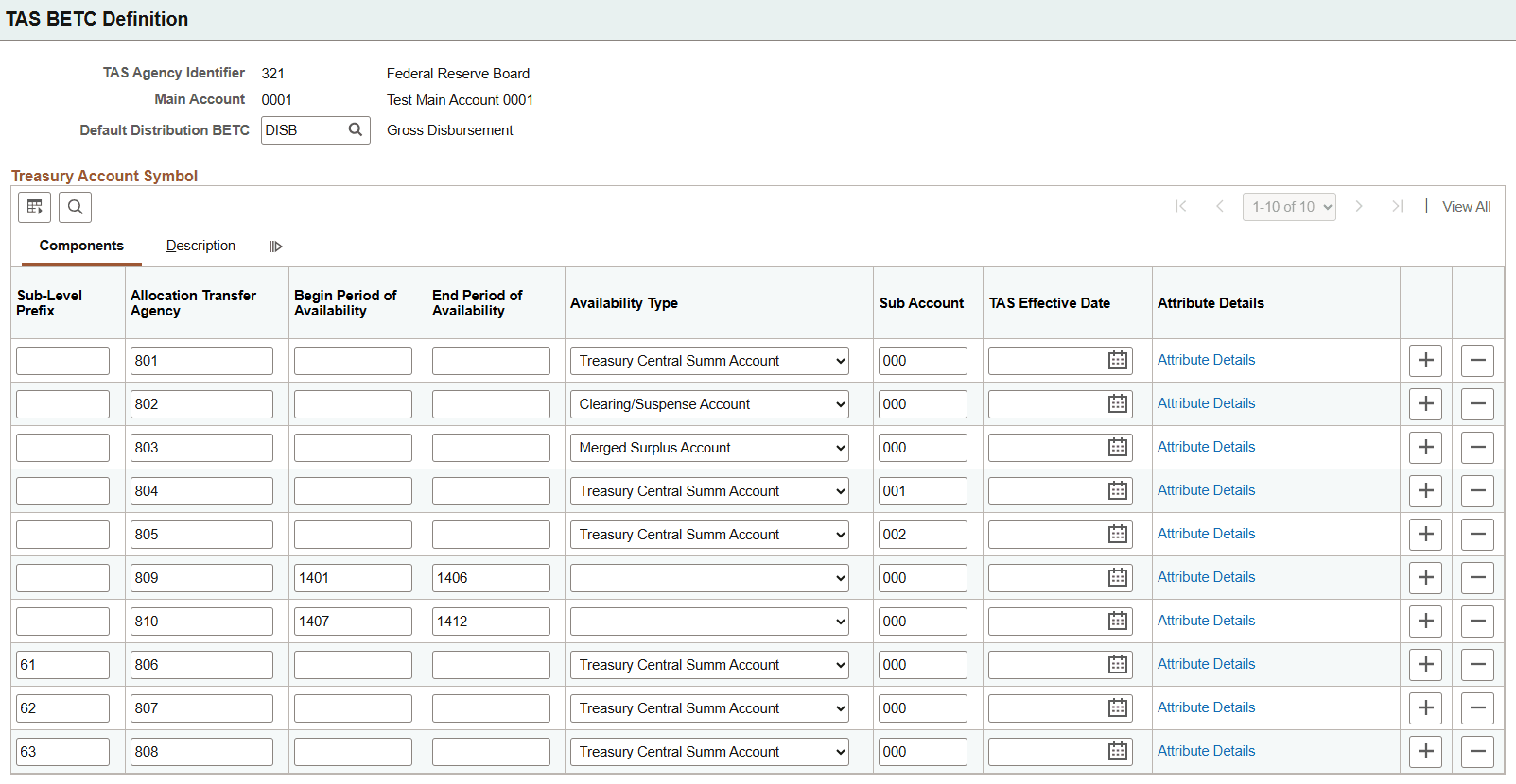

TAS BETC Definition Page
Use the TAS BETC Definition page (GVT_TAS_DEFN) to enter key values (Agency Identifier Code and Main Account) to create an agency and main account combination, define attributes (components) for funding accounts within that combination, and generate a componentized TAS for each funding account.
Navigation:
This example illustrates the fields and controls on the TAS BETC Definition page.
| Field or Control | Description |
Default Distribution BETC |
Select the default Business Event Type Code (BETC) to associate with the componentized TAS. When adding a new TAS row, this value is automatically populated on the TAS Attributes page and used as the default disbursement BETC, unless overridden. Only BETCs with the Disbursement BETC option selected and the Adjustment option cleared on the BETC Definition page are available for selection. |
Treasury Account Symbol
Sub-Level Prefix |
Enter a two-digit numeric sub-level prefix value, or leave blank if not applicable. Valid values are 00 through 99. The sub-level prefix is a programmatic breakdown of the account for Treasury publication purposes. |
Allocation Transfer Agency |
Enter a three-digit numeric allocation transfer agency identifier value, or leave blank if not applicable. Valid values are 000 through 999. If you enter less than three digits, the system supplies leading zeros. |
Begin Period of Availability and End Period of Availability |
You must enter either a begin year and end year for the period during which you want this account to be available, or you must enter an Availability Type. If you enter begin and end years, use the 4-digit year format, for example 2014. In annual and multi-year funds, begin and end year dates identify the first and last year of availability under law that an appropriation account may incur new obligations. |
Availability Type |
Enter an applicable availability type for this account, if begin and end years are not specified. Values include:
Sub Account |
Enter a three-digit numeric sub-account code. Valid values are 000 through 999. The sub-account code identifies an available receipt or other Treasury-defined subdivision of the main account. |
TAS Effective Date |
Enter the date on which the componentized TAS should become effective. Note: This field is for future use, and is not currently reported to the Treasury. |
Attribute Details |
Click this link to create a system-generated GWA TAS identifier code and Business Event Type Code (BETC) for this combination of details. The system redirects you to the TAS Attributes page where you can see the results and enter the appropriate fund code information. Note: You cannot save the TAS BETC Definition page without first clicking the Attribute Details link to generate the GWA TAS code. |

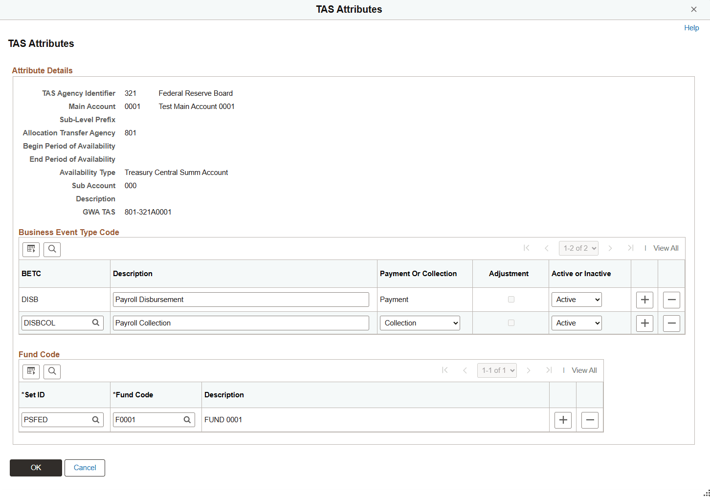

TAS Attributes Page
Use the TAS Attributes page (GVT_TAS_DEFN_ATTR) to view the list of components in the componentized TAS for a funding account, and associate BETCs and fund codes with the componentized TAS.
Navigation:
Click the Attribute Details link on the TAS BETC Definition page.
This example illustrates the fields and controls on the TAS Attributes page.
Attribute Details
The system displays the list of components that comprise the componentized TAS.
GWA TAS (Government Wide Accounting Treasury Account Symbol) |
Displays the unique GWA TAS code that represents the componentized TAS. The system generates this code when you click the Attribute Details link on the TAS BETC Definition page. |
BETC (Business Event Type Code) |
Displays the BETC set up for the componentized TAS. When a new TAS row is added on the TAS BETC Definition page, the default disbursement BETC defined there is automatically populated here. You can specify additional BETCs to associate with the componentized TAS, if needed. Only BETCs defined on the BETC Definition Page are available for selection. |
Fund Code
Set ID and Fund Code |
You must associate at least one fund (set ID and fund code combination) with each componentized TAS. You can link more than one fund code to each componentized TAS; however, a fund code can be related to only one componentized TAS. |
