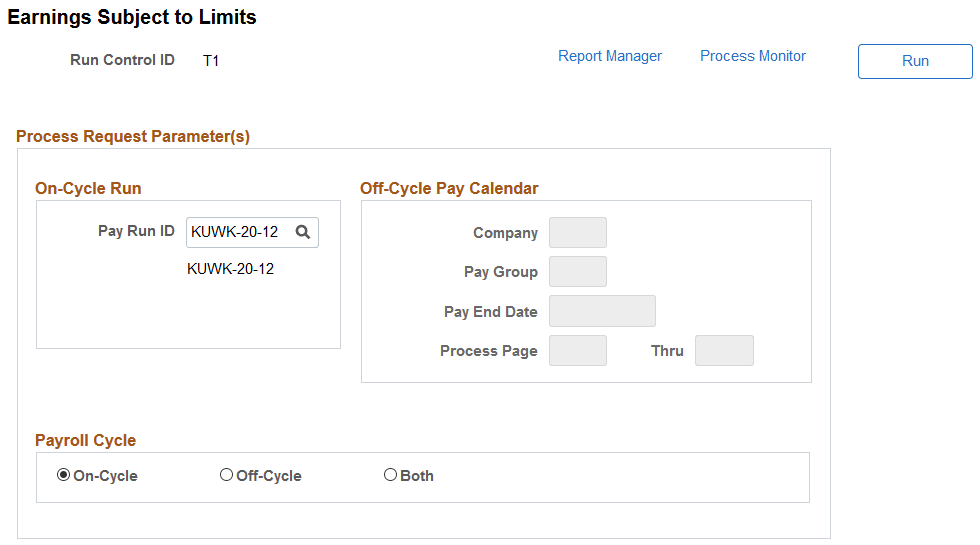

Earnings Subject to Limits Page
Use the Earnings Subject to Limits page (RUNCTL_LIMIT_ERN) to print Earnings Subject to Limits reports.
Navigation:
  • Payroll for North America, and then Payroll Processing USA, and then Produce Payroll, and then Earnings Subject to Limits, and then Earnings Subject to Limits
  • Payroll for North America, and then Payroll Processing USF, and then Produce Payroll, and then Earnings Subject to Limits, and then Earnings Subject to Limits
This example illustrates the fields and controls on the Earnings Subject to Limits page.

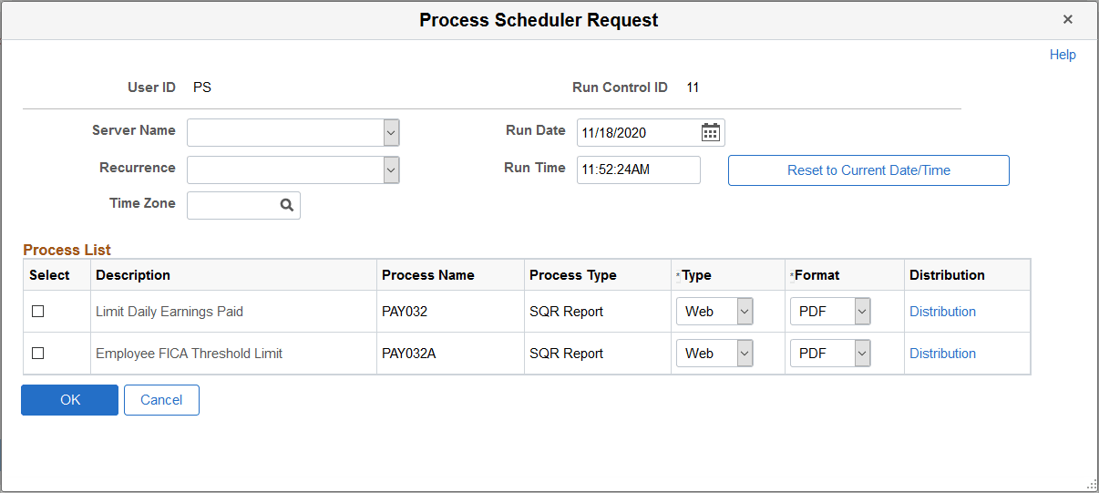

This example illustrates the fields and controls on the Earnings Subject to Limits - Process Scheduler Request page.
Select to run the PAY032, PAY032A, or both reports.
