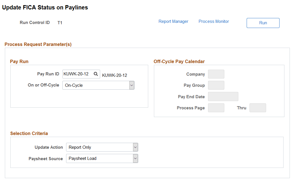

Update FICA Status on Paylines Page
Use the Update FICA Status on Paylines page (PY_UPD_FICA_ST) to print Update FICA Status on Paylines reports.
Navigation:
  • Payroll for North America, and then Payroll Processing USA, and then Create and Load Paysheets, and then Update FICA Status on Paylines, and then Update FICA Status on Paylines
  • Payroll for North America, and then Payroll Processing USF, and then Create and Load Paysheets, and then Update FICA Status on Paylines, and then Update FICA Status on Paylines
This example illustrates the fields and controls on the Update FICA Status on Paylines page.
Enter the run ID for an on-cycle or off-cycle pay calendar, or enter off-cycle pay calendar parameters to run the Update FICA Status process.
Field or Control Description
Update Action
Select the mode of the report. Values are:
Report Only: Select this option after running the Load Paysheets or Load Time and Labor process for on-cycle and off-cycle payrolls.
Update: Select this option after you review the report and are ready to make the updates, which include FICA status changes and moving earnings codes to new additional lines.
Paysheet Source
Values are:
  • Paysheet Load: Select to run the PAY037B report for paylines that are processed by the Load Paysheets process. If a payline contains earnings codes loaded from different sources (for example, rapid paysheets and other sources), they will be processed in the same run.
  • Time and Labor Load: Select to run the PAY037 report for Time and Labor paylines.

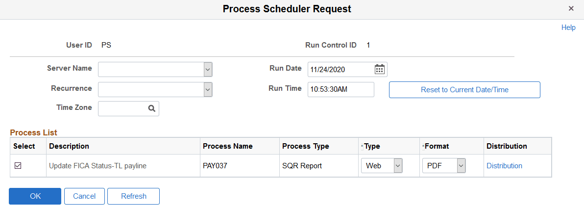

This example shows the preselection of the PAY037 report on the Process Scheduler Request page when Time and Labor Load is selected as the paysheet source on the Update FICA Status on Paylines run control page.
Update FICA Status on Paylines - Process Scheduler Request page (PAY037)
