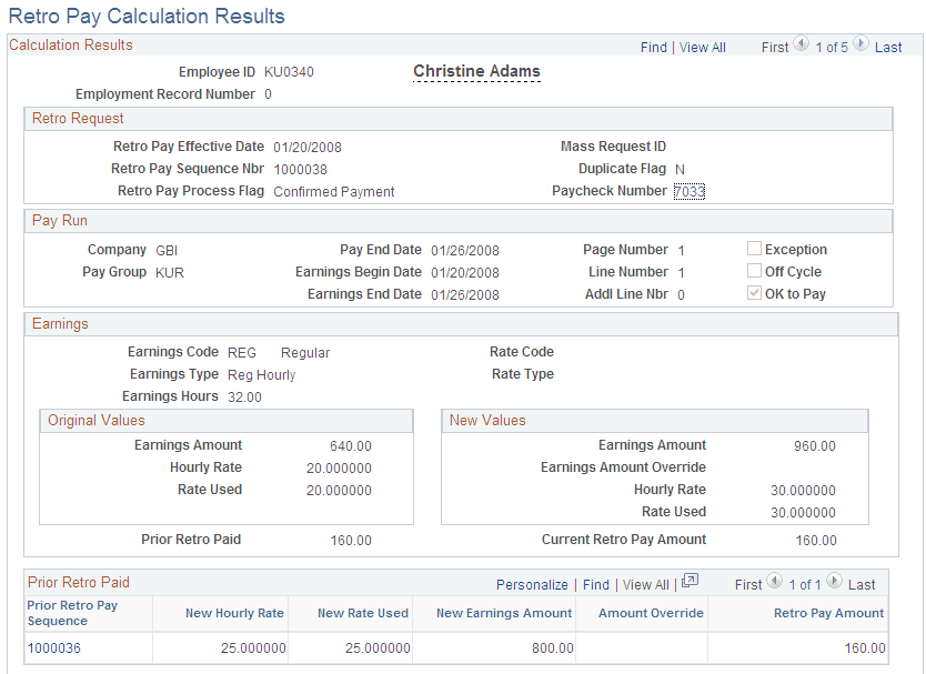

Retro Pay Calculation Results Page
Use the Retro Pay Calculation Results page (RETROPAY_EARNS) to check the results of the Retroactive Pay Calculations process, and override the results if necessary.
Navigation:
Payroll for North America, and then Retroactive Payroll, and then Retro Pay, and then Process and Review Requests, and then Retro Pay Calculation Results, and then Retro Pay Calculation Results
This example illustrates the fields and controls on the Retro Pay Calculation Results.
This page displays retro requests that have a process flag of Calculated, Loaded to Paysheets, Confirmed Payments, Action Required, Paycheck Reversed, and Manually Loaded to Paysheet.
Except for the OK to Pay and Earnings Amount Override fields, which are editable in certain circumstances, all fields on this page are display-only.
Calculation Results
This page displays the results for a single retro request. There are separate rows of data for each earnings code in each pay period.
For example, an employee gets a retroactive pay increase that affects two pay periods. During the first of those pay periods, the employee had only regular earnings. During the other pay period, the employee had both regular and holiday earnings. There will be three rows of data on the Retro Pay Calculation Results page: one row for the first pay period, and two rows for the second pay period.
Retro Request
This group box displays information that identifies and describes the retro request. All rows of data have the same retro request information.
Field or Control Description
Duplicate Flag
Displays N (no) or Y (yes) to indicate whether this is a duplicate retro request.
Normally, there can only be one open retro request for an employee and job number. However, duplicate requests can occur when changes made online are also processed in batch. Therefore, when the system creates a new online retro request, it checks to see if there is an open mass retro request. If there is, the system selects the Duplicate Flag for both the mass retro request and the online retro request.
Paycheck Number or Paycheque Number
After the retro pay is paid (the retro request process flag is Confirmed Payment or Paycheck Reversed), this field displays the check number of the check that includes the retro pay.
The check number is a link that you select to access the Review Paycheck component, where you can review complete payment details. In the Review Paycheck component, retro earnings appear in the Other Earnings grid. The detail information for the retro earnings codes includes the retro pay sequence number; the sequence number is a link back to the Retro Pay Calculation Results page.
Pay Run
This group box displays information about the pay run that is affected by the retro request.
Exception
The system selects this check box if the retro pay calculation is based on a mid-pay period change. This informs you that the system prorates the retroactive pay amount. Run the Retro Pay Summary report (PAY302RT) to verify the proration calculation.
Exception processing can also generate Retro Pay messages that you should review and validate prior to loading the retro calculations to paysheets.
See Retro Pay Messages Page.
OK to Pay
The system initially selects this check box for active employees and deselects it for terminated employees. The system also initially deselects this check box if the Duplicate Flag is Y (yes).
You can change this setting only if process flag is Calculated.
Earnings
This group box displays information about an earnings code for which the employee received retro pay during the pay period.
Original Values and New Values
These group boxes show pay-period specific information about a particular retro-eligible earnings code.
Earnings Amount
The original value is the amount that was paid on the employee's original pay check. It is not adjusted for any previous retro payments.
The new value is the amount that the employee would have received if the retro changes had been in effect at the time of the original paycheck.
To override the calculation, enter the desired new earnings amount. The system uses the manually entered override amount rather than the (calculated) new earnings amount to determine the amount of retro pay.
The system recalculates the Current Retro Pay amount when you save the page. The calculated new earnings amount is not updated.
You can only enter an override while the retro request is open.
Prior Retro Paid
Displays the sum of all prior retro payments for the employee record number, pay period, and earnings code. If this is non-zero, the Prior Retro Paid grid appears so that you can review the supporting details.
Current Retro Pay Amount
Displays the amount of retro earnings to be paid for this employee record number, pay period, and earnings code. The system calculates the amount as follows:
New Earnings Amount – Original Earnings Amount – Prior Retro Paid
If you entered an earnings override, the system substitutes the override amount for the new earnings amount:
Earnings Amount Override – Original Earnings Amount – Prior Retro Paid
Prior Retro Paid
If the Prior Retro Paid field shows a non-zero amount, this group box appears.
Prior Retro Pay Sequence
Displays the ID of the retro request for the previously paid retro earnings. Select the link to view the calculation details for that retro request.

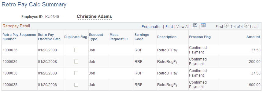

Retro Pay Calc Summary Page
Use the Retro Pay Calc Summary page (RETROPAY_SUMMARY) to review a summary of the retro pay requests of an individual employee.
Navigation:
Payroll for North America, and then Retroactive Payroll, and then Retro Pay, and then Process and Review Requests, and then Retro Pay Calc Summary, and then Retro Pay Calc Summary
This example illustrates the fields and controls on the Retro Pay Calc Summary page.
