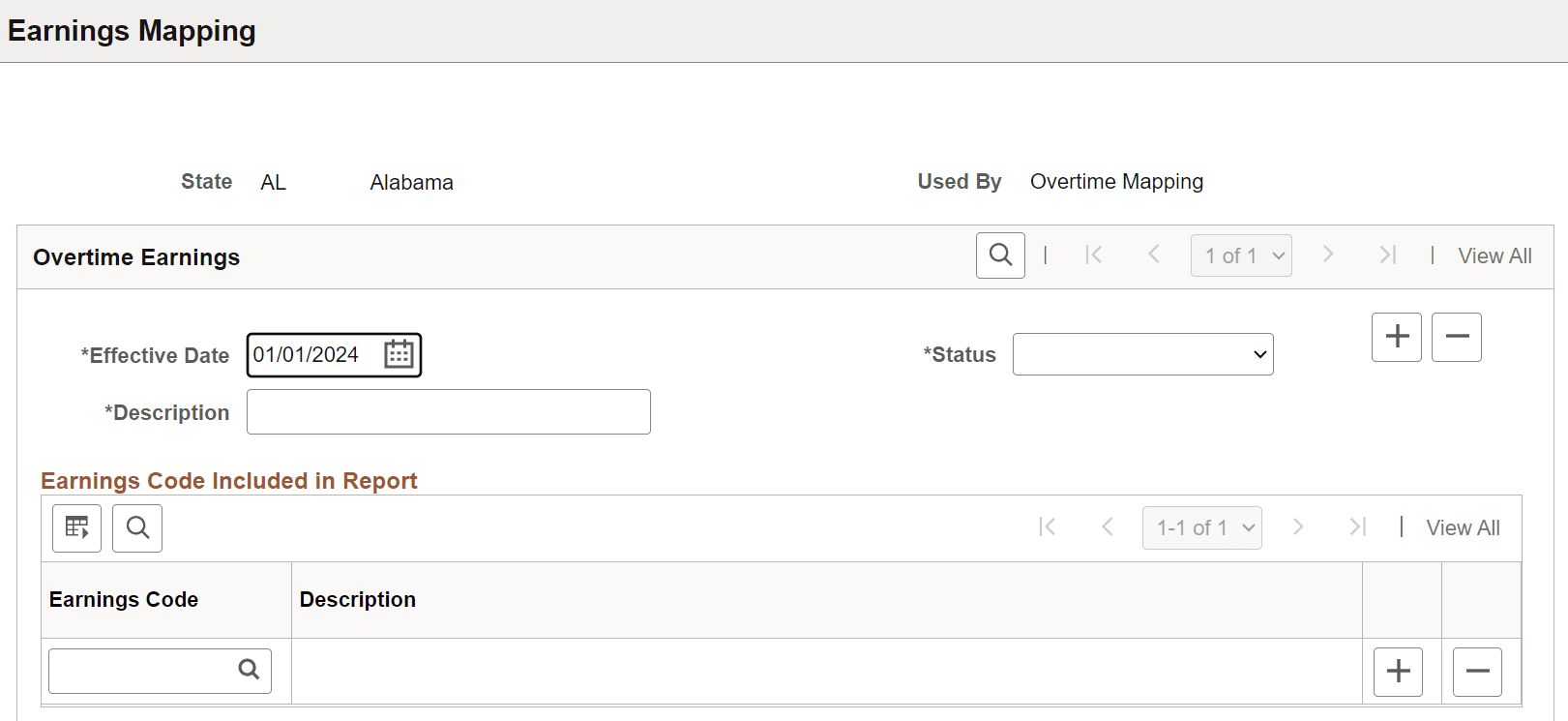

Earnings Mapping Page
Use the Earnings Mapping page (PY_ST_ERN_MAPPING) to list the overtime earnings codes to be used exclusively to pay overtime wages that qualify for Alabama tax exemption.
Navigation:
Set Up HCM, and then Product Related, and then Payroll for North America, and then Payroll Processing Controls, and then Earnings Mapping, and then Earnings Mapping
This example illustrates the fields and controls on the Earnings Mapping page.
Employers must update the Earnings Mapping Table(s) with the applicable Overtime Earnings Code(s) before the monthly/quarterly report can be generated.
The system determines whether the overtime earnings code qualify for the Alabama Tax exemption by looking at the Earnings Mapping table. If an employee has overtime wages paid using the earnings code added to the Earnings Mapping table, the employee and the corresponding overtime wages will be included in the report.
When calculating and paying overtime, some employers use two different Earnings Codes to split and separately pay overtime straight-time and overtime premium amounts. If you pay overtime using this method, be sure to add both of the Earnings Codes on this page for the report to pull the overtime pay.
Field or Control Description
Used By
Displays Overtime Mapping, the only option currently available.
Earnings Code
Specify the overtime earnings codes that are exempt from Alabama withholding tax.
Note: It is the customer's responsibility to specify the applicable overtime earnings codes that are exempt from Alabama tax withholding and used to pay overtime to full-time hourly employees for work performed in Alabama. These overtime earnings must not be used for any other types of payments that do not qualify for the Alabama overtime tax exemption.

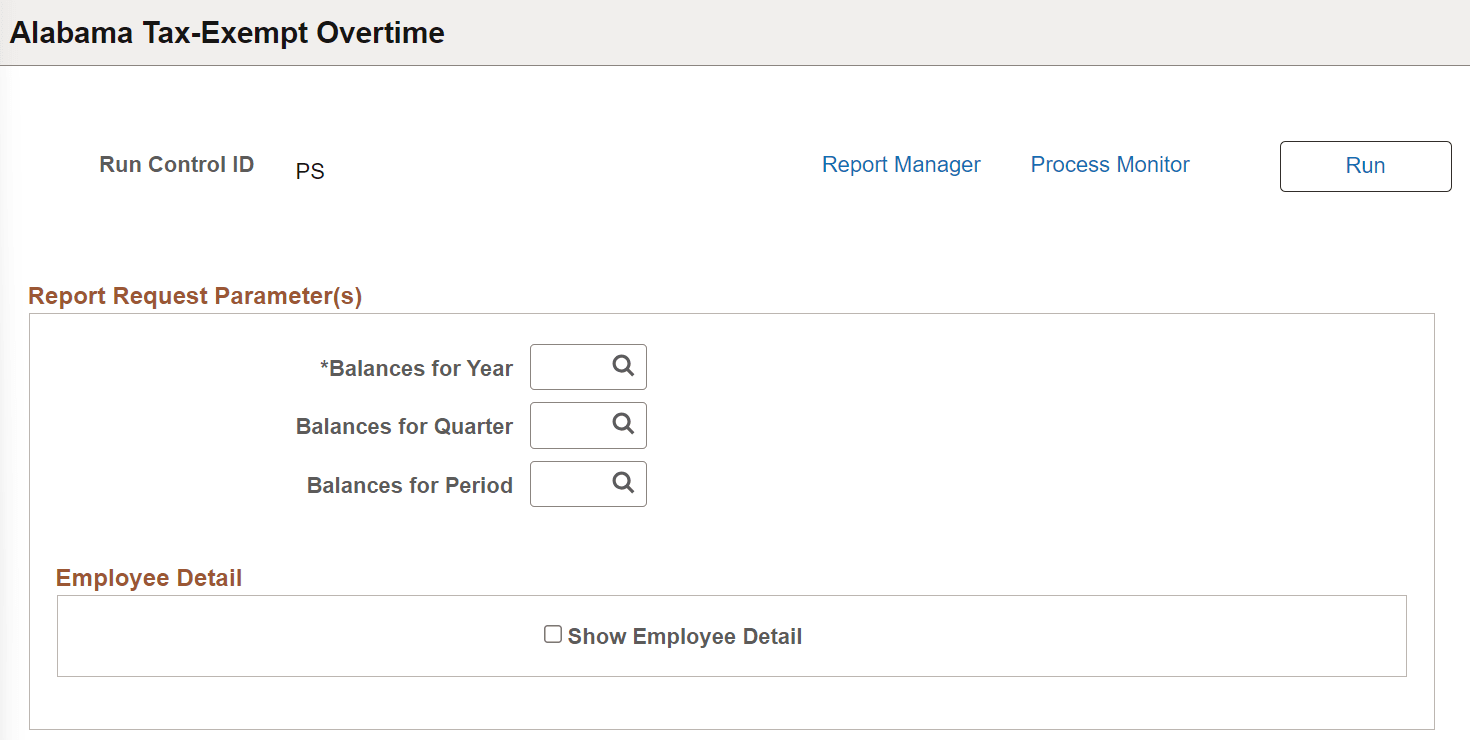

Alabama Tax-Exempt Overtime Page
Use the Alabama Tax-Exempt Overtime page (RUNCTL_TAX010AL) to set up parameters for monthly or quarterly reporting related to the exemption of overtime pay from Alabama withholding tax.
Navigation:
  • Payroll for North America, and then Pay Period Tax Reports USA, and then Alabama Tax-Exempt Overtime, and then Alabama Tax-Exempt Overtime
  • Payroll for North America, and then Pay Period Tax Reports USF, and then Alabama Tax-Exempt Overtime, and then Alabama Tax-Exempt Overtime
This example illustrates the fields and controls on the Alabama Tax-Exempt Overtime page.
Report Request Parameter(s)
Balance for Year
Enter the year of reporting.
Balance for Quarter
Enter the quarter of reporting. Must be populated for creating quarterly report.
Balance for Period
Enter the period of reporting. Must be populated for creating monthly report.
Employee Detail
Show Employee Detail
Select to include a list of all the employees who were paid overtime pay exempt from Alabama Tax withholding.
