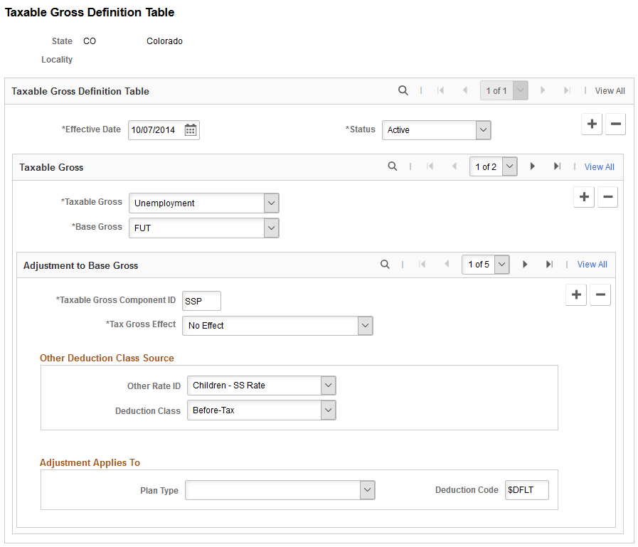

Taxable Gross Definition Table Page
Use the Taxable Gross Definition Table page (TAXGR_DEFIN_TBL) to set up a taxable gross definition, which defines the taxability and withholding for specific earnings or deduction types that must be treated differently at the state or local level than at the federal tax level.
Navigation:
Set Up HCM, and then Product Related, and then Payroll for North America, and then Federal/State Taxes, and then Taxable Gross Definition Table, and then Taxable Gross Definition Table
This example illustrates the fields and controls on the Taxable Gross Definition Table page.
Taxable Gross
Field or Control Description
Taxable Gross
Select the type of taxable gross you're defining. Valid values are:
Disability
Paid Benefit: This type is used by all states for paid benefit, as opposed to Paid Benefit - Other, which is specific to reclassified employees in DE.
(DE only) Paid Benefit - Other: This type is used to calculate paid benefit taxes for reclassified employees that are enrolled in the Delaware Paid Leave program.
Unemployment
Withholding
Base Gross
Select:
All Gross
Note: When Taxable Gross is Paid Benefit and the Base Gross is All Gross, the gross wages paid in the employee’s check will be the base when determining the taxable gross that is used to calculate the paid leave taxes. For example, Colorado, Connecticut, and Washington require paid leave taxes to be calculated on all gross wages.
FICA (Federal Insurance Contributions Act) for disability.
FUT (Federal Unemployment Tax) for unemployment, disability, or paid benefit.
FWT (Federal Withholding Tax) for withholding.
(VT only) SWT (State Withholding Tax) for paid benefit. Vermont requires child care contributions to be calculated only on wages earned in Vermont.
(DE only) State FICA (State Withholding Tax) for paid benefit. For regular employees, Delaware requires paid leave taxes to be calculated on the FICA wages that are earned in Delaware only. For reclassified employees, paid leave taxes are calculated on all FICA wages.
Adjustment to Base Gross
This scroll area lists the specific components for which adjustments are necessary.
Taxable Gross Component ID
The taxable gross component ID you specify must be unique in what it represents (for example, 401k, GTL, 125, SSS, and so forth). If it is not unique, it can cause the taxable grosses to be incorrect.
Withholding Follows Federal Rules
This check box is selected by default. Deselect it if the withholding associated with the taxable gross component ID does not follow the same rules as federal withholding.
This check box appears only if you select Withholding in the Taxable Gross field.
This check box applies only to earnings and taxable benefit amounts identified by a taxable gross component ID. It has no effect on the processing of any before-tax deductions (such as 401(k) and Sec 125 amounts) for which there may also be entries on the Taxable Gross Definition table.
Tax Gross Effect
This field controls the effect on the gross. It can either add to the gross, subtract from it, or have no effect.
Plan Type and Deduction Code
Some states do not recognize certain before-tax benefits deductions. They require specific before-tax deductions to be included in taxable gross wages. Use these fields to identify such plans to the system by plan type and deduction code on the Taxable Gross Definition record for the applicable states.
Related Topics
