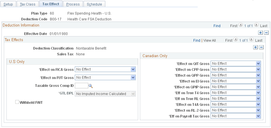

Deduction Table - Tax Effect Page
DEDUCTION_TABLE3
Specify U.S. and Canadian tax considerations for the deduction that you are defining.

(USA) Understanding U.S. Tax Considerations
Payroll for North America sets the taxable gross used for calculation of state and local income tax withholding to the taxable gross for federal withholding. Similarly, the system assumes the taxable gross for state unemployment and disability to be the same as the taxable gross for federal unemployment. However, some states and localities do not follow federal rules for the taxability of all types of benefits. Payroll for North America provides taxable gross definitions as a means of overriding the taxability rules that you specify in the Deduction table.
PeopleSoft maintains state and local taxable grosses that have been adjusted for 401(k), section 125, Thrift Savings Plan (TSP), group-term life plans (GTL), health savings account (HSA), health savings account employer contribution (HSR), and tips. You can add your own entries to the Taxable Gross Definition table for other types of deductions that must be adjusted.
Use the Deduction Table - Tax Effect page (DEDUCTION_TABLE3) to specify U.S. and Canadian tax considerations for the deduction that you are defining.
Navigation:
Set Up HCM, and then Product Related, and then Payroll for North America, and then Deductions, and then Deduction Table, and then Tax Effect
This example illustrates the fields and controls on the Deduction Table - Tax Effect page.
Tax Effects
Field or Control Description
Deduction Classification
The deduction classification specified on the Deduction Table - Tax Class page appears here.
(CAN) Sales Tax
The Canadian sales tax that is specified on the Deduction Table - Tax Class page appears here.
(USA) U.S. Only
Use this group box to indicate whether the deduction adds to, subtracts from, or has no effect on Federal Insurance Contributions Act (FICA) gross and federal unemployment tax (FUT) gross. These fields should be used only on the taxable benefit or before-tax portion of the deduction.
Effect on FICA Gross (effect on Federal Insurance Contributions Act gross)
Select how the deduction should affect the taxable gross for FICA: Adds To, No Effect, and Subtracts.
Effect on FUT Gross (effect on federal unemployment tax gross)
Select how the deduction should affect the taxable gross for FUT: Adds To, No Effect, and Subtracts.
Taxable Gross Comp ID (taxable gross component ID)
Enter the code for the system to use to define a taxable gross base different from federal when calculating state and local taxes. This code points to information in the Taxable Gross Definition table, which serves two purposes: 1) Indicates which federal taxable gross level (such as federal withholding tax [FWT], FICA, and FUT) is used as a base for state and local taxable gross. 2) Indicates how to adjust (add to or subtract from) the state and local base when it differs from the federal definition. This field is unavailable for entry unless you selected the Taxable Benefit option on the Deduction Table - Tax Class page.
Note: The taxable gross component ID that you specify must be unique. If it is not unique, it can cause the taxable grosses to be incorrect.
Note: You cannot enter a taxable gross component ID on the Deduction table if you have not yet defined it on the Taxable Gross Definition table. For more information about the Taxable Gross Definition table, see (USA) Updating the Taxable Gross Definition Table in your PeopleSoft Payroll for North America product documentation.

(CAN) Canadian Only
In this group box (with the exception of CIT gross), you specify how the deduction should affect the taxable gross amounts for each of these accumulators. You can specify whether a deduction adds to, has no effect on, or subtracts from the taxable gross amounts.
Important:
This setup is a requirement for Canadian processing. It is imperative that you define deductions that affect T4A and RL-2 withholdings before they are processed. To ensure that all amounts are allocated to the proper accumulators for year-end processing, complete this setup prior to running the first payroll of the new tax year. Be aware that the corresponding deduction codes must be defined to the appropriate tax form definitions through the Tax Form Definitions table prior to running the year-end process.
Effect on QIT Gross (effect on Quebec income taxes gross)
Select Adds To if the deduction affects Quebec taxable gross. If the deduction is not subject to QIT, select No Effect. If the deduction is eligible for reducing Quebec taxable gross, select Subtracts.
Effect on CPP Gross (effect on Canada Pension Plan gross)
Select Adds To when deductions are subject to CPP contributions. If the deduction does not impact CPP contributions, select No Effect. If the deduction is eligible to reduce CPP contributions, select Subtracts.
Note: Although CPP contributions are affected, these deductions are adding to or subtracting from the grosses.
Effect on QPP Gross (effect on Quebec Pension Plan gross)
Select Adds To when deductions are subject to QPP contributions. If the deduction does not impact QPP contributions, select No Effect. If the deduction is eligible to reduce QPP contributions, select Subtracts.
Note: Although QPP contributions are affected, these deductions are adding to or subtracting from the grosses.
Effect on EI Gross (effect on Employment Insurance gross)
Select Adds To when deductions are subject to EI premiums. If the deduction does not impact EI premiums, select No Effect. If the deduction is eligible to reduce EI premiums, select Subtracts.
Note: Although EI premiums are affected, these deductions are adding to or subtracting from the grosses.
Effect on QPIP Gross (effect on Quebec Parental Insurance Plan gross)
Select Adds To when deductions are subject to QPIP premiums. If the deduction does not impact QPIP premiums, select No Effect. If the deduction is eligible to reduce QPIP premiums, select Subtracts.
Note: Although QPIP premiums are affected, these deductions are adding to or subtracting from the grosses.
Eff on True T4 Gross (effect on true T4 gross)
Taxable benefits should be defined as Adds To. Before-tax deductions should be defined as having No Effect. This field affects accumulated total employment income amounts, which are used for reporting, purposes. The Health Insurance Premium report (TAX102CN) is an example.
Eff on True RL Gross (effect on true RL gross)
Affects accumulated total employment income amounts that are used for reporting purposes. The Health Insurance Premium report (TAX102CN) is an example. Define taxable benefits as Adds To. Define before-tax deductions as having No Effect. Values are Adds To, No Effect, and Subtracts.
Effect on T4A Gross
Affects the accumulated taxable gross amount to establish separate income taxes to be reported on a T4A slip. Values are Adds To, No Effect, and Subtracts.
Effect on RL-2 Gross
Affects the accumulated taxable gross amount to establish separate QIT to be reported on an RL-2 slip. When Effect on RL-2 Gross is set to Adds To or Subtracts, the system automatically sets Effect on QIT Gross to Adds To or Subtracts, respectively. Values are Adds To, No Effect, and Subtracts.
Eff on Payroll Tax Gross (effect on payroll tax gross)
Affects an accumulated gross amount that is subject to Northwest Territories and Nunavut payroll tax. Values are Adds To, No Effect, and Subtracts.
