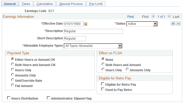

Earnings Table - General Page
Use the Earnings Table - General page (EARNINGS_TABLE1) to define parameters and rules for calculating earnings for tip processing.
Navigation:
Set Up HCM, and then Product Related, and then Payroll for North America, and then Compensation and Earnings, and then Earnings Table, and then General
This example illustrates the fields and controls on the Earnings Table - General page.
The following table suggests values and options that you might select for each tip category:
Description Field Payment Type Group Box Effect on FLSA (effect on Fair Labor Standards Act) Group Box Eligible for Retro Pay (eligible for retroactive pay) Group Box
Allocated Tips
Amounts Only
None
Not applicable.
Tip Credit
Amounts Only
None
Not applicable.
Minimum Wage Adjustment
Amounts Only
Amounts Only
Selection depends on company policy.
Reported Tips
Amounts Only
None
Not applicable.

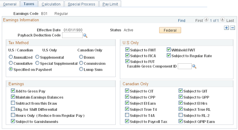

Earnings Table - Taxes Page
Use the Earnings Table - Taxes page (EARNINGS_TABLE2) to set up earnings code tax information for tip processing.
Navigation:
Set Up HCM, and then Product Related, and then Payroll for North America, and then Compensation and Earnings, and then Earnings Table, and then Taxes
This example illustrates the fields and controls on the Earnings Table - Taxes page.
Earnings Code Field Tax Method Group Box Earnings Group Box U.S. Only Group Box
Allocated Tips
Specified on Paysheet
Maintain Earnings Balances
Not subject to withholding; therefore, leave everything blank.

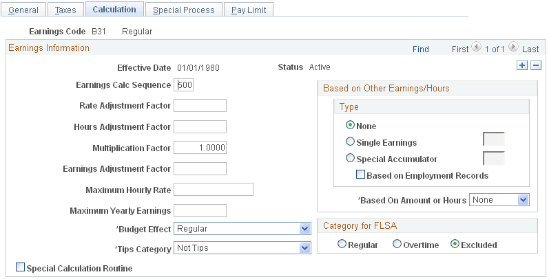

Earnings Table - Calculation Page
Use the Earnings Table - Calculation page (EARNINGS_TABLE3) to set up earnings code tax calculation information for tip processing.
Navigation:
Set Up HCM, and then Product Related, and then Payroll for North America, and then Compensation and Earnings, and then Earnings Table, and then Calculation
This example illustrates the fields and controls on the Earnings Table- Calculation page.
Earnings Code Field Tips Category Field
Allocated Tips
Tip Allocation
Tip Credit
Tip Credit
Not Tips
Reported Tips
Reported Tips
