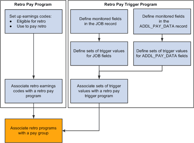

Retro Program Setup
To set up retro processing, you must define these two types of retro programs for each pay group:
  • Retro pay programs define the earnings codes on which retro pay can be calculated as well as the earnings codes used to pay the retro pay earnings.
  • Retro pay trigger programs control which record and field changes create retro requests.
To set up a retro pay trigger program:
  1. Identify fields on the job record (JOB) and on the additional pay data record (ADDL_PAY_DATA) that trigger retro requests when changed.
    Perform this task on the Retro Pay Monitored Fields page. The fields that you list on this page are the only fields that are available for retro triggers.
    If the delivered data for this page meets your needs, you can skip this step.
  2. Define retro triggers—the specific field changes that trigger retro requests.
    Perform this task on the Retro Pay Trigger Values page, where you assign Retro Pay Trigger Value IDs that you can use to reference the different sets of retro triggers.
    On this page, list all of the retro trigger conditions for the record (though you configure the JOB and ADDL_PAY_DATA records separately).
  3. Define a retro pay trigger program and identify its Retro Pay Trigger Value IDs.
    Retro pay programs include up to two Retro Pay Trigger Value IDs: one for the job record, and one for the addition pay data record.
The following diagram illustrates the steps for defining retro programs and associating them with pay groups:
This example illustrates the fields and controls on the Steps for setting up retro programs.

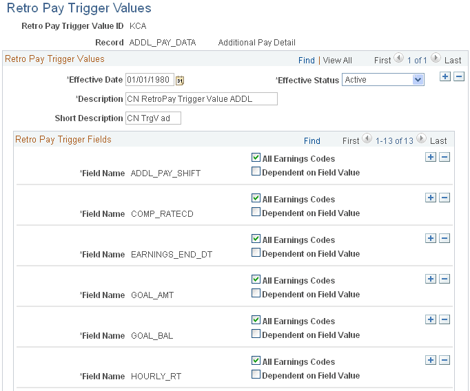

Retro Pay Trigger Values Page
Use the Retro Pay Trigger Values page (RETRO_TRG_VALUES) to define a set of field changes that trigger retro requests. Each set can include fields from either the job record or the additional pay records.
Navigation:
Set Up HCM, and then Product Related, and then Payroll for North America, and then Retroactive Payroll, and then Retro Pay Trigger Values, and then Retro Pay Trigger Values
This example illustrates the fields and controls on the Retro Pay Trigger Values page: JOB record.
This example illustrates the fields and controls on the Retro Pay Trigger Values page: ADDL_PAY_DATA record.
Field or Control Description
This ID identifies the set of retro pay trigger values when you associate it with a retro pay trigger program.
Record
JOB and ADDL_PAY_DATA are the only supported records for trigger values.
Retro Pay Trigger Fields
Field Name
Select one of the fields that the system is monitoring for changes. These are the fields that appear on the Retro Pay Monitored Fields page for the selected record.
When you select a value, the Field Name field immediately becomes read-only. To change the value, you must delete the row and add a new one.
Earnings Code and All Earnings Codes
Note: These fields appear only for the ADDL_PAY_DATA record.
Use these fields to choose which additional pay earnings codes produce retro requests when the selected field changes.
To create retro requests for all retro-eligible earnings codes, select the All Earnings Codes check box. The system hides the Earnings Code field when the check box is selected.
To create retro requests for a single earnings code, deselect the check box and enter a value in the Earnings Code field.
To create retro requests for some, but not all, earnings codes, you can create multiple rows of data for the same field and enter different earnings codes for each row.
Earnings code processing relies on the use of certain delivered codes that populate the Earnings Code field when you do not explicitly select a code. For JOB fields, the system uses the $NA (not applicable) earnings code, and for ADDL_PAY_DATA fields that affect all earnings codes, the system uses the $AC (all codes) earnings code. Therefore, it is critical that you do not modify, remove, or inactivate these two delivered earnings codes.
Dependent on Field Value
To create a retro request for any change to the selected field, leave this check box deselected.
To create a retro request only when the field changes to one or more specific values, select this check box and enter the values in the Field Values grid that appears.
Field Values
Set ID
If the selected field is setID-controlled, you must enter a setID before you can select specific values.
If the selected field is not setID-controlled, this field is not editable.
<Field Type> Value
Enter the values that create retro requests. For example, in the JOB record, you might create retro requests for certain employee status changes to Active or Leave of Absence, but not when it changes to any other value.
Depending on the field type, the label for the field value column is Character Value, Numeric Value, or Date Value.
