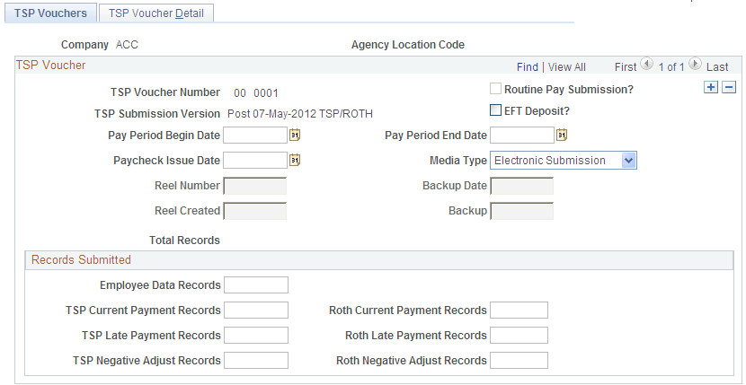

TSP Vouchers Page
(USF) Use the TSP Vouchers (Thrift Savings Plan vouchers) page (GVT_TSP_VCH_TBL) to define the header information for a TSP voucher file or to print a cancelled TSP voucher.
Navigation:
Payroll for North America, and then Payroll Distribution, and then Additional Integrations USF, and then Identify TSP Voucher, and then TSP Vouchers
This example illustrates the fields and controls on the TSP Vouchers page.
TSP Vouchers page
The TSP Vouchers page becomes display only after the TSP Interface process has completed.
Field or Control Description
TSP Voucher Number (Thrift Savings Plan voucher number)
The system issues and tracks TSP voucher numbers. The first 2 digits indicate the year, which is from the Agency table. The remaining 4 digits are the voucher sequence number in that year. The system automatically increments the voucher sequence for each row that you add.
Note: You must update the Agency table each year to restart the TSP voucher number sequence.
Routine Pay Submission?
This check box is for system use only. The TSP Interface process selects this check box when you process a voucher for a regular, on-cycle payroll.
EFT Deposit? (electronic file transmission deposit)
This is for your information only.
Reel Number and Date Reel Created
Enter the reel number and date that are provided by the Thrift Savings Board.
Backup and Backup Date
The Thrift Savings Board provides this information.
Total Records
The TSP Interface process provides this number.
Records Submitted
For on-cycle TSP vouchers, the system generates and displays the count for each of the TSP and ROTH categories in this group box. For all other TSP vouchers, you must enter each amount.
