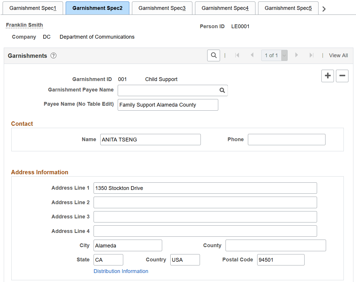

Garnishment Spec2 Page
(USF) Use the Garnishment Spec2 (garnishment specification 2) page (GVT_GARNISH_SPEC2) to enter garnishment order information.
Navigation:
Payroll for North America, and then Employee Pay Data USF, and then Deductions, and then Create Garnishments, and then Garnishment Spec2
This example illustrates the fields and controls on the Garnishment Spec2 page.
Field or Control Description
Payee Name (No Table Edit)
Enter a payee's name that is not from an existing table.
Distribution Information
Select this link to access the Deduction Distribution Information page where you enter distribution information for this garnishment.

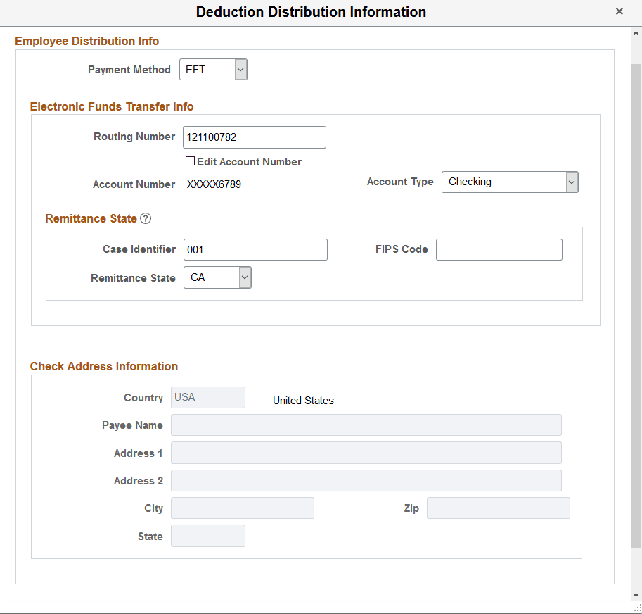

Deduction Distribution Information Page
(USF) Use the Deduction Distribution Information page (GVT_GARN_SPEC2_SEC) to enter the payee's garnishment deduction distribution information.
Navigation:
Select the Distribution Information link on the Garnishment Spec2 page.
This example illustrates the fields and controls on the Deduction Distribution Information page (USF).
Payment Method
Values are:
Check
EFT
None
Electronic Funds Transfer Info
Enter the electronic funds transfer and remittance state information. This section becomes editable when the selected payment method is EFT.
All fields are required in this section.
Edit Account Number
Select to update the bank account number. This field appears when the encryption process has been run and the account number previously existed. When selected, the existing read-only account number is cleared from the field for you to enter a new one.
Account Number
Enter the bank account number.
If data encryption is enabled and the encryption process is run for the GVT_GARN_SPEC record, the account number is encrypted in the database if it belongs to a country that is specified on the Application Fundamentals: Define Country for Encryption Page. Also, the account number appears as masked on this page. An exception to this is when the user is assigned the Bank Account Admin role, and this role is defined on the Application Fundamentals: Grant Unmasked Access Page for the GVT_GARN_SPEC record. In this case, the user sees the unmasked account number.
Check Address Information
Enter the check address information. This section becomes editable when the selected payment method is Check or None.
All fields are required in this section for the Check payment method, except the Address 2 field.
