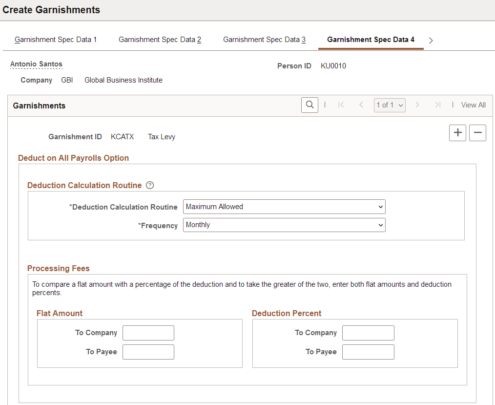

When deducting from all payrolls, define deduction defaults and processing fee defaults.
Before using this page, select Deduct on All Payrolls in the Deduction Schedule field on the Garnishment Spec Data 3 page.

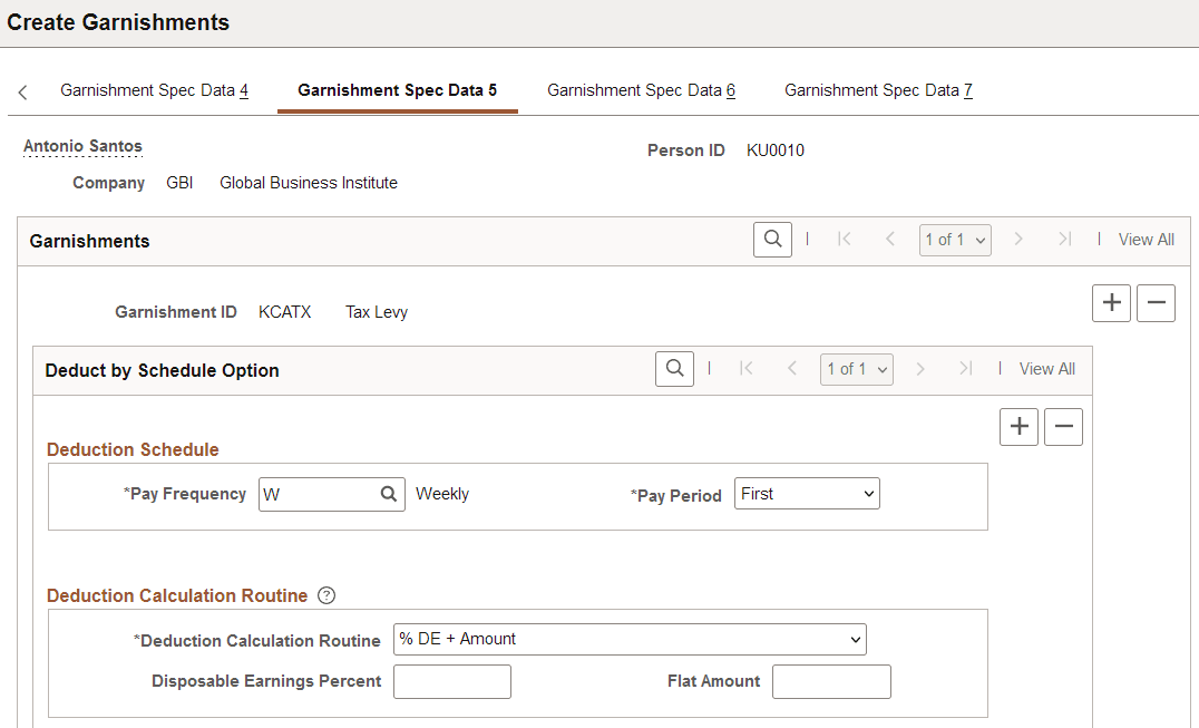

Define the payment schedule for the garnishment and define deduction defaults and processing fee defaults.
Before using this page, select Deduct by Schedule in the Deduction Schedule field on the Garnishment Spec Data 3 page.

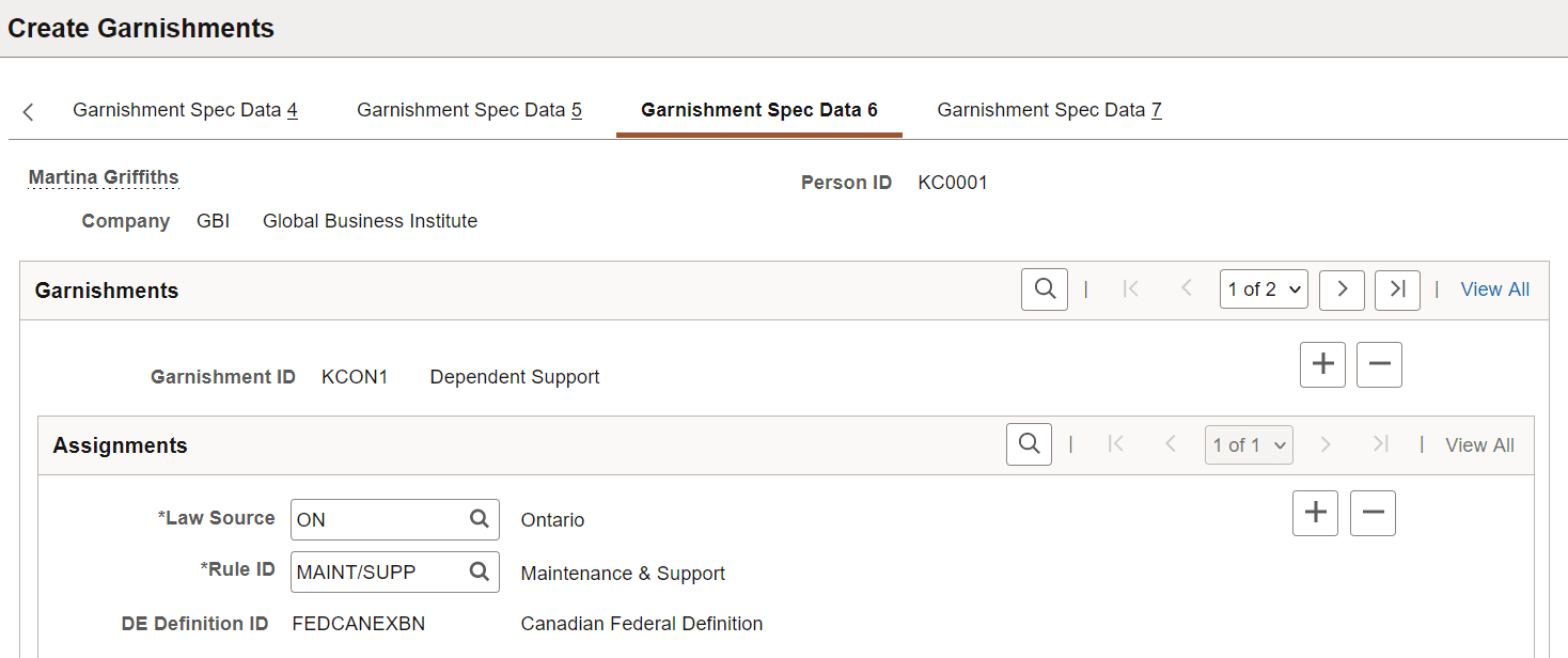

(CAN) Garnishment Spec Data 6 Page (garnishment specification data 6)
GARNISH_SPEC6_CN
(CAN) Specify the garnishment rule and enter employee-level exemption and deduction overrides.

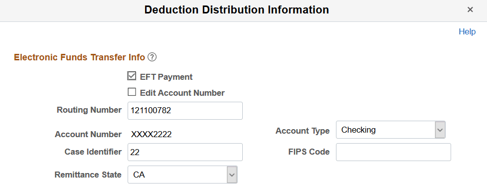

Deduction Distribution Information Page
GARN_SPEC2_SEC
Enter EFT information for child support garnishments.

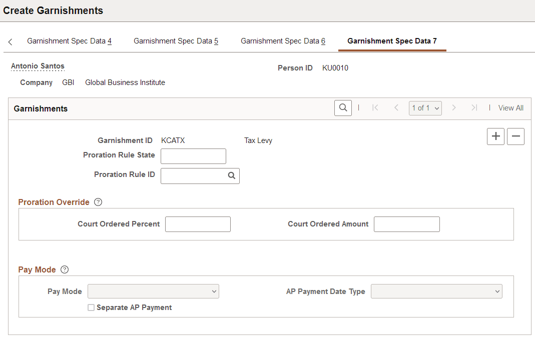

(USA) Enter proration overrides if the proration rule is either CRTORD or CRTDET, and to specify the pay mode for integration with PeopleSoft Payables.
Garnishment Spec Data 7 Page (garnishment specification data 7)
GARNISH_SPEC7_CN
(CAN) Specify the pay mode for integration with PeopleSoft Payables.

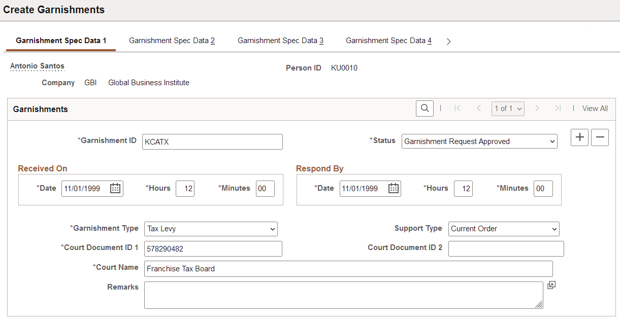

Garnishment Spec Data 1 Page
Use the Garnishment Spec Data 1 (garnishment specification data 1) page (GARNISH_SPEC1 or GARNISH_SPEC1_CN) to enter garnishment order information.
Navigation:
  • Payroll for North America, and then Employee Pay Data USA, and then Deductions, and then Create Garnishments, and then Garnishment Spec Data 1
  • Payroll for North America, and then Employee Pay Data CAN, and then Deductions, and then Create Garnishments, and then Garnishment Spec Data 1
This example illustrates the fields and controls on the Garnishment Spec Data 1 page.
Field or Control Description
Garnishment ID
In general, define only one garnishment specification for each garnishment order that you receive for an employee. Each garnishment specification must have a unique garnish ID.
See Splitting Garnishment Orders.
Note: Never reuse the same garnishment ID for an employee because the system calculates garnishment balances across all CY balance years for the combination of employee ID and garnishment ID.
Status
Update this field as the status changes throughout the life of the garnishment. This is important because it affects the payroll processing of the garnishment deduction.
If you select Garnishment Request Received or Garnishment Request Approved, the system processes the garnishment when you run the Pay Calculation COBOL SQL process (PSPPYRUN). If you select Garnishment Deduct Completed, Garnishment Deduct Suspended, Garnishment Request Cancelled, Garnishment Request Rejected, or Garnishment Request Released, the system ignores the garnishment during the Pay Calculation process.
Garnishment Deduct Completed: Select this value when the garnishment is paid in full. The system automatically selects this status during pay confirmation processing when the garnishment reaches its limit or stop date.
Note: If you run the Pay Unconfirm COBOL SQL process (PSPUNCNF) after confirming a payroll in which the system set the garnishment status to Garnishment Deduct Completed, the unconfirm does not reset the garnishment status. You must keep this in mind and reset the status if you unconfirm the payroll.
Garnishment Deduct Suspended: Select this value to stop the garnishment deduction in payroll while preserving the garnishment specification data.
Garnishment Request Approved: Select this value when you inform the court, authorized agency, or government agency that you will comply with the garnishment or levy.
Garnishment Request Cancelled: Select this status if the garnishment order is cancelled by the issuing agency, such as the U.S. Department of Education for Student Financial Assistance.
Garnishment Request Received: Select this value when you establish a new Garnishment record, or to define an off-cycle entry for the employee to test the garnishment deduction before you put it into production.
Garnishment Request Rejected: Select this value if you cannot comply with the garnishment or levy. For example, if you have terminated the employee and there are no wages to garnish, you can reject the garnishment.
Garnishment Request Released: Select this status if the garnishment order is released by the issuing agency, such as the IRS (internal revenue service).
Garnishment Request Terminated: Select this status if the garnishment order is terminated by the issuing agency, such as the California Franchise Tax Board.
(CAN) Deduction Code
This field is visible for Canada only. Select a valid before-tax or after-tax garnishment deduction code.
If you select a before-tax deduction code:
  • The following warning appears: Before-tax garnishment requires separate general deduction(s) for Company and Payee Fees.
  • The fields that are associated with the processing of garnishment fees (on the Garnishment Spec Data 3, 4, and 5 pages) become unavailable for entry.
Because the system must process company and payee fees that are associated with garnishments as after-tax deductions, you must define them separately as general deductions. When defining these general deductions, deselect the Garnishment Process indicator in the Deduction table.
Received On
Enter the date and time that you received the writ of garnishment or tax levy from the court, authorized agency, or government agency.
Respond By
Enter the date and time by which you must tell the court, authorized agency, or government agency whether you can comply with the garnishment order. For example, if the employee is no longer employed, you cannot garnish wages.
Garnishment Type
Select the type of garnishment or levy:
Writ of Garnishment: Typical garnishment type for failure to pay.
Tax Levy: Failure to pay taxes.
Chapter 13 Bankruptcy: Bankruptcy in Canada, or topic 13 bankruptcy in the U.S.
Wage Assignment: Similar to a writ, signifying a failure to pay.
Social Security (AWG): Social Security Administrative Wage Assignments.
Child Support, Spousal Support, and Dependent Support: Typically ordered by a family court. (USA) If you select one of these types, also select a value in the Garnishment Support Type field.
Student Loan Repayment: The garnishment type for delinquent student loans.
(USA) Support Type
Applies only for child support, dependent support, and spousal support garnishment types. For these garnishment types, select Current or Arrears.
Court Name
Enter the name of the court, authorized agency, or government agency that has legal jurisdiction over the garnishment.
Court Document ID 1 and Court Document ID 2
Enter any codes with which you identify the garnishment documents from the court or reports that you send back to the court or government agency. For example, garnishment documents might carry a file or case number, but a tax levy usually uses a date and the employee's social security number or social insurance number.

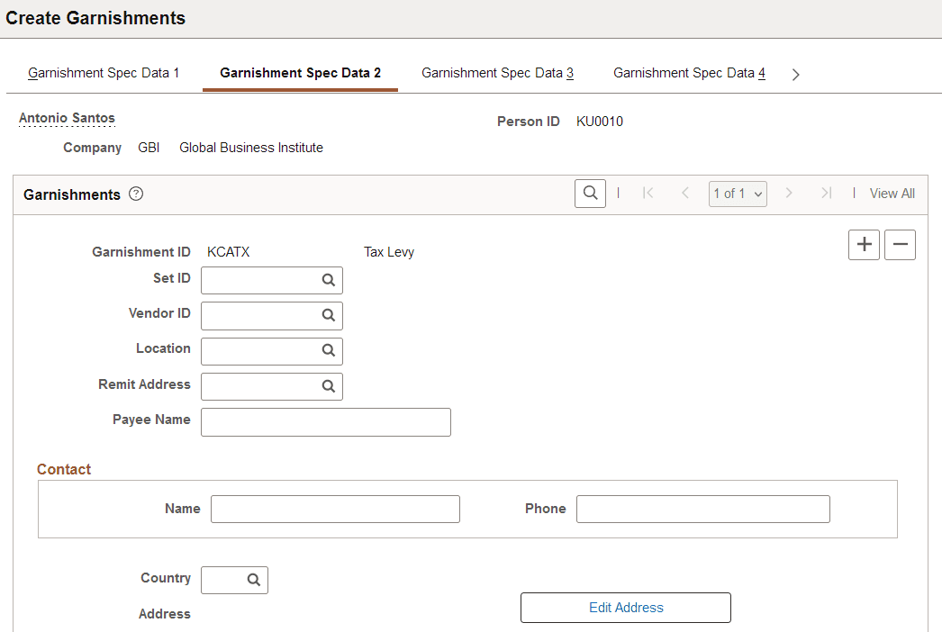

Garnishment Spec Data 2 Page
Use the Garnishment Spec Data 2 (garnishment specification data 2) page (GARNISH_SPEC2) to enter garnishment payee and address information.
Navigation:
  • Payroll for North America, and then Employee Pay Data USA, and then Deductions, and then Create Garnishments, and then Garnishment Spec Data 2
  • Payroll for North America, and then Employee Pay Data CAN, and then Deductions, and then Create Garnishments, and then Garnishment Spec Data 2
This example illustrates the fields and controls on the Garnishment Spec Data 2 page.
(USF) These instructions do not apply to U.S. federal government employers.
See Garnishment Spec2 Page.
To process payments through the Payables interface, you must enter a setID, vendor ID, vendor location, and remit address. You should maintain vendor addresses on the Vendor table in the Payables database.
Vendor ID
(USA) This field must be blank if you're processing the garnishment as an EFT payment. Otherwise, select the vendor ID of the garnishment payee.
Location
If you selected a vendor ID, select the specific location for this garnishment from among the locations set up for the payee on the Vendor table.
Remit Address (remittance address)
If you selected a location, select the address sequence number that represents the garnishment remittance address in the Vendor table.
When you enter the setID, vendor ID, location, and remit address number, the page displays the complete address.
Edit Address
If you're using the EFT process, you can enter the country in the Country field and select Edit Address to enter address data for information purposes only.
If you're using the Payables interface, you should make all address updates in the Vendor table.
See Maintaining Vendor Information.

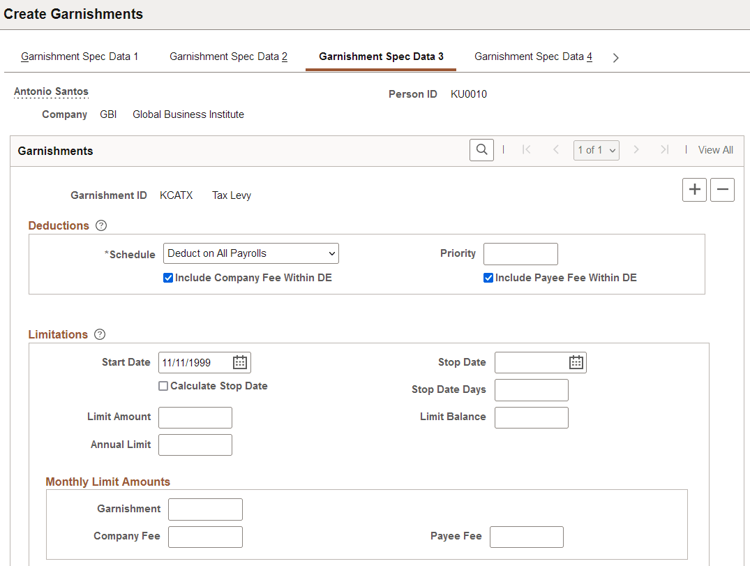

Garnishment Spec Data 3 Page
Use the Garnishment Spec Data 3 (garnishment specification data 3) page (GARNISH_SPEC3) to select a deduction schedule and enter limit information.
Navigation:
  • Payroll for North America, and then Employee Pay Data USA, and then Deductions, and then Create Garnishments, and then Garnishment Spec Data 3
  • Payroll for North America, and then Employee Pay Data CAN, and then Deductions, and then Create Garnishments, and then Garnishment Spec Data 3
This example illustrates the fields and controls on the Garnishment Spec Data 3 page.
Deductions
Schedule
Specify how to deduct garnishments:
Deduct on All Payrolls: If you select this value, use the Garnishment Spec Data 4 page to complete the deduction information.
Deduct by Schedule: If you select this value, use the Garnishment Spec Data 5 page to create the deduction schedule and complete the deduction information.
Priority
Select the processing priority of the garnishment in relation to other garnishments for the employee. This is not the same as the deduction priority in the General Deduction table. The system uses this value to process garnishments to which proration rules do not apply.
If you leave this field blank, or assign the same priority number to more than one garnishment specification, the system determines the processing priority by garnish ID. The lower the number, the higher the priority. For example, 100 is a higher priority than 200.
Include Company Fee Within DE (include company fee within disposable earnings) and Include Payee Fee Within DE (include payee fee within disposable earnings)
Select the check boxes to deduct fees from the employee's disposable earnings before taking garnishment deductions.
Payroll for North America provides a garnishment proration option for states that permit proration of garnishments when an employee has more than one of the same type. If you use this option, the system uses the value in the Priority field only for garnishments to which proration does not apply.
Limitations
The fields in this group box impose time and amount restrictions on the garnishment deduction. This functionality is useful when you handle multiple garnishment orders from states where regulations prohibit the collection of more than one garnishment order at a time, or where they impose time limits on the collection of a garnishment.
Start Date
To start the garnishment deduction immediately, leave this field blank.
Stop Date
Leave the Stop Date field blank if you want the garnishment deduction to go on until the garnishment is satisfied. Otherwise, enter the date the deduction should stop. This date must be greater than the check date for a pay period to withhold the garnishment for that pay period. For example, if the pay period has an end date of March 10, 2000 and a check date of March 12, 2000, then the garnishment stop date must be greater than March 12, 2000 to withhold the garnishment in the March 10, 2000 pay period.
Calculate Stop Date or Stop Date Days
Select this check box to have the system calculate a stop date when you don't know the exact stop date. For example, Tennessee currently has a rule for garnishments of the Writ type, specifying a term of 90 days. In other words, you can only garnish money for 90 days. The 90-day term does not begin until you actually begin taking money from the employee (that is, until the employee has money available to garnish). For example, you might receive a garnishment order on September 1. If the employee has another garnishment of a higher priority, there might be no money available to garnish until November.
In this situation, you cannot enter a stop date because you don't know what the exact start date is. Instead, select the Calculate Stop Date check box and enter the length of the garnishment term (90 for Tennessee) in the Stop Date Days field. As soon as the system can take money for this garnishment, it:
  1. Calculates the stop date by adding 90 days to the processing date of the current pay period.
  2. Enters that date in the Stop Date field.
  3. Deselects the Calculate Stop Date check box.
From this point on, the system takes the garnishment until the end of the term, or until other limits are satisfied.
Limit Amount
Enter a limit amount to establish a maximum total amount for the garnishment deduction. Each time you run the Pay Confirmation COBOL SQL process (PSPCNFRM), the system updates the limit balance, displaying how much of the garnishment has been paid to date. When the limit balance equals the limit amount, the system automatically stops taking the deduction. To not set a limit, leave the limit amount blank.
Limit Balance
This field does not automatically reflect adjustments that you make to garnishment balances. If you make an online balance adjustment to garnishments, make the same update in this field.
Calculations for limit processing use the value displayed in the YTD Garnishment Balance (year-to-date garnishment balance) field on the Garnishment Balances page. Update the Limit Balance field with that value after making any adjustments to garnishment balances.
See Understanding Garnishment Limit Processing.
Annual Limit
Enter the annual limit amount, if you want to limit the garnishment deductions to a specified amount per year.
Monthly Limit Amounts
Use the fields in this group box to enter monthly limits imposed by the court on the garnishment amount, company fee, or payee fee.
Your company or the payee might charge voucher fees, which are handling fees related to garnishments. Enter the fees owed to your company or to the payee in the Processing Fees Defaults group box on the Garnishment Spec Data 4 page or Garnishment Spec Data 5 page, depending on which deduction option you use.

Use the Garnishment Spec Data 4 (garnishment specification data 4) page (GARNISH_SPEC4) when deducting from all payrolls, to define deduction defaults and processing fee defaults.
Before using this page, select the Deduct on All Payrolls in the Deduction Schedule field on the Garnishment Spec Data 3 page.
Navigation:
  • Payroll for North America, and then Employee Pay Data USA, and then Deductions, and then Create Garnishments, and then Garnishment Spec Data 4
  • Payroll for North America, and then Employee Pay Data CAN, and then Deductions, and then Create Garnishments, and then Garnishment Spec Data 4
This example illustrates the fields and controls on the Garnishment Spec Data 4 page.
Deduction Calculation Routine
Select Maximum to calculate:
Deduction = disposable earnings − exemptions
The system takes all it can get. Use for garnishments such as tax levy and bankruptcy.
Note: If you select this option, the DE Percent and Flat Amount options become unavailable for entry and the system deletes any data existing there.
Frequency
If you specify a flat amount, enter a deduction frequency. The system uses this frequency to adjust the flat amount to the employee's pay frequency to calculate the deduction amount per pay period.
See Common Elements Used in Specifying Employee Garnishment Data.
Processing Fees
Based on the details of the court order, enter processing fees consisting of a percentage of the deduction or a flat amount to be paid to the company or to the payee. On the Garnishment Spec Data 2 page, you specified whether to include the company and payee fees in the employee's disposable earnings.
Some garnishment orders might require that you compare a flat amount with a percentage of the deduction and take the greater of the two. In that case, enter both, and the system automatically takes the greater amount.
If there are company fees, be sure that a General Ledger account for the fees has been established on the General Ledger Liability Accts page in the Company component.

This example illustrates the fields and controls on the Garnishment Spec Data 5 page (1 of 2).
This example illustrates the fields and controls on the Garnishment Spec Data 5 page (2 of 2).

Specifying Different Garnishment Amounts in Different Pay Periods
Suppose you receive a garnishment order for an employee who you pay weekly. The order specifies that you garnish 150 USD in the first pay period of the month, 200 USD in the second, 250 USD in the third, 200 USD in the fourth, and nothing in the fifth (for those months that have five pay periods). To set this up:
  1. Enter a pay frequency of Weekly and a pay period of First to define what to deduct in the first weekly pay period.
  2. In the Deduction Calculation Routine group box, select the %DE + Amount option and enter a flat amount of 150.00 USD. Leave the DE Percent field blank.
  3. Insert a row for the second pay period.
  4. Select a pay period of Second and enter a flat amount of 200.00 USD.
  5. Repeat these steps for the remaining pay periods.

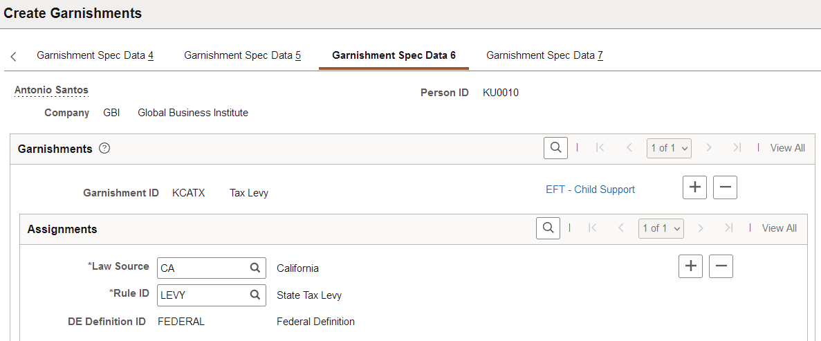

(USA) Garnishment Spec Data 6 Page
(USA) Use the Garnishment Spec Data 6 (garnishment specification data 6) page (GARNISH_SPEC6) to specify the garnishment rule and enter employee-level exemption and deduction overrides.
Navigation:
Payroll for North America, and then Employee Pay Data USA, and then Deductions, and then Create Garnishments, and then Garnishment Spec Data 6
This example illustrates the fields and controls on the (USA) Garnishment Spec Data 6 page (1 of 2).
This example illustrates the fields and controls on the (USA) Garnishment Spec Data 6 page (2 of 2).
EFT- Child Support (electronic file transfer – child support)
Select this link to access the Deduction Distribution Information Page, where you can enter the necessary information to process a child support garnishment as an electronic file transfer (EFT).
Assignments
Law Source and Rule ID
Select the jurisdictional entity (garnish law source) and unique rule ID for the garnishment rule that you are applying.
This information is maintained in the Garnishment Rules table.
You can enter multiple garnish law sources and rule IDs for each employee. Typically, you enter the federal code ($U), then insert a row for each applicable state.
When an employee has more than one garnishment in a single state, the system determines proration rules based on the garnish law source. If multiple garnishments of the same type are received from different states, enter the state where the employee works for all of the garnishments.
For proration rules CRTORD and CRTDET, the courts supply amounts or percents for prorating garnishments. For multiple garnishments with either of these proration rules, enter the court-ordered proration amount or percent on the Garnishment Spec Data 7 page.

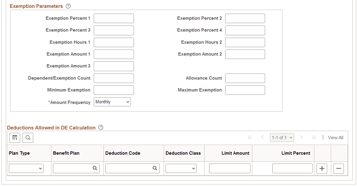

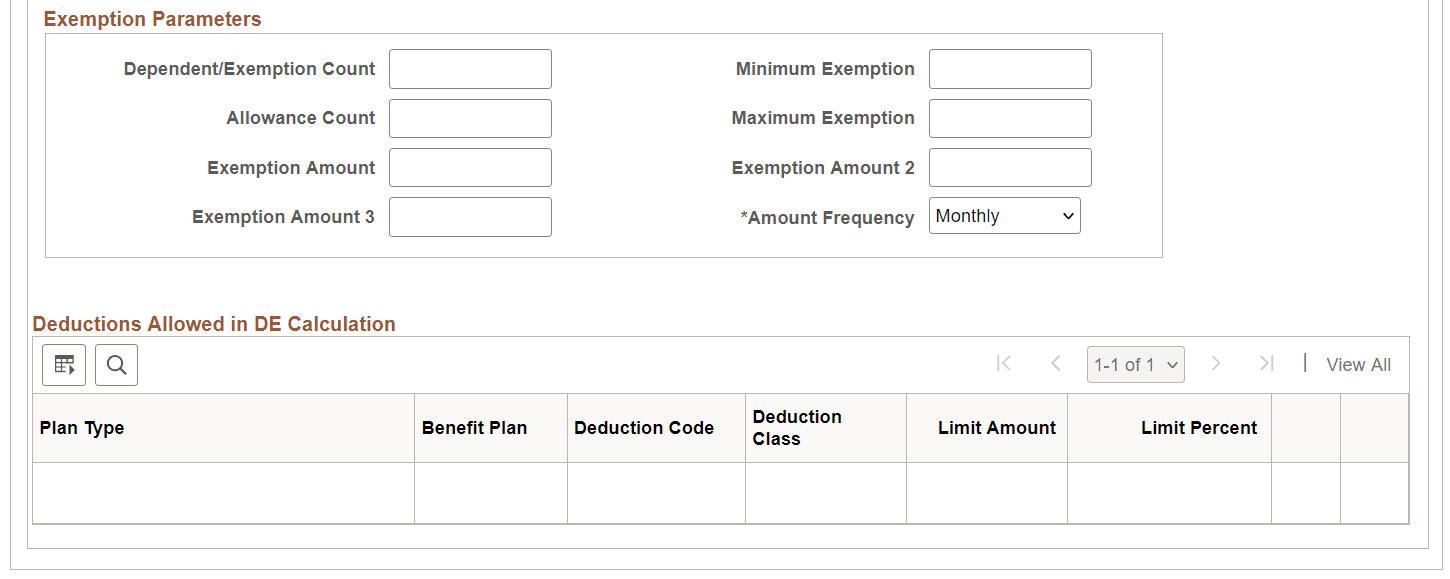

Exemption Parameters
If you must override the values for the exemption percent, amount, hours, or minimum and maximum that are already established in the calculation formula for the garnishment rule, enter the override values here for the corresponding variables.
If you enter an exemption override, you might also have to change the value in the Amount Frequency field; the system uses this amount frequency to calculate the disposable earnings. The default is Monthly.
To ensure that you enter values in the correct fields, we recommend that you review the calculation formula for the rule. The system ignores values that you enter here for exemption variables that are not already included in the garnishment rule's calculation formula.
See Exemption Variables Page.
Dependent/Exemption Count
Enter the number of dependents or exemptions claimed by the employee.
Allowance Count
Enter the number of allowances claimed by the employee.
Amount Frequency
If the court determines an exemption amount frequency (daily, weekly, or monthly) that differs from the frequency defined for the calculation rule, select the override frequency here.
Form 668–W Effective Year
This field appears on the page when the garnishment is a U.S. tax levy or Arizona tax levy. For these tax levies, the exemption amount is calculated using the year in which the levy was received unless the employee files a new Form 668-W with the employer. If the employee files a new Form 668-W, enter the year of the new Form 668-W here. The system calculates the exemption amount using the exemption values for the specified year.
Deductions Allowed in DE Calculation
For U.S. tax levies, the system populates this group box when you run the first payroll that includes the tax levy deduction. This identifies the deductions that were in place before the tax levy was received and that are included in the calculation of the disposable earnings for the levy. Deductions established for the employee after the levy was received are not included in the disposable earnings calculation and are deducted from the net pay remaining after the deduction of the tax levy.
For other garnishments, you can enter additional deductions for this garnishment to modify the disposable earnings definition used by the calculation rule.

(CAN) Use the Garnishment Spec Data 6 (garnishment specification data 6) page (GARNISH_SPEC6_CN) to specify the garnishment rule and enter employee-level exemption and deduction overrides.
Navigation:
Payroll for North America, and then Employee Pay Data CAN, and then Deductions, and then Create Garnishments, and then Garnishment Spec Data 6
This example illustrates the fields and controls on the Garnishment Spec Data 6 page (1 of 2).
(CAN) Garnishment Spec Data 6 page (1 of 2)
This example illustrates the fields and controls on the Garnishment Spec Data 6 page (2 of 2).
(CAN) Garnishment Spec Data 6 page (2 of 2)
Assignments
Select the jurisdictional entity (law source) and unique rule ID for the garnishment rule that you're applying. This information is maintained in the Garnishment Rules table.
You typically enter only the Law Source (province code or ZZ for federally supported rules).
You can use any rule if it applies to a garnishment situation, regardless of the original province designation (Garnish Law Source).
If you must override the values for the exemption amount, minimum and maximum, or frequency that are already established in the calculation formula for the garnishment rule, enter the override values here for the corresponding variables.
Allowance Count
Exemption Amount
Enter the exemption amount for the debtor.
Exemption Amount 2
Enter the exemption amount for the debtor’s first dependent.
Exemptions Amount 3
Enter the exemption amount for each of the debtor’s additional dependents.
The fields in this topic are not available for entry for users in Canada.

(USA) Use the Deduction Distribution Information page (GARN_SPEC2_SEC) to enter EFT information for child support garnishments.
Navigation:
Select the EFT - Child Support link on the (USA) Garnishment Spec Data 6 page.
This example illustrates the fields and controls on the Deduction Distribution Information page.
EFT Payment
Select this check box if the payment is processed as an EFT payment rather than a check through accounts payable. When selected, the remaining fields on the page are available for entry.
Note: The Vendor ID field on the Garnishment Spec Data 2 page must be blank if you process the payment as an EFT.
Edit Account Number
Select to update the account number. This field appears when the encryption process is run and the account number currently displayed belongs to a country that is specified on the Application Fundamentals: Define Country for Encryption Page. When selected, the existing read-only number is cleared from the field for you to enter a new one.
Routing Number
Enter the bank ID of the distribution bank source used for processing the payments, as specified on the Bank table.
Account Number
Enter the account number of the distribution bank source used for processing the payments.
If data encryption is enabled and the encryption process is run for the GARN_SPEC record, the account number is encrypted in the database if it belongs to a country that is specified on the Application Fundamentals: Define Country for Encryption Page. Also, the account number appears as masked on this page. An exception to this is when the user is assigned the Bank Account Admin role, and this role is defined on the Application Fundamentals: Grant Unmasked Access Page for the GARN_SPEC record. In this case, the user sees the unmasked account number.
See Also Application Fundamentals: Understanding Data Encryption for Payroll for North America.
Account Type
Select either the Savings or Checking account type. Illinois accepts only the Checking account type.
Case Identifier
Enter the case number provided by the court.
FIPS Code (Federal Information Process Standard code)
Enter the 5-digit numeric state (first 2 digits) and county (last 3 digits) code of the state disbursement unit (SDU) receiving the transfer.
This code is required for Illinois and Massachusetts. Enter the state and county code of the state disbursement unit (SDU) receiving the transfer.
Illinois and Massachusetts require the FIPS code. (MA FIPS code must = 25000; IL FIPS code must = 17xxx.) For the remaining states, a FIPS code may also be required. Refer to the EFT requirements for the applicable state.
Remittance State
Select the SDU that receives the distribution and sends the payment to the recipient. Only states that accept EFT payment are available for selection.

This example illustrates the fields and controls on the Garnishment Spec Data 7 page.
(USA) Proration Override
If the proration rule of the garnish law state is either CRTORD or CRTDET and the court specified a proration amount or percent:
  1. Enter the state code and select the valid proration rule ID that applies to the garnishment.
  2. Enter the percent or amount of override in the respective field.
Pay Mode
Use this group box to interface with PeopleSoft Payables.
Pay Mode
Specify how Payables makes the garnishment payment:
Pay as Deducted: Select this value to pay the vendor each time Payroll for North America calculates this deduction.
Pay at Specified Date: Select this value to pay the vendor on a date that you specify in the AP Payment Date Type field.
Pay when Bond Price met: This value does not apply to garnishment processing.
Pay when Collection Completed: Select this value to pay the vendor only when you reach the goal amount or deduction end date. (This pay mode is valid for general deductions and garnishments).
AP Payment Date Type (accounts payable payment date type)
Specify which type of date to use when creating the accounts payable voucher. This field becomes available when you select Pay at Specified Date in the Pay Mode field.
Separate AP Payment (separate accounts payable payment)
Select this check box if the payment for this garnishment should be on a separate check when Payables makes the payment.
Note: The system selects this option automatically if it is not already selected and the employee has multiple garnishments for the same vendor with different vendor location and/or remit address. This ensures that an employee's garnishments for the same vendor with different locations and/or remit addresses are paid on separate invoices/vouchers and sent to the correct addresses.
