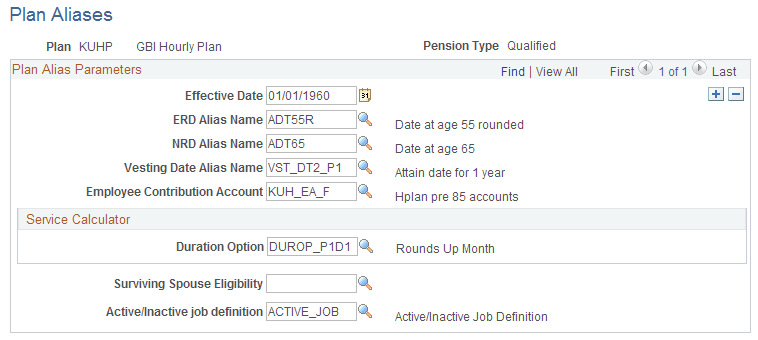

Plan Aliases Page
Use the Plan Aliases page (PA_PLAN_ALIASES) to specify aliases for miscellaneous plan data.
Navigation:
Set Up HCM, and then Product Related, and then Pension, and then Pension Plan Implementation, and then Plan Aliases, and then Plan Aliases
This example illustrates the fields and controls on the Plan Aliases page.
Plan Aliases page
Plan Alias Parameters
Field or Control Description
ERD Alias Name and NRD Alias Name
Enter date aliases to specify the plan's ERD and NRD.
Vesting Date Alias Name
Periodic processing resolves this alias during each run. You can then look up this date on the Plan Information page (under Pension, and then Pension Information, and then Review Plan History).
You cannot use the vesting function to determine the vesting date; you have to set up an independent date alias that figures out the vesting date. For example, if you use five year cliff vesting, you could set up a date alias that adds five years to the date of hire. However, this does not account for leaves of absence or other interruptions in service.
Employee Contribution Account
Enter the name of the employee contribution account that provides final balance information for the payment summary record. This is an employee accounts function result.
Service Calculator
Duration Options
Specify the duration option for the service calculator to use.
Surviving Spouse Eligibility
Enter the name of the eligibility statement.
Note: If you have set up an automatic benefit, you must specify a surviving spouse eligibility statement. If there are no eligibility conditions other than being married, set up a statement that is always true for married participants—for example: if marital status = married.
