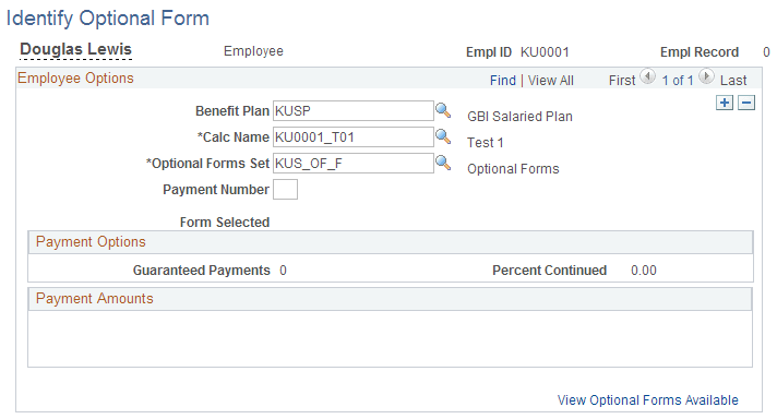

This example illustrates the fields and controls on the Identify Optional Form page as it first appears. When the page is in this initial mode, it displays only the fields that you use to identify a set of optional forms. After you click the View Optional Forms Available link, these fields disappear and the page instead displays information about the payment options in the selected set of optional forms.
Identify Optional Form page: choosing an optional forms set

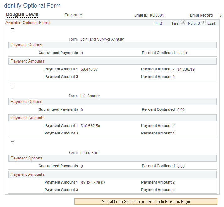

This example illustrates the fields and controls on the Identify Optional Form page as it appears after you click the View Optional Forms Available link. In this mode, the page displays information about specific payment options in the optional forms set.
Identify Optional Form page: choosing one payment option from the selected set of optional forms

When an employee's optional form of payment choices come from a system calculation, you can prompt for the same list of choices that the employee had. To do that, you fill in the fields in this group box, then click the View Optional Forms Available link.
Field or Control Description
Plan
Indicate the plan that was the basis for the employee's choice.
Calc Name (calculation name)
Indicate the calculation name that was the basis for the employee's choice.
Optional Forms Set
Indicate the optional forms set that was the basis for the employee's choice. This is necessary because a calculation can produce several different sets of values. For example, there may be forms sets based on early retirement and normal retirement. Contributory plans may also have separate form sets for the employee- and employer-paid portions of a benefit.
Payment Number
Enter a payment number. You use this number to distinguish among multiple payment streams, if necessary. If there is only a single payment stream, enter 1. If there are multiple streams, number them sequentially.
Form Selected and Payment Amounts
If you have not yet recorded an optional form of payment selection, the Form Selected field and the Payment Amounts group box are blank. After you record the optional form of payment selection, the page displays information about the selected form.
Click this link to see a scrolling list of the optional forms of payment. All other fields disappear.
Note: This option is only available in new rows. After you save an optional form selection, you cannot redisplay the choices without first deleting the row.
Available Optional Forms
Each form is identified by the form name, the percent continued for forms with a survivor benefit, and the guaranteed payments for term certain and certain and continuous forms.
<check box>
Select to identify the form of payment that an employee has chosen.
Accept Form Selection and Return to Previous Page
Click to copy the selected form to the previous page.
If there are multiple payment streams based on system calculations, be sure to set up optional form of payment selections for each stream. To do this, insert an additional row for the second payment stream.
The guaranteed payments are the number of years of guaranteed payments, not the actual number of payments.
Payment Amounts
For each form, you see the associated payment amounts, labeled Payment Amount 1 through Payment Amount 4. The type of payment in each field depends on the form. Payment Amount 1 is always the initial payment amount. For example, if the form is Joint and Survivor Annuity, Payment Amount 1 is the retiree amount and Payment Amount 2 is the survivor amount, while if the form is Level Income Option, the first amount is the pre-SSRA amount and the second amount is the post-SSRA amount.
Some forms may have zero amounts. These are forms that are offered by a plan, but are not available to a particular employee. These could include joint and survivor forms of payment for employees with no beneficiaries, level income options for employees older than the level income age, and any form of payment for an employee whose lump sum falls under the small benefit cashout threshold.
There are four types of retiree payments:
Retiree Payment Type Description
Retiree Amount
Amount due to the retiree. Except in the case of lump sums, this is normally a monthly amount payable until death.
Retiree Pre-SSRA Amount (retiree pre-social security retirement age amount)
Retiree Post-SSRA Amount
Under a level income option (LIO), the retiree's benefit is higher before the retiree reaches social security retirement age (SSRA), and is lower afterwards when the retiree has presumably started receiving social security benefit. Therefore, LIO forms produce two separate retiree amounts, identified as the pre- and post-SSRA amounts.
Pop Up Amount
Under a pop-up form of payment, the retiree amount increases if the beneficiary predeceases the retiree. The pop-up amount is this increased retiree amount.
There are four types of beneficiary payments:
Plan Beneficiary Amount
Amount payable to a spouse beneficiary on the retiree's death. This can come from two different sources: a joint and survivor form (or any form which includes a percent continued) elected by the retiree, and an automatic plan benefit for which there is no actuarial reduction.
Non-spouse Beneficiary Amount
Amount payable to a non-spouse beneficiary after the retiree's death under a joint and survivor form of payment.
Spouse Demonstration J&S (spouse demonstration joint and survivor)
If a married retiree selects a non-spouse beneficiary, the retiree's spouse is entitled to know the amount that would have been payable to the spouse had the retiree named the spouse as the beneficiary, instead of naming a non-spouse beneficiary. This is different from the non-spouse beneficiary amount because the actuarial adjustment is based on the spouse's age, rather than the non-spouse beneficiary's age. This type of payment is not actually available for payments; it is informational only.
Survivor Amount
In a last to survive form of payment, the amount due to the retiree or spouse after the other one has died.
