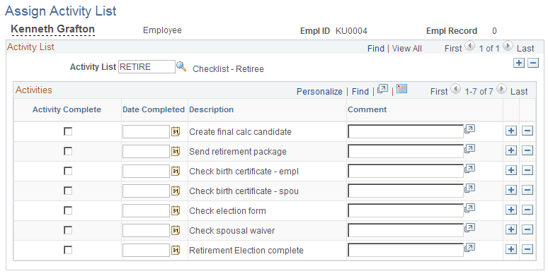

Assign Activity List Page
Use the Assign Activity List page (PA_RT_EMP_LIST) to set up a checklist for an employee's pension activity.
Navigation:
Pension, and then Pension Information, and then Assign Activity List, and then Assign Activity List
This example illustrates the fields and controls on the Assign Activity List page.
Field or Control Description
ID and Empl Record
You maintain an activity list using the ID and the record number (job record). This means that if, for example, a retiree has two retiree jobs, one for a salaried plan and one for a supplemental executive plan, you can establish activity lists under both. This enables you to track activities that must be performed for each plan—for example, recording the optional form selection and tax withholding elections.
Activity List
Select a list from the standard lists that your organization uses.
Note: You use the Define Activity Lists (PA_RT_ACTIVITY) page to create or modify an activity list.
Activity
An activity list includes a list of activities. When you select an activity list, all the activities that it includes appear.
Activity Complete
Select this check box for an activity when you complete the activity.
Date Completed
When you complete an activity, enter the completion date.
Comment
Use the Comment text box to record comments about an activity.
Your company may have separate activity list for tasks that are performed only once, regardless of the number of plans in which a payee participates. These are activities such as verifying birth dates and marriages. This way, you do not have to check off those activities for each plan. If your company uses such a list, always set it up for a payee under a default job—for example, the active employment record (Rcd#). This makes it easy to find, regardless of the number of plans from which a payee receives benefits.
